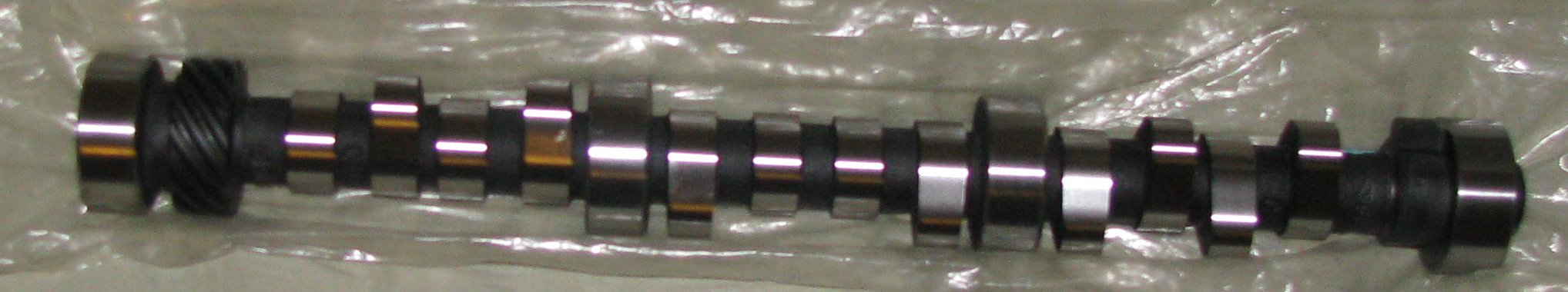

    That cam spec sheet is allowing for a 1.5 ratio rocker arm, thus the gross lift of .501
    Our engines using the stock rockers are 1.6 so the cam specs out at .534 gross lift.
    So you will need the 28986 springs.

    Got the cam/pushrods today. I attached the included spec sheet. it says it needs
    different springs, so just want to make sure the 26986 Valve Springs are what I need.
    Hopefully next week I can swing the headers and the tuner the following and get this
    thing done already.

  • asylummotorsports
    replied
    The 26915 may actually operate above .500 lift, and coil bind is certainly above that, but they aren't designed to operate at those levels.
    That is the key.
    So yes they may work, but you are outside the optimal operating range.
    As far as not using the recommended associated parts, you are once again compromising the parts as to how they were designed to work.
    They don't publish these numbers and recommendations for the good of their health.

  • RedBird
    replied
    ok so you read it right out of the store. Is that supposed to disprove what i said? Because trust me, what i said is true.
    i'm thinking that info is good for 3400's, but inaccurate for 3500's. Because like i said, me and dave are both full 3500, rev to 7k, both using those springs with stock LX9 seats, seals, keepers and retainers, i'm a bit over .500", and he's WAY over that, with no valve float. he's contacted the pistons with his valves before, but he's got a waaaay long duration cam, and his timing chain was stretched all to hell.
    Leave a comment:

    replied
    These Comp springs are designed for the LS1, and as such require the LS style seats and different seals to fit the 60V6 pushrod motors. These springs offer .500 max lift and a spring pressure of 136# @ 1.700" and 262# @ 1.300.
    Leave a comment:

    replied
    are you guys sure about the 26915's? i was under the impression that they were good to .560 or .600, seeing as how i'm running them on .506" lift, and Dave is running them on .539"/.549", and we both pull all the way to 7k. They also work with all the stock 3500 seats, seals, and hardware.
    i had LS6's and broke 2 of them in the 8 months i had them in the car, so i know they aren't any good past .500".
    Leave a comment:
  • IsaacHayes
    replied
    And the 26986 spring will work with that cam's ramp rate, because I have those springs and my cam has more duration than that cam listed there. So no worries there.

  • IsaacHayes
    replied
    Ok, that cam WILL work with the 26986 springs which work with stock hardware. Those are good for .6" lift
    The 26915 are only good for .5" lift.
    LS6 are only good for .51" lift.
    So you need the 26986 springs. I don't know what stock springs can take but I bet it's less than LS6 can for lift..
