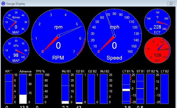

    took it for a 15 mile drive. Seems to run a little hot. on the HW it runs around 199 while in town it runs around 210-225.
    I haven't had a car in the summer nor a way to read exact numbers but my friends truck stays around 198-207F and so
    did the cobolt I rented. I'm just wondering if anyone has an idea on that or experienced the same without issue.
    The idle is a bit rough still. The mirrors shake a little and also when I shift in and out of gear it goes in and out a little rough
    and causes the engine to go down to about 500RPMS from the normal 650-700 range. Just wondering if that's normal
    with the inserts or just a transmission that has been out of commission for a while.
    I attached the guage on the VCM.
