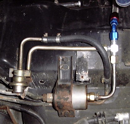

    I have a 16lb set which is in my 2.8L, I have a 19lb set that came with the 3100 fuel rail. I also have a set that came with the 3500. I am under severe cost constraints and can not afford to purchase a set of 24lb injectors to use with the 3100 fuel rail. I need a solution that is around $50. I believe I can get a suitable adjustable FPR for around that price. Joseph Upton has already proven a modified returnless system can be done. I have also talked with a very knowledgable person from the 3800SC camp that has converted returnless systems on a regular basis with no drawbacks whatsoever. It also allows me to use the stock components from the 3500 that I already have in my possession.
    Avoiding any changes that move backwards in technology is a good thing whenever possible. The newer the parts the better. The adjustable regulator is also an attribute and having the ability to attach an inexpensive pressure gauge to it is another plus if ever you have a starting problem and have to diagnose. It's not a complicated accomodation at all, you're basically attaching lines to the regulator instead of the rail and running one line instead of two to the engine.

            Those won't fit the fuel rail. I sell one that replaces the stock unit.
            I also have the AN fittings for a remotely mounted AFPR setup.

                          You had posted info on using the 19lb injectors in the 3500 Swap thread on the V6Z24 forum. Since my fuel rail was off a 2001 Malibu that had Multec 2 injectors, wouldn't the FPR be the 52~55 PSI type?
                          • #29
                            Yes it is. 2000+ are all 55psi regulators.
                            • #30
                              Seems like I have a 55 PSI FPR, so I'll go the modified returnless route. This will enable me to keep the 3500 fuel rail and injectors.
