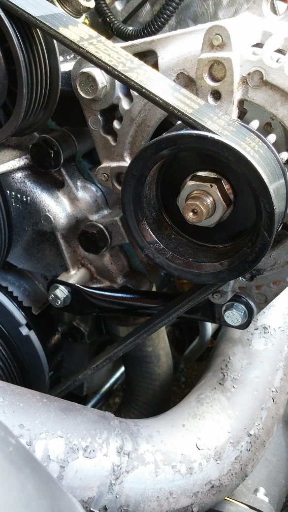

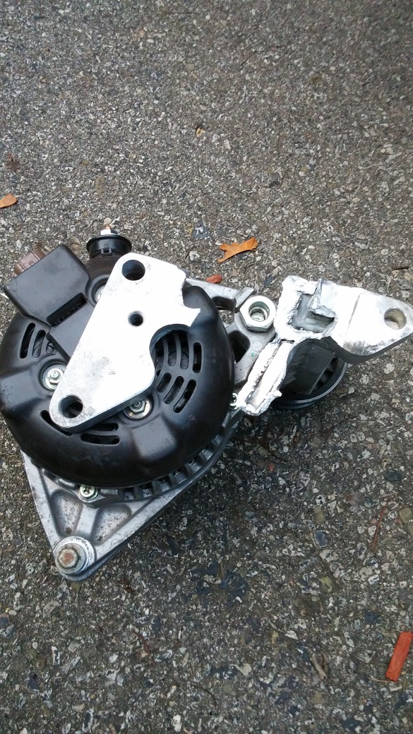

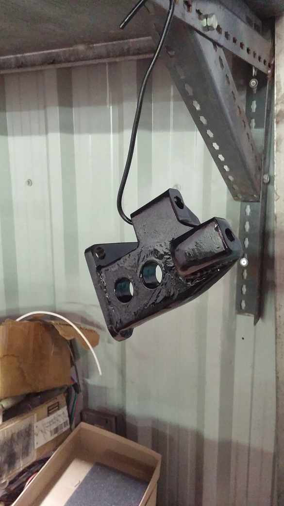

Alternator mount broke again, this time it broke the base plate completely in half.
I knew the material was too soft, once I welded it the first time, but I was hoping that the gussets and re-enforcing would have proven reliable. New alternator mount design is in the works.
Piktarz!
So this time the base plate broke in half:

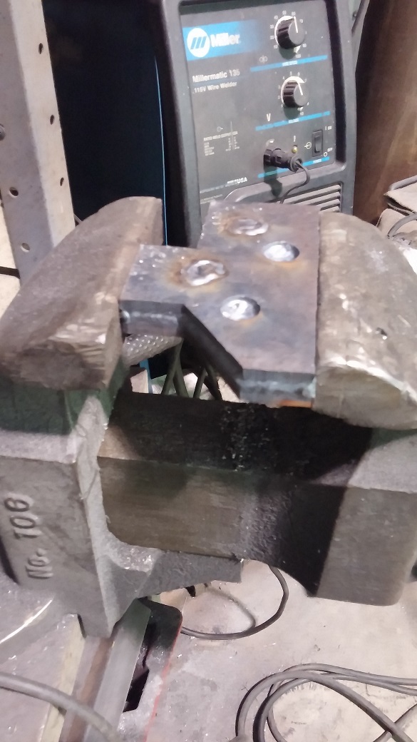

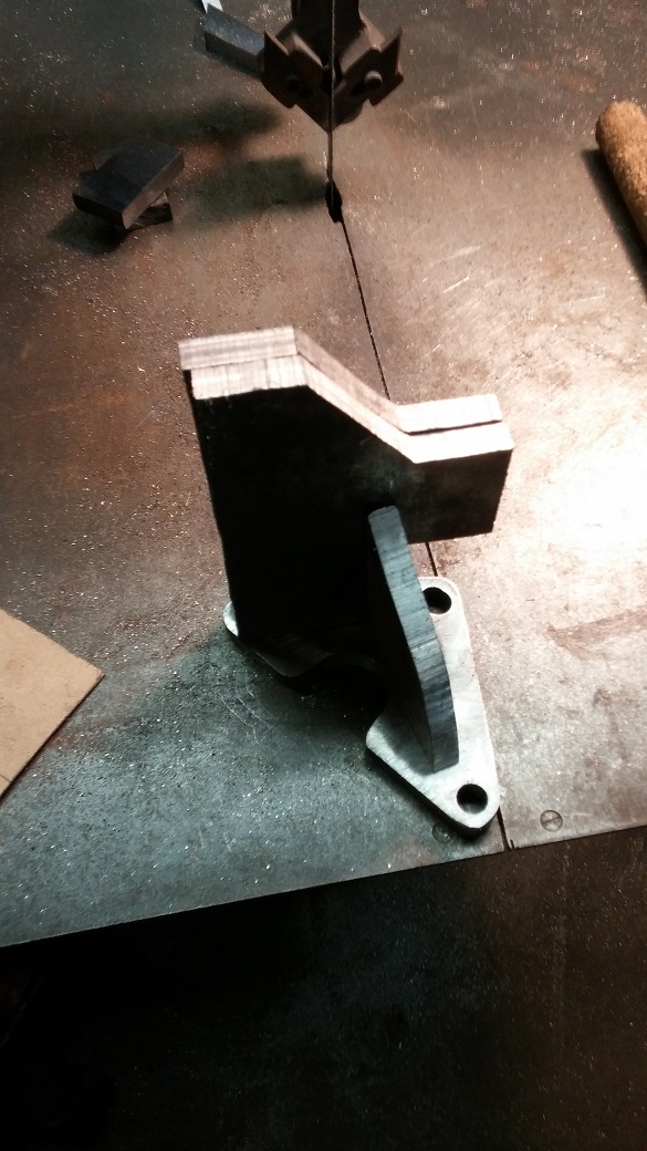

The New Mount
I started with a piece of 3/16" plate and made every part from it. I had to stack some pieces together to get the thickness I needed in certain areas.
Plug welded the main pieces together, along with edge welding

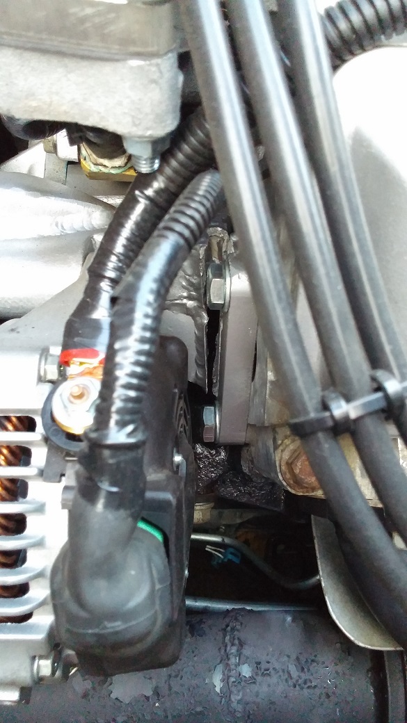

Test fitting in the car. I found that I had to add the extra portion on top like the old mount, so that the idler pulley would clear the water pump pulley with enough space that I was comfortable with.

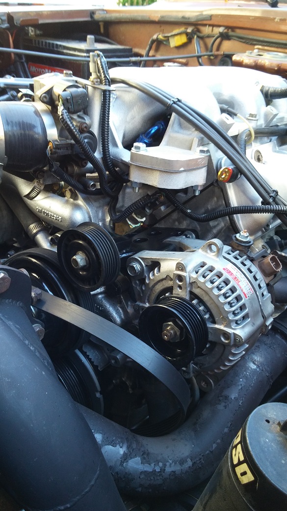

painted:

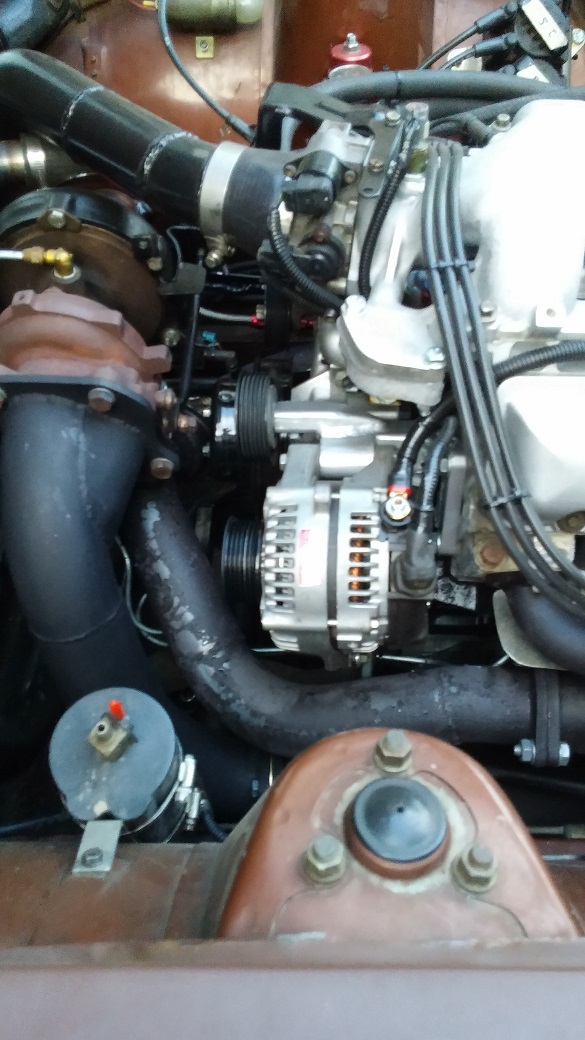

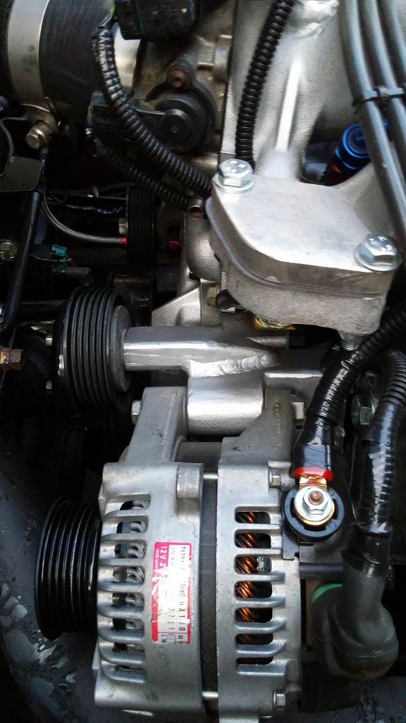

Installed:

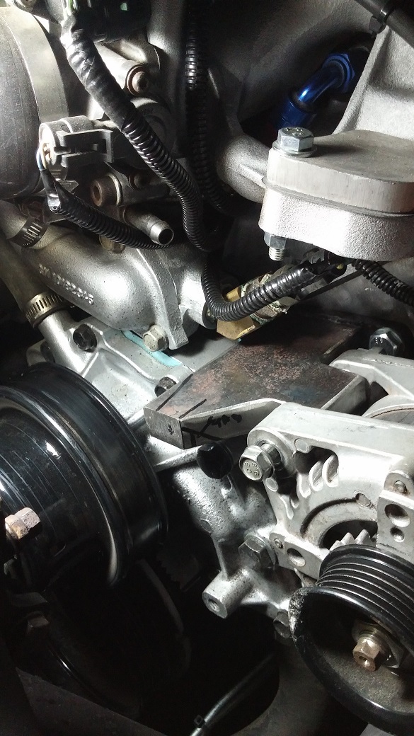

And the brace I added more recently. The bracket that I was using previously is still attached to the back of the alternator and the block, this one is just added to the front side, to take some of the leverage off the other mounts.

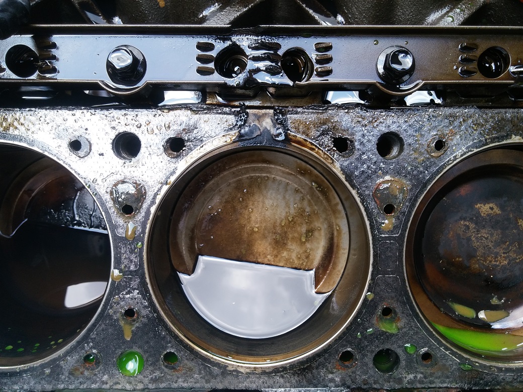

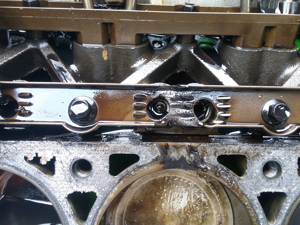

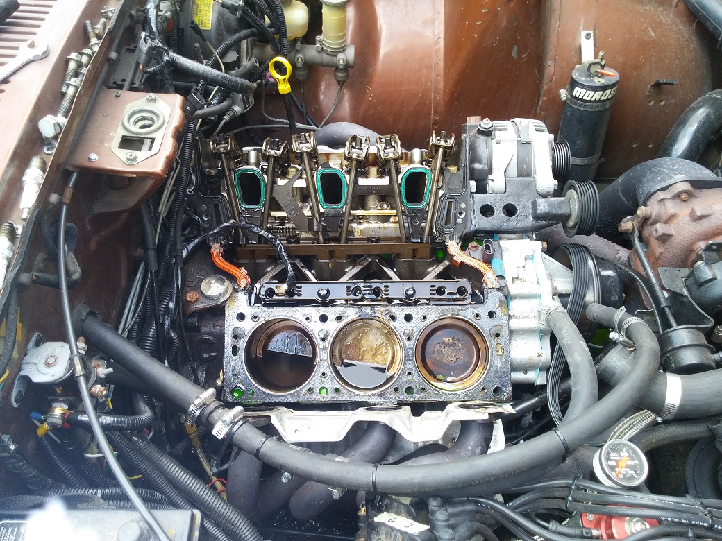

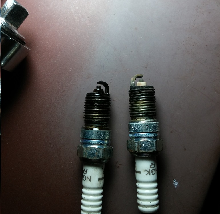

So I pulled the head off today, and found this:
A little closer:
I should have seen this before I pulled the head... LMAO!!
This explains why I was smelling burning oil. Not sure why I was smelling coolant though. There does look to be some VERY small paths for coolant between the nearest steam holes and the break, that maybe allowed some coolant to get into the cylinder.
I haven't pulled the other head yet, but will likely do that in a few minutes
Now I have to decide, do I put my other short block together, just so that I can open up the ring gaps a little, or roll the dice and just put gaskets on this one?

I pulled the other head and other than a couple slightly oblong rings on the gasket, it looks good. Inspection of the gaskets shows that the coolant was never serviced in the vehicle the engine came from, since there's some erosion of the gasket material around some of the steam holes.
