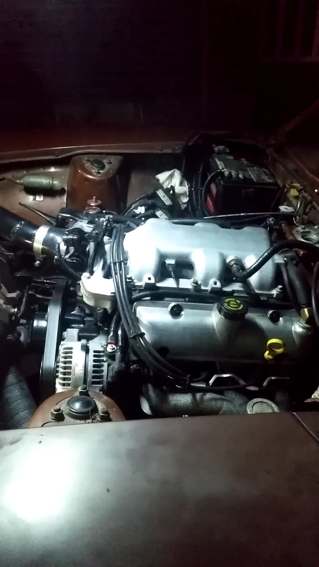

Well as of about 9:30 Thursday night, the LX9 240Z lives again.
I've been driving the car for a couple days now, well since Thursday night.
I had a new pair of Falken RK615K tires put on the back on Friday, since the old back tires were bald... no idea why, probably just a bad pair... lol
The front tires were still good, so I want to run them out for at least another season, also Falkens, but FK452s, which are not made anymore.
I was able to test the wet weather traction of the RT615Ks this afternoon, and I'm pleasantly impressed. I can still easily overpower the traction, but far better than what I was expecting. The FK452s still shed water better than the RT615Ks, but I'm not white knuckling it in the wet like I was a couple of times with the worn out FK452s. lol The dry traction is very good, and seems to hook much harder than the FK425s ever did. It seems to take about 3 blocks of driving for them to get enough heat in them to bite, before that, they are pretty slick, but that's a relatively short distance to get hot enough.
The exhaust note seems to have mellowed out quite a bit, much closer to the sound I really want out of this car. There was a pin hole leak in one header where the primaries and collector attached, I wrapped the headers and Y-pipe and retarded the base timing by about 10 degrees or so, based on where I moved the pick up, I haven't actually measured/set base timing yet. I hope to do that tomorrow night.Last edited by Guest; 06-23-2015, 01:27 AM.

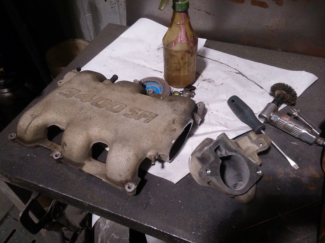

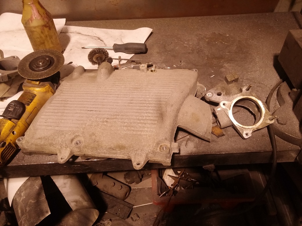

Also, what the heck is going on here?
Wait, wut?

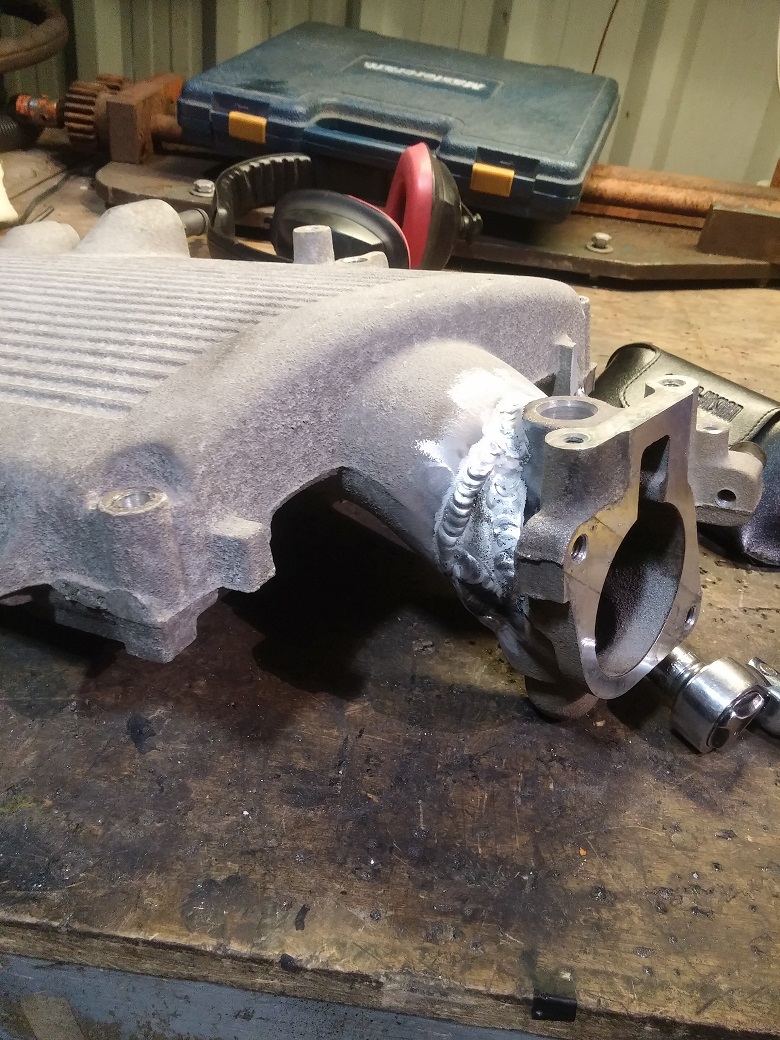

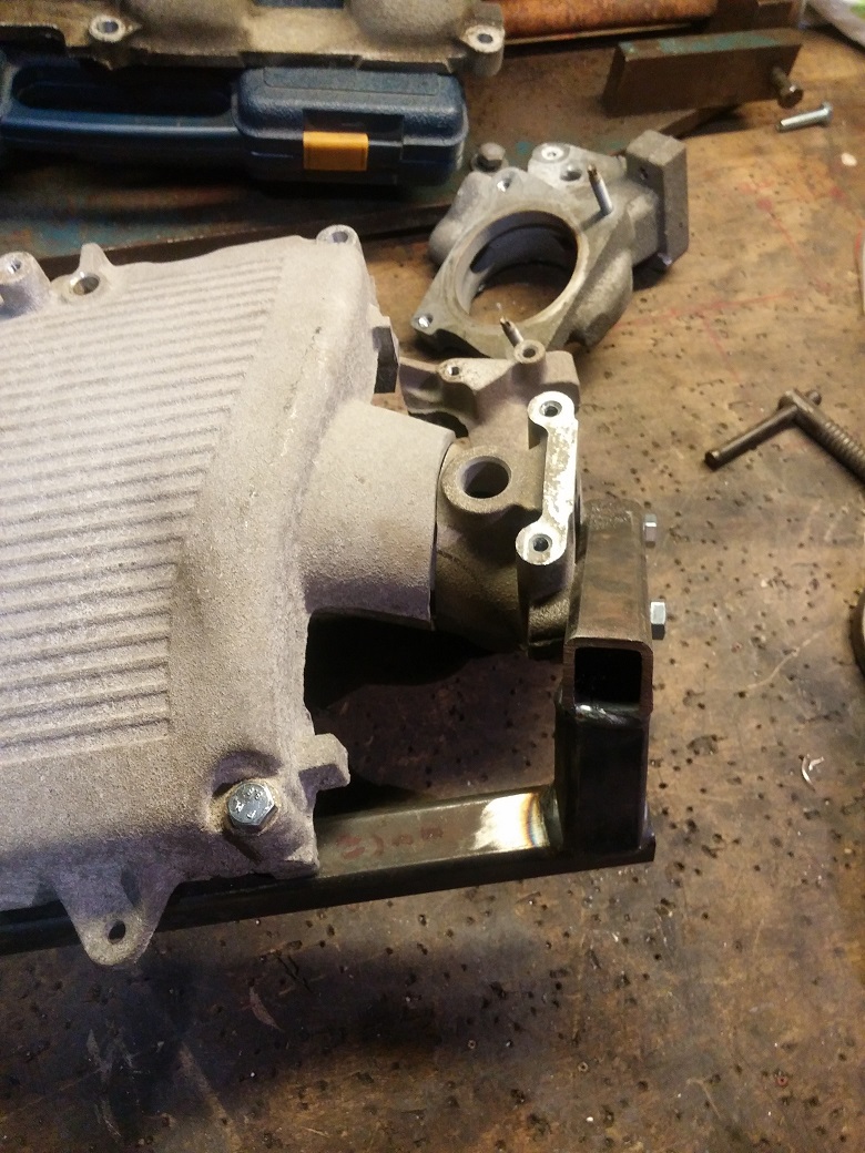

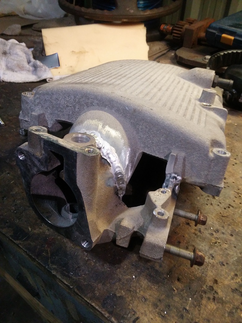

Yep, that's what is happening...

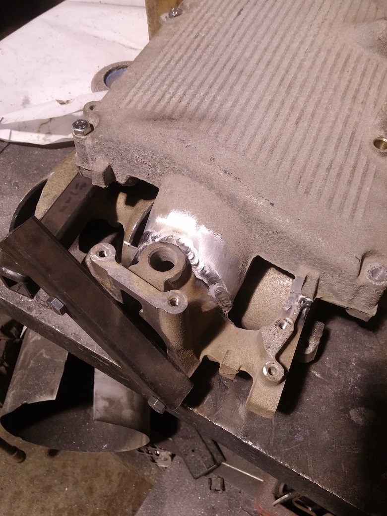

I still need to blend the inside, and add a few fittings to the intake, but this way I'll be able to literally slip it in place of the LA1 upper without modifying anything else. I could also do a an A-B comparison (dyno/track) very easily this way, looking at just the effects of the change in runner length and plenum volume, taking the throttle body out of the equation.

No, the flange of the 3500 intake is already about 5 to 7 mm forward in comparison, and then adding an adapter plate would be another 8 mm minimum more forward (and move it more to the side, due to the angle). With the intake tubing I have, this would not fit well, if at all. This would also create a lot of turbulence at the transition from the adapter plate to inlet neck, that would require some creative additions to the adapter plate to reduce them. While the transition won't be ideal here, it will be much better than a simple adapter plate.
Not the best, but it's all I have. No I did not do it. The Eco guys were swapping larger intakes(using their smaller TB) and a flat adapter. Kept telling them they were hurting the flow. Showed them that and it didn't change anything. Just got to laugh I guess.
Very refreshing to hear someone speak of it after it fell on so many deaf ears.
Use to have a great video with the air/smoke in motion at different speeds on the same model. Talk about loss of throttle response.95 Beretta 3100 with 3400 intakes and TCE TB

It's not a hard concept to understand, at least I don't believe it is.
I was going to add a bunch of vacuum fittings to the UIM, but I've decided instead to change the way I have my vacuum stuff connected and move it all to a single vacuum manifold, and run one large vacuum line to the manifold.
Sometimes pressure waves and acoustic waves are hard to understand. Tried to tell them that too(of the bad effects on them), but nothing, just like talking to my computer. Well that can get my head spinning when trying understand just what is really happening above idle. 6k or even 2k gives me a headache (lol).
