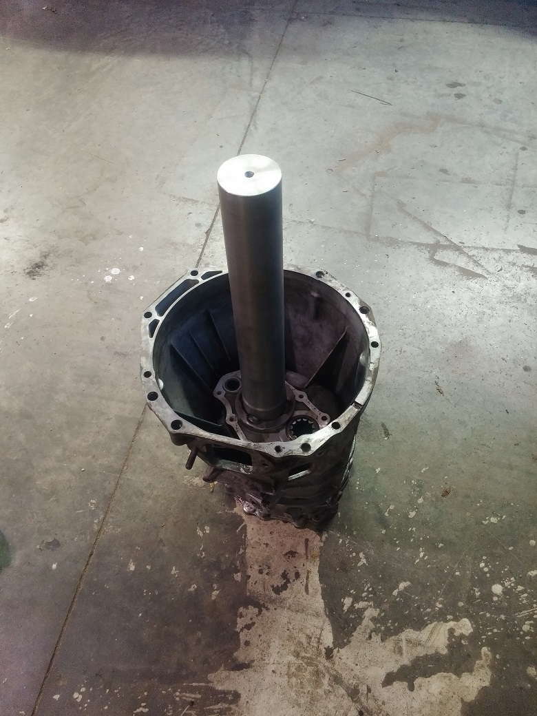

But I needed a way to align everything to get this idea to work
So I had this very large and heavy pin made:
Which one end fits into the input bearing hole of the transmission bellhousing.
The long bit fits into the main bearing journals of a block

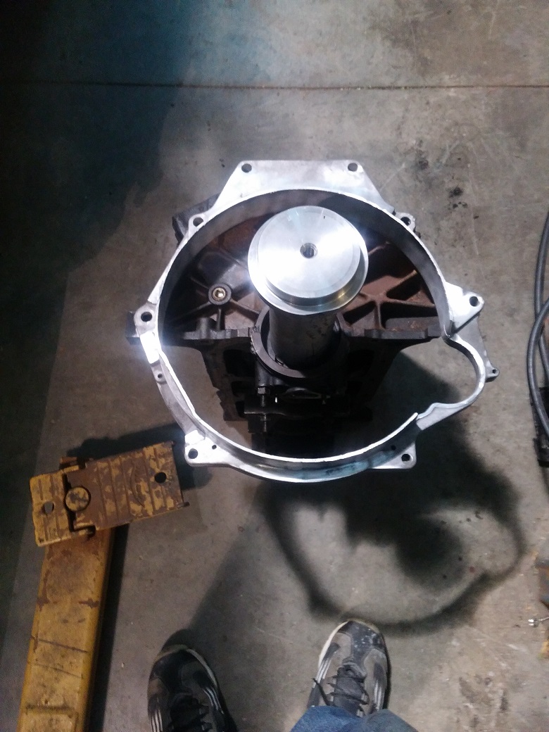

I cut the flanges off the transmissions
Both flanges side by side
The start of setup:
Slipped together and aligned

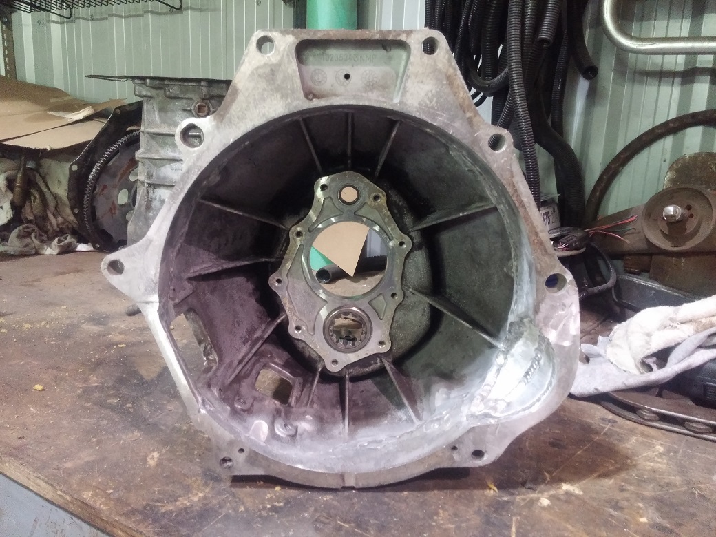

Introducing the very first 660 FS5R30A bellhousing
I added some filler dowel on the inside to help strengthen the weld between the two parts.
I then added a gusset to the top to help strengthen the top of the bellhousing
I had to create a new starter pocket
Looking into the bellhousing, the outer flange and the inner flange have never been seen together like this before.
I have a bit more done on this, just no pictures. I had to cut a slice along the new flange because it pulled when I added a couple gussets along the side, but with the alignment pin and the block I was able to get it real close to being in the exact right spot.
Just some verification test fitting to do before I reassemble the trans, but it should all be good to go.

Looks good. Did the RWD starter pocket and the 5R30A starter pocket actually line up that nicely or did you do some trimming for a filler plate later?
I have a 5R30A front case for an RB25 sitting here, it's slightly smaller in diameter than the VG30 case, so it may be easier to make fit with the 700R4 case that is in my shop floor. What do you think?
