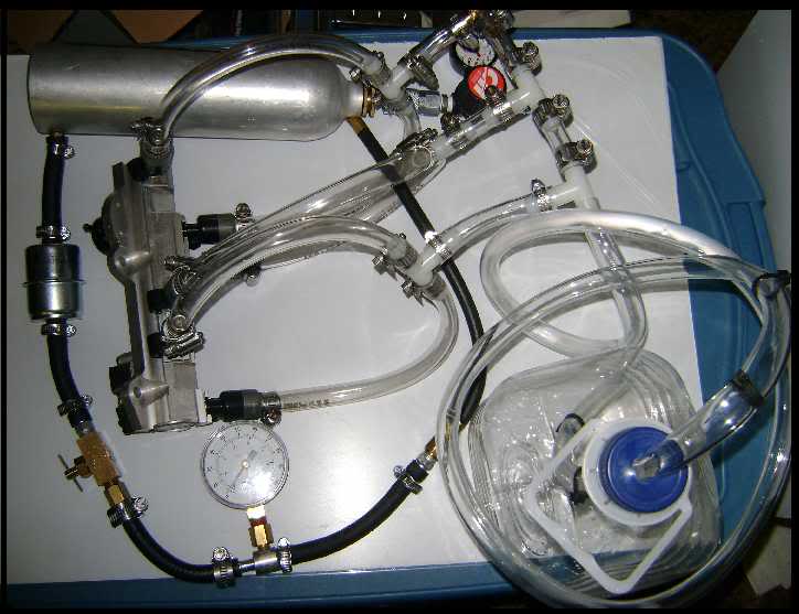

  • In lieu of using glass or Pyrex... these are identical to the ones I'm using on "The FrankInjector Machine" for Flow Balance Tests and are 50ml graduated polypropylene cylinders...
    Those EFI connectors are the lowest priced ones I've seen yet... Great Find!

                I ran into a problem with my injector cleaner design. I bought glass cylinders instead of plastic for some reason and the glass bases are just a little bit too big to allow me to line the cylinders up beneath the injectors. I need to trim a little material off the sides of each glass base and I'm not sure what the best method is. Right now I'm thinking about using a soldering gun to make a hot wire and pressing the wire against the glass, then submerging the glass in some cold water. From what I've read, the glass should break along the line where I applied heat. I guess if that actually works, I'll try to make a video and share.

                      1. The EFIs must be cycled at rates of 50 ms. 100ms and 1 second intervals to ensure that the internal metering valve and spring are up to snuff...and perform at rates for each speed/duration evenly, one with each other. If cycled like this again and again (at the moment, the only reasonably priced actuators are those from OTC), you will be able to determine if any injectors indicate problems electromagnetically... If they are sluggish and non-responsive after having their filter basket(s) replaced and after a thorough cleaning in an ultra-sonic hot tank and a through fluid pressure cleaning via "The FrankInjector machine"... then check them with a multi-meter for defective innards
                      2. The EFIs must be able to fire all at once in order to visualize the 50mL cylinders and observe the rise of the EFI cleaning fluid levels for comparison against each other as a set. The GM factory recommendation for the Rochester Multec lines of EFIs indicates they should all be within 5% of each other to prevent imbalances between cylinders through a wide range of metering needs...say from a 600 RPM idle all the way up through the entire operational range of the engine(s) performance.
                      3. The "ECM_Lite" version of the electronic controller must be straightforward and robust enough to function via leads from a 12 VDC Car Battery.
