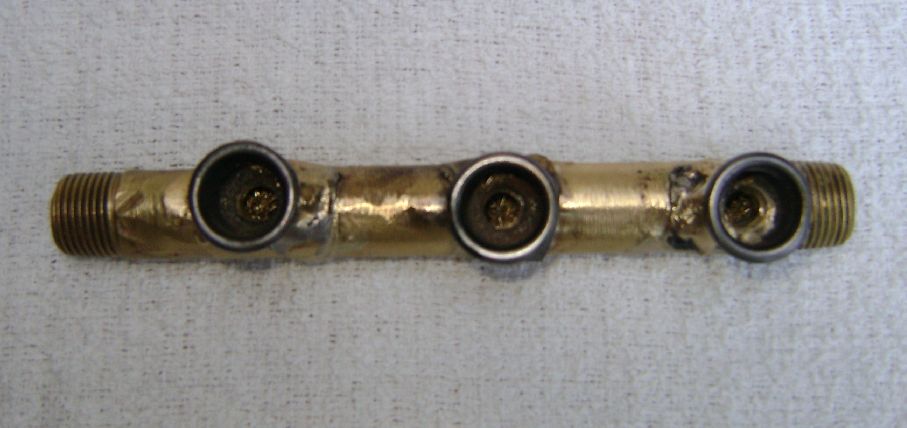

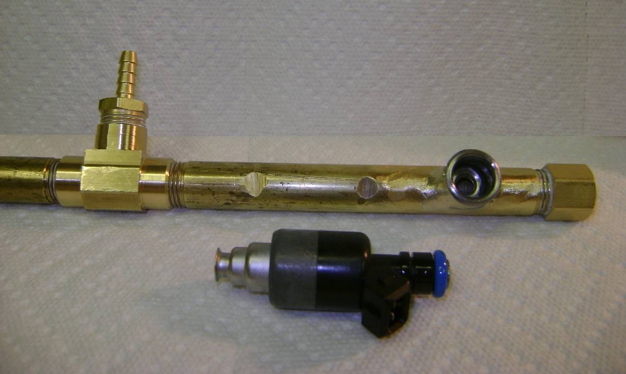

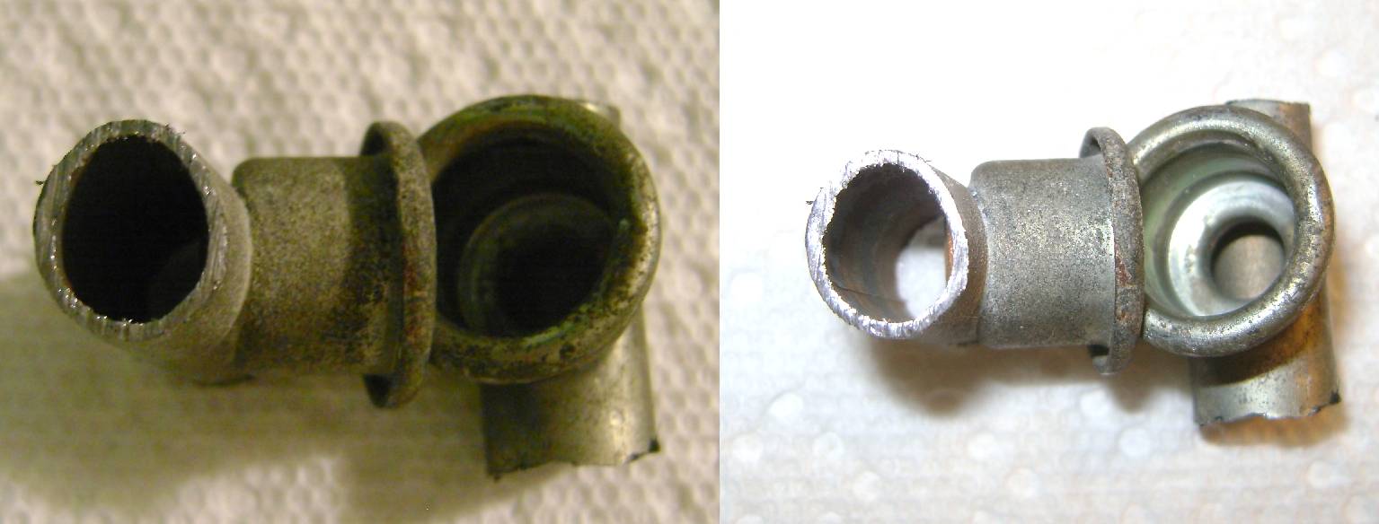

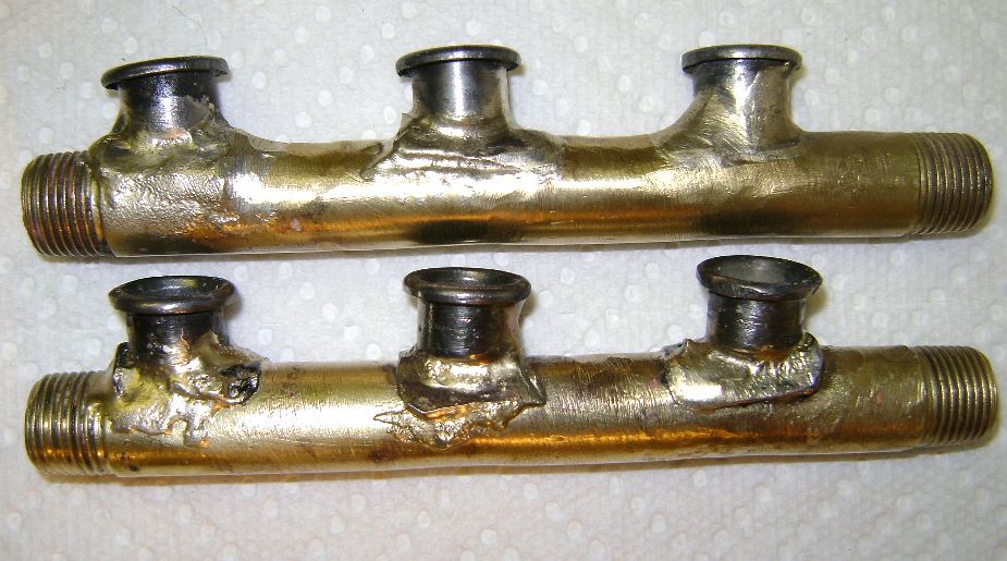

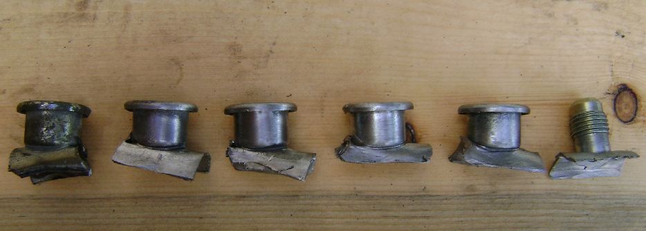

Okay... I got wise to the notion that building one "complete" Proto-Type after another of "The FrankInjector" was a very Bad Idea, given my hubris at imagining that every time I think of something and get down to actually building it...that it will work. The Failed Effort I put into the last (Version III) happened because I did not consider any thermal implications in the use of Copper Tubing, with a Brass Pipe Insert as the means to hold and seal up the "BLUE" O-Ringed ends of the Six (6) Rochester Multech EFIs I installed in the rail. It failed miserably and that took me, "Back to the Ol' Drawing Board" for a complete Re-Design of the "NON-GM-NON-FACTORY" EFI Cleaner (Fuel) Rail.
As you can see from the attached images and my latest video... I got wise enough to use only one of the "EFI Nipples" I carved off of an old 3X00 Anodized Steel Fuel Rail for this experiment. Of course, the issue I knew I'd be facing was that sticky little problem of the difficulty in Brazing/Welding a Ferrous Metal (Steel EFI Nipple) to a Brass Metal (EFI Fuel 6" Brass Pipe for the EFI Rail); especially since its harder than an early morning "Pee Chubbee" when the BASE Metal turns out to be Brass instead of Steel. Very HARD!
So what to do? Well the secret in this case was to make certain that both items (see the pics for a better idea) were squeaky clean, bench ground and wire wheel polished and then mounted in such a way that there is at least a little space between them B4 you even light the Brazing Torch and then add the O2. Next ...it helps to "Pre-melt and Cover" all the pieces being brazed with a good Bi-Metal Fluxing compound and heat the stuff until it bubbles and looks foamy...then let the pieces sit for a bit to cool. Finally... you need a good roll of coiled Brass/Silver Brazing wire and unwind about 6"-8" so that when you apply it and it eventually begins to flow into the joint...you won't burn your fingers by getting too close tp your work. When the Feed Wire starts getting shorter...unroll the tip of the wire (one-handed, wire extended along the surface of your work bench) to keep a decent length to work with.
Next is the torch. I was able to get away with using an older "Mini-Map Gas -Oxygen" Dual Hose Torch I've had for years and after cleaning the tip with a Brass brush, and after lighting the MAP gas with only a 16th" turn, when the flame is orange and still close to the end of the tip, burning with black plumes of unburnt carbon floating in the air... introduce your O2 to the MAP Gas just a little at a time until your flame is a nice, Dark Blue on the outside with a lighter, hotter 'Blue' Center Flame. When you apply the heat...try to start with the Brass Pipe first and then move the flame around the base of the EFI Nipple until both are glowing nearly red. By now...your Flux will have melted and gone from a crusty coating to a milky smoothness....and when it finally turns clear enough to see the underlying joint...you are very close to Braze Time! (Wear Brazing Goggles and protective clothing!)
At this point...work the flame back and forth over the Brass Pipe and EFI Nipple Fitting while also holding your "Wire" in between to heat the metal up enough to melt. Don't be impatient... Work the flame back and forth enough to see an even distribution of heat. The Filler Metal in your "Wire" will melt first...so feed the stream of it into and under the clamped EFI Nipple while dragging the flame back and forth between the fitting and the Brass Pipe. When everything gets hot enough...the wire will melt like a Butter Paddie and all you need to do is not get fascinated enough while watching to stop the back and forth motion with the Blue Flame. Don't be cheap with the Filler Wire!...Feed plenty into the "Wound"...You can always grind off whatever you don't need or want on the finished work. And all of the "extras" are re-usable and recyclable. Be prepared to have several MAP Gas Bottles on hand and three times as many O2 Canisters as well. Check your work often and be careful where and how you lay out your hoses. This work is best done outside where there is plenty of light and distance from flammable liquids and other things you might accidentally set on fire. Keep a decent ABC Fire Extinguisher on hand... but there really is no substitute for common sense and thoughtful judgment when working with open flames around explosive fuels and accelerators. Keep that in mind when you set up your work area to do this job. If you have the least bit of doubt about your abilities to perform all these tasks at once... Then STOP... Get some professional help before you manage to accidentally burn your house down while trying to do this!!!

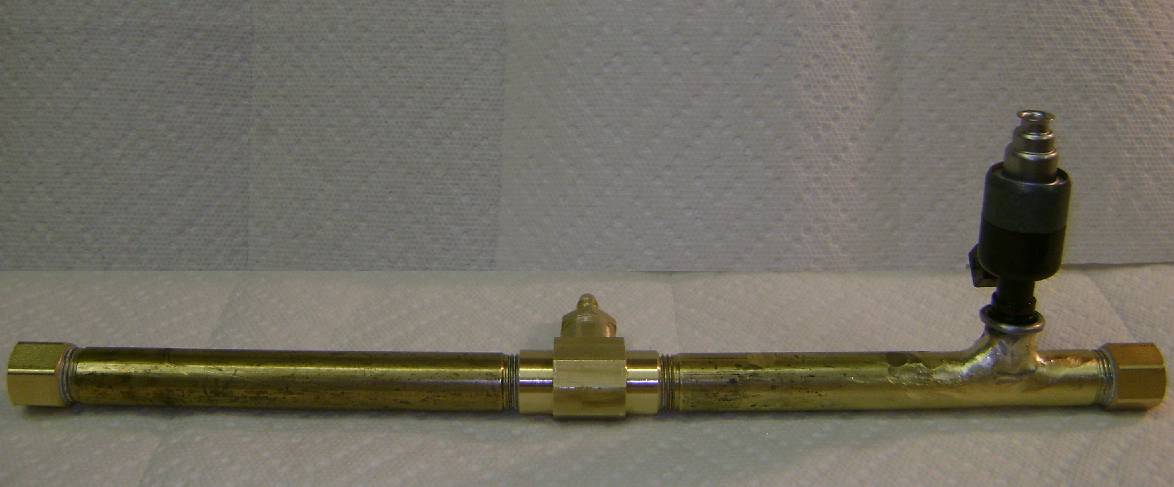

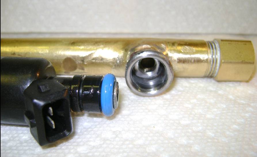

Proof of Concept:
This would be in the affirmative, but for the fact that I have yet to braze the remaining five (5) EFI Inlets in place and wonder now whether the average Mechanic would want to mess with something that requires so much planning and precision to do the assembly right. But even if this experience turns out to be unique to my own work, I can at least have the satisfaction of having defeated all the major problems and constructed all the necessary working Prototypes successfully.
“The FrankInjector Machine” Works.... Period.

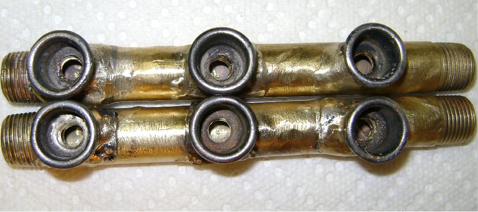

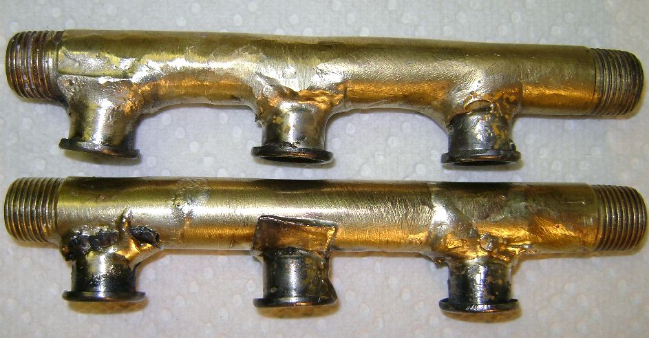

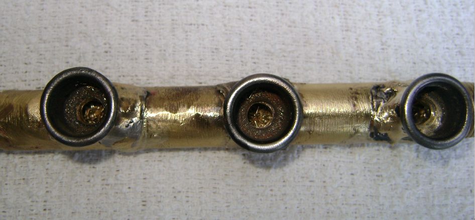

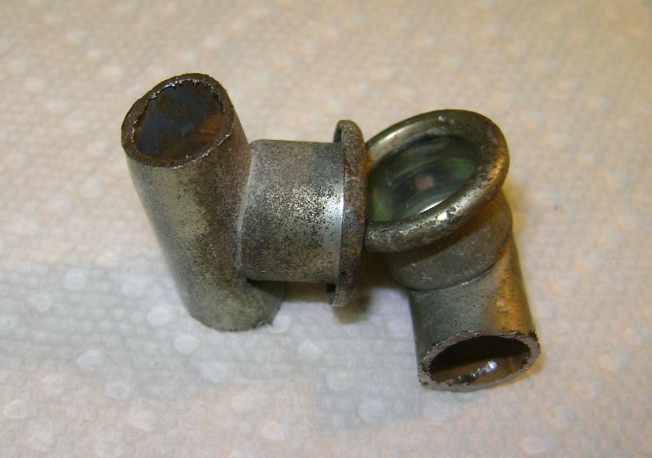

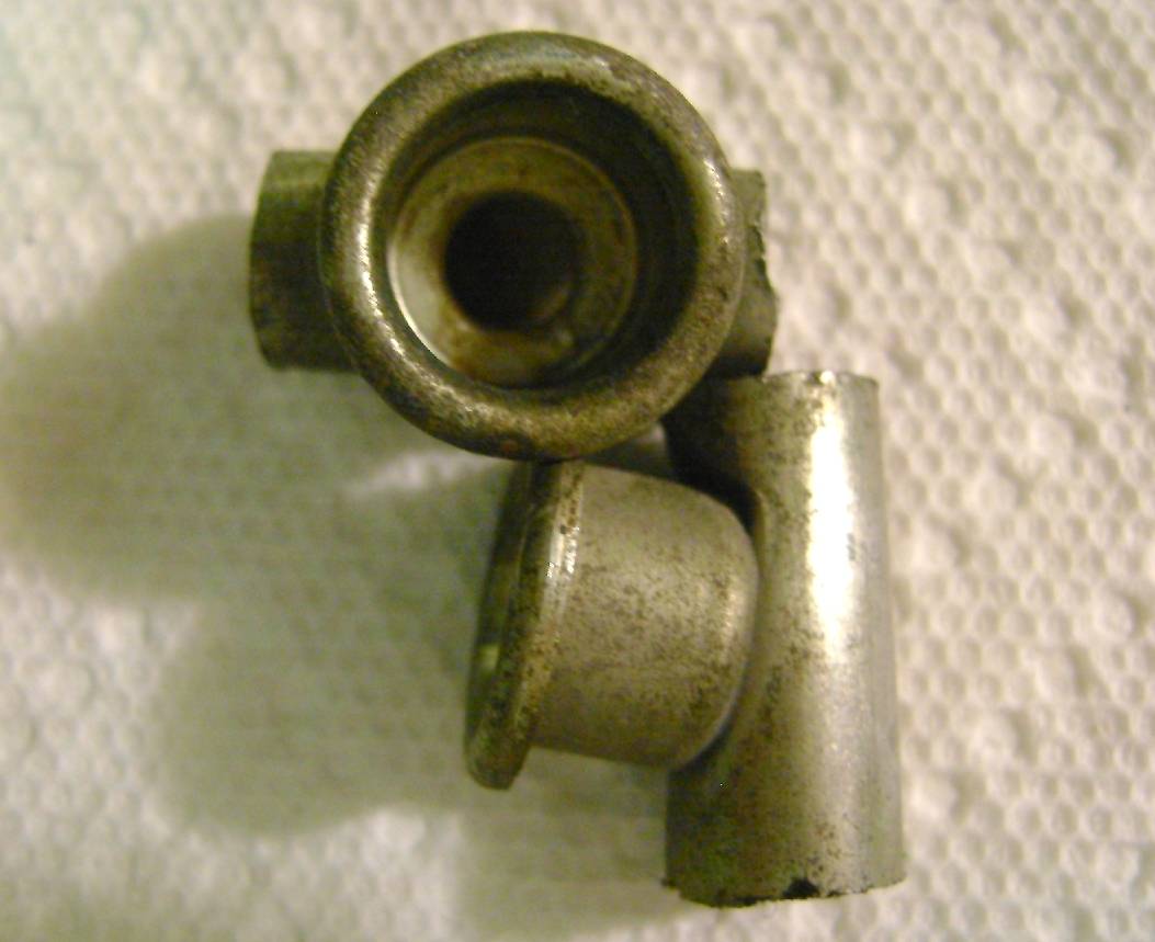

Okay... This afternoon ...under what can only be described as a "Philadelphia Winter Sky" I managed to finish cutting and adapting the remaining five (5) EFI Nipples scavenged from a GM 3X00 Fuel Rail and after running out of the best kind of Brazing and Flux Kit, I struggled with some alternative rods that got the job done; albeit with less economy and good appearance than I would ordinarily tolerate in my work. But now that I think about it...nearly 45 years ago, during a high school class on Basic Welding... Our instructor had the habit of reminding us..."This is a Welding Class... You don't get points if your welds look "Pretty"...Just make damned certain they all HOLD!" And with that in mind... That is how I proceeded to complete the task. If you spied the Schrader Valve in the photo...its because I'm debating whether to braze it on the upper portion of the pipe as an alternative to using the Brass Barbed fitting as the means to introduce the EFI Cleaner into the Newly Designed Brass EFI Rail.
I'll finish cleaning the two Brass Pipe Assemblies tomorrow and then mount the rail on "The FrankInjector" after running some cleaner through the system without mounting the EFIs. If everything looks good, I'll install all six (6) Test EFIs and pressure check the system for leaks along the weld seams and around the "BLUE" O-Rings, too. If all goes well, I'll put the machine through its paces and shoot a few more videos of how it acts. What I am particularly interested in memorializing is how this Brass Rail handles the Flow Balance Tests. If there is a significant difference and improvement, then I'll know that using the GM Factory Fuel Rail was perhaps a nice entry level way to build other versions of "Frank"... but that in order to cover all the tests necessary to clean and prepare a decent set of EFIs that anybody would have confidence in remounting on their engines and expect a much improved performance from these efforts, the Brass Rail is a necessity.
