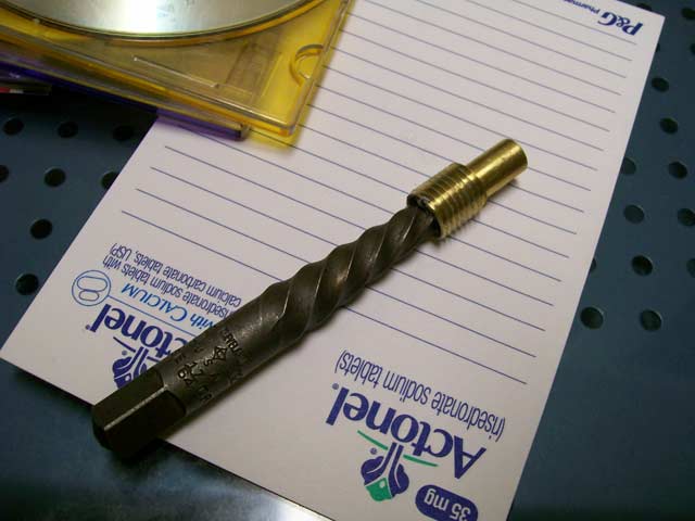

Confirmed by my machine shop.. 12mm x 1.5 pitch

just picked mine up from the shop...
.jpg)
No charge (since they broke the first one)

Been following this. Think you're a bit frustrated,,, take a breath or two!!! Better?? Now it seems that the center of the sensor broke leaving just the threads in the engine,, right??? Well you don't need to drill anything,,, you've already got the hole.. The only reason you'd need a drill is if whatever broke was solid,, like a bolt. Find an easy-out that will go in the hole,, not ALL the way in,,, just enough to get a good grip. Maybe a 1/4 of the way. Give it a tap to seat it in there. Use a tap wrench, open end wrench or a socket to hold the easy-out by the square on top and give it a turn. It doesn't sound like you over torqued it so it should come right out. You could even give it a shot of Liquid Wrench or equivalent if you wanted. I doubt if anything will break off and fall in.
I really think it will come out so easy you'll be surprised!!
Hope this helps!!
Tom
Leave a comment:
I know that is what an easyout is designed for... but as I said earlier there is no possible way to get a drill in there to use an easyout. I would have to pull the engine, or pull the head off, or somehow rig up a long ass flex to do it.Last edited by PCGUY112887; 08-09-2007, 06:45 PM.
Leave a comment:
Guest repliedUse an easy out, use an easy out. It is designed for that kind of problem. If the piece falls into the cylinder head water jacket area I doubt it will cause any problem whatsoever as it is unlikely to be able to close off any passage and it will never make it past the radiator into the water pump not to mention the thermostat.Originally posted by PCGUY112887 View PostDunno, depends if I can ever get this thing outta there.
I think I am going to take a bolt that fits as tight as I can get and JBWeld it in, then pray I can twist it out with a wrench when it dries. I did go ahead and stick a screwdriver in there however I could not feel anything I could "grip" onto.
Can anyone think of any last resort option to get this out, that does not involve taking the engine out or apart? I am afraid that if I JBWeld this in and it doesn't come out for some reason, I am going to wind up with a bolt stuck in my head via JBWeld. Or that I am going to twist and the "body" of the sensor that is stuck inside is going to break and fall into the cooling system and down into the block. How bad would that be?
