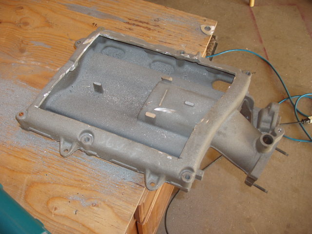

Well since I decided to ditch a custon one piece and move onto a ported LIM and custom UIM..........here is where I am at with a hacked up 3500 UIM. I am now waiting for my heater core/intercooler to show up so I can have the bottom plate machined that will be welded onto this hacked up manifold.

lol, Does this mean Hank's gonna need that LIM longer than you thought?Originally posted by kwhauck View PostWell with a new aftermarket hood design being released for the alero. The design will be changing from a complex custom 2 piece LIM to a stock LIM and very simple box plenum UIM. I have not decided wether or not I will be incorporating a sandwich style W2A intercooler.
