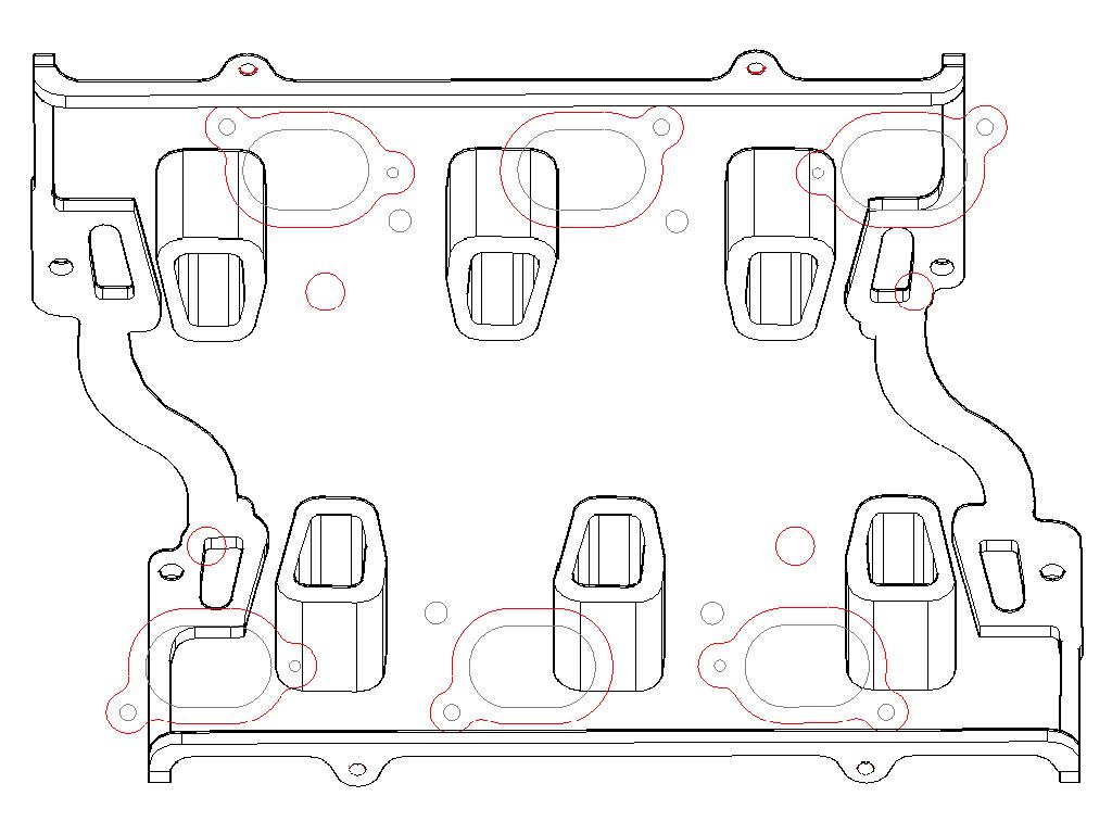

    Making a little progress on the coolant routing/thermostat housing. I started trying to build it out of pieces of 1/4" material like the rest, but soon figure out that just wasn't going to work out well. So I have now moved to blocks of material with bored holes. And since I am trying to make this as a potential part for daily drivers as well as custom builds, I am trying to maintain all the standard connections (bypass, heater core, CTS). Its proving to be somewhat of a pain, but I'm sure I'll figure it out eventually. So, no picture updates tonight, sorry...
    While searching around last night, I came across the following post: http://www.mopartech.net/showthread.php?t=7560
    Hopefully we'll have a build thread like that for this manifold. Also made me think I need to go down to 1/8" for the cavity area, instead of keeping with 1/4" throughout.

    Well, I should have had my spare manifold with me while I was modeling this, as I had it all jacked up. Figured it out when I started to overlay a CCM of the 3400 ports that I received from Marc a few years ago. While lining it up, the ports from the CCM and the ports I had modeled didn't line up very well, so I decided to bring in my manifold to compare it to what I had on screen. Needless to say, I had to rearrange several of the parts, flip them around, etc., but finally got it where it appears to be correct. So now that I have that figured out, its time to start with the modeling of the coolant passage/thermostat housing, and then the cavity that the ports will go into.
    Anyway, here is a top shot of the model with the 3400 port CCM overlay-edClick image for larger version
