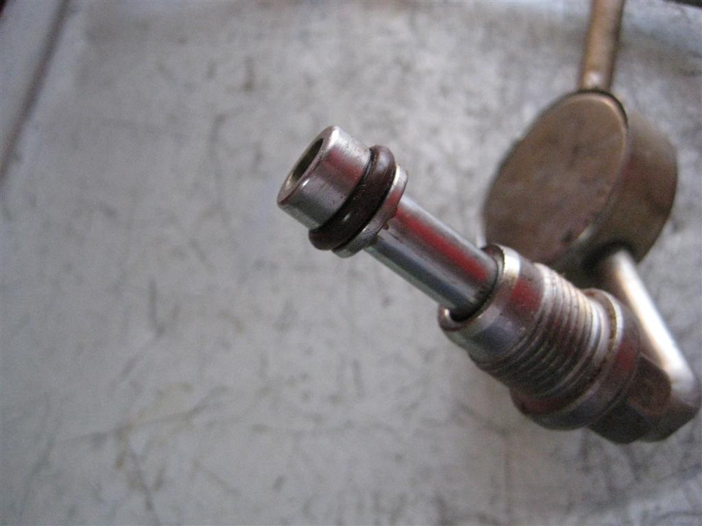

    Strange... Out of all of the rail lines I've pulled off the o-ring was only about 3/8" total diameter and went on the end of a specially flared section (that ends basically right there where his pic shows, you just don't see the very end, but it's *right* there) I've highlighted in yellow. I'm not arguing here (you know this), I've just never seen one of those goofy looking blocks on the end of a line like that like you have there.

    replied
    Injector o ring is smaller.
    Leave a comment:
    replied
    Pretty sure I got mine from AutoZone, or some place similar. It might even be similar to an injector o-ring, which they should be able to pull up.
    I believe injector o-rings are a bit thicker than the o-ring on that fuel line.

  • WrathOfSocrus
    replied
    ACDELCO Part # 217461
    That's from rock auto under fuel rail o-ring kit

    replied

  • Rootie524
    replied
    where can i get this? autozone was clueless..and i need it like super rushed delivery asap.

    replied
    Yes, there needs to be an o ring.

  • Rootie524
    replied
    ok..so..it was all back together today..and im all ready to start it..i turn the key two clicks to prime the fuel pump and i hear the splatter of liquid on my garage floor. a few seconds go by and the smell of gas fill the air. as pissed as i could be i take off my throttle body and UIM to get a good look at the fuel rail and have someone turn the key while i see where the leak is. It is coming from around the bolt on the fuel inlet hose (pictured below).
    when i took the engine apart..that hose was stuck pretty good in the engine so me and my helper had to pull them apart..so idk if there was an o-ring in there or not. if there was i dont know it cuz it would have flew somewhere. so my question is why does it leak..does it need a o-ring or do i need a new fuel inlet pipe cuz somehow i messed mine up?! im so pissed. i coould have had my car back up and running tonight if it werent for this.
    and the leak is not coming from where the bolt meets the fuel rail, it's coming from the very outter end of the bolt and the gap in between that and the pipe itself. hard to explain unless you've studied this pretty well before.
