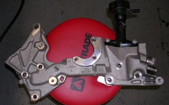

LIM does not have coolant passages. The U cooling system pushes the water into the front of the block on each side, it circulates through the engine and exits from the end of the heads above the TC cover (exits through the freeze plug openings in the heads). The coolant return system bolts to both heads and holds the PS pump and alternator. The alternator mounts different than 3X00s that I have seen and is a 125 amp Bosch. The thermostat is located on the inlet side of the water pump.

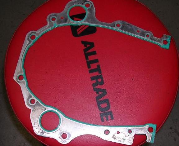

LIM, UIM, TC cover, coolant return and water pump use metal gaskets with molded rubber inserts. They look like they will be expensive to replace, who knows.

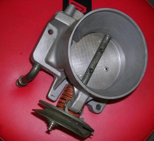

The 3900 uses a 70mm electronic TB and the UIM will accept a 76mm without porting. I am going to make an adapter to mount a 75mm TB from a 5.3.

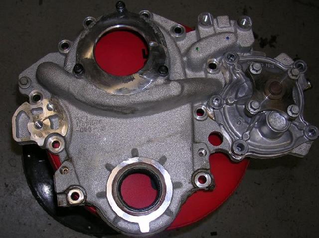

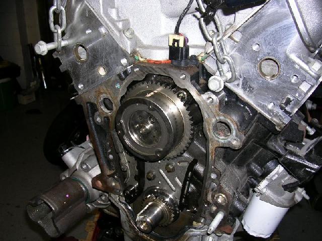

The camshaft has a hub that extends about 3/4" from the face of the block. It is used for the VVT feature and will not allow the old style TC gear & cover to fit. I have not removed the cam yet to see if an old style cam can be used. Also, a chain tensioner is used instead of a guide.
All of the TC cover bolts are M8 instead of having (5) M8, (2) M10 and (3) M12 bolts on previous models. One of the three bolt holes on the front of the block that were used to mount the engine was eliminated. The 3900 only has one hole on each side of crank.

Looks like I need a new bench so I can flow the larger bore heads. Very cool on the adapter to go larger TB
