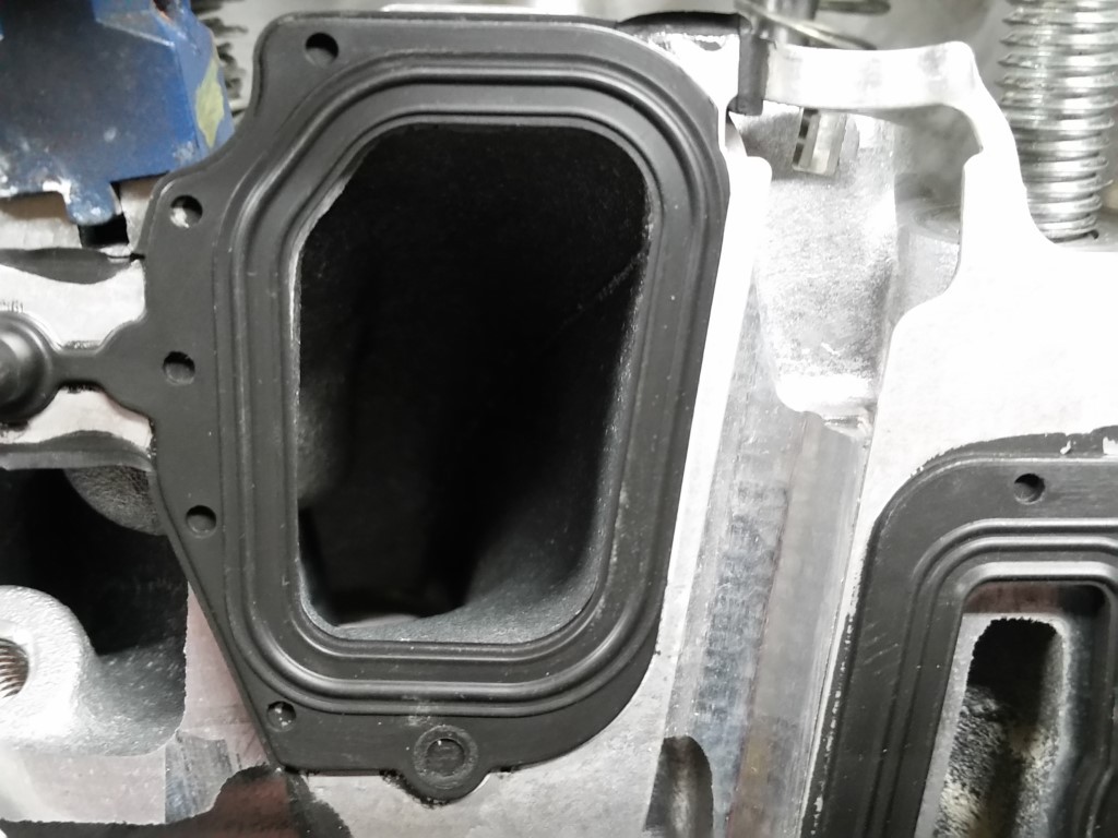

    If you are replacing the lower intake gaskets for whatever reason, its most likely going to be a metal and rubber gasket, like this.
    Click image for larger version  Name:	Stock Gasket.jpg Views:	3 Size:	141.0 KB ID:	427184
    which is great, if you only want it to seal. If you want it to make the power it use to, then you need to remove some of that rubber, like this.
    Click image for larger version  Name:	Modified Gasket.jpg Views:	3 Size:	150.4 KB ID:	427185

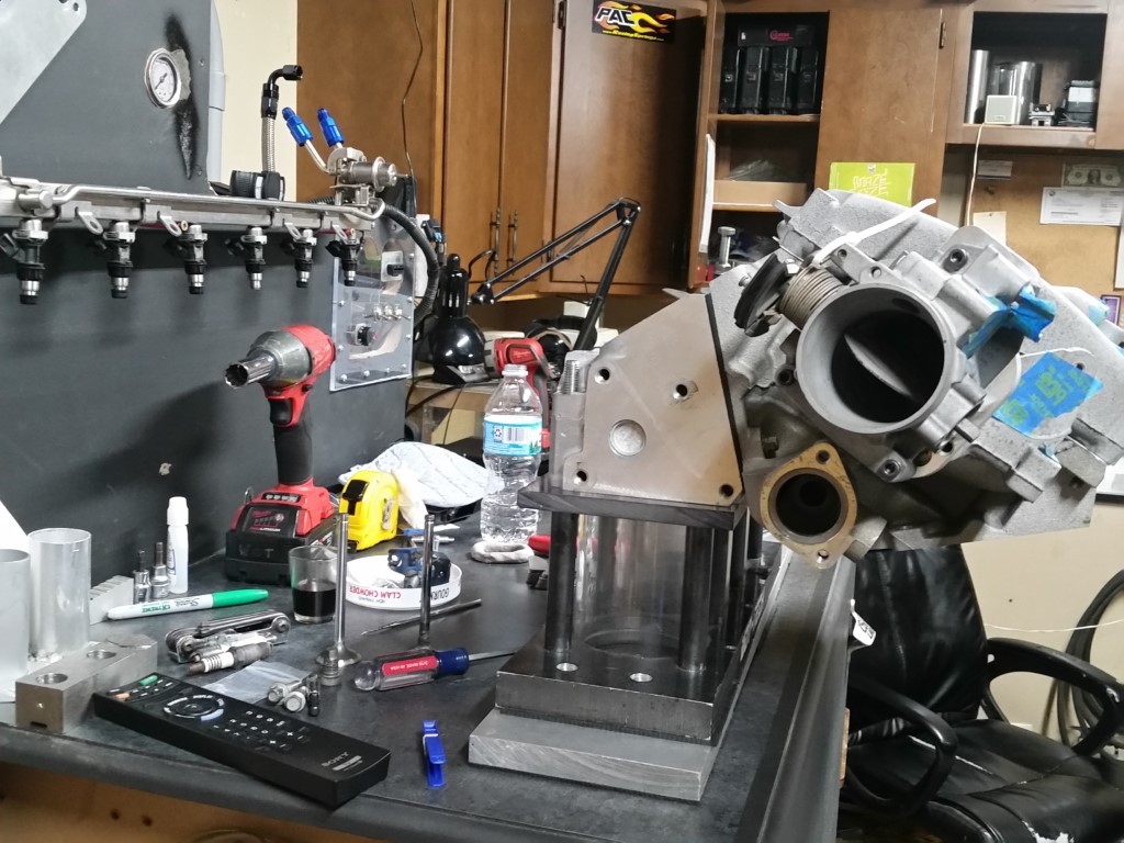

    Then you throw it on a flowbench (or take my word for it since I did this step for WOT-Tech)
    Click image for larger version  Name:	Test setup.jpg Views:	3 Size:	192.1 KB ID:	427186

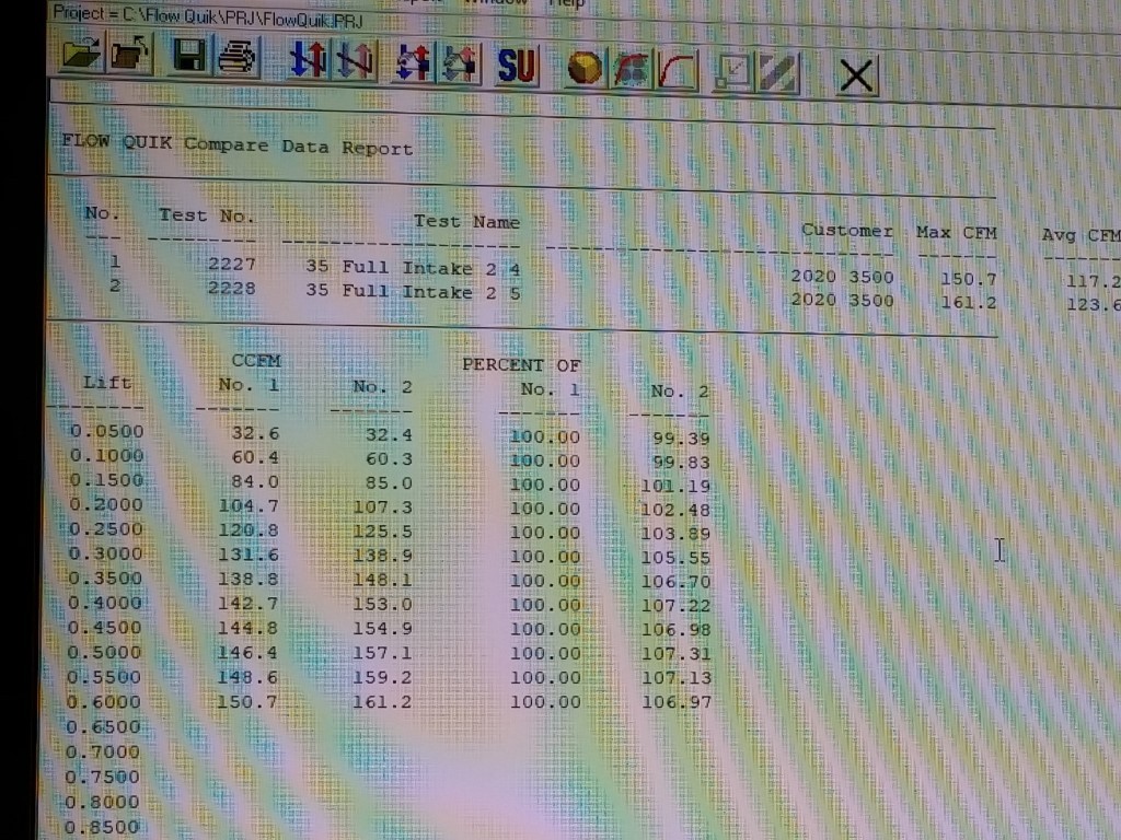

    And see what the flow difference is.
    Click image for larger version  Name:	Flow Chart.jpg Views:	3 Size:	257.4 KB ID:	427187
    That is a lot to lose from an intake gasket, so make sure you modify them and keep the engine running its best.
