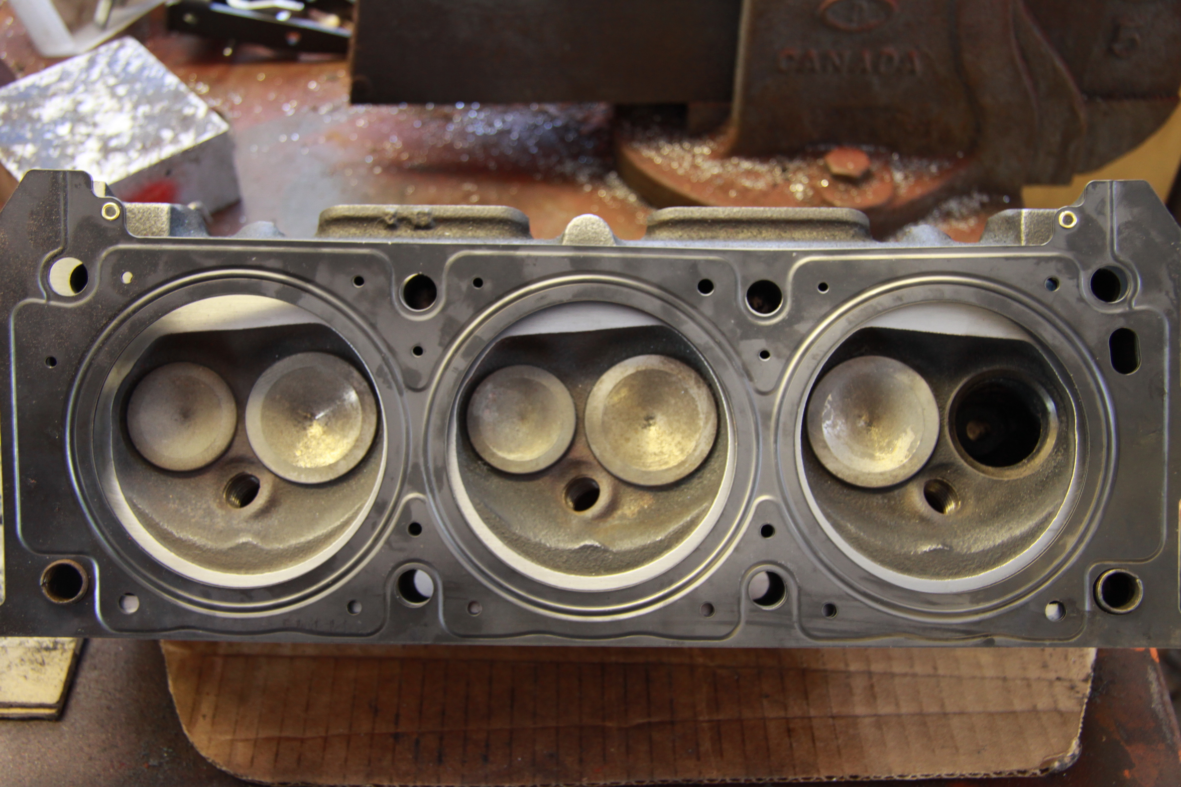

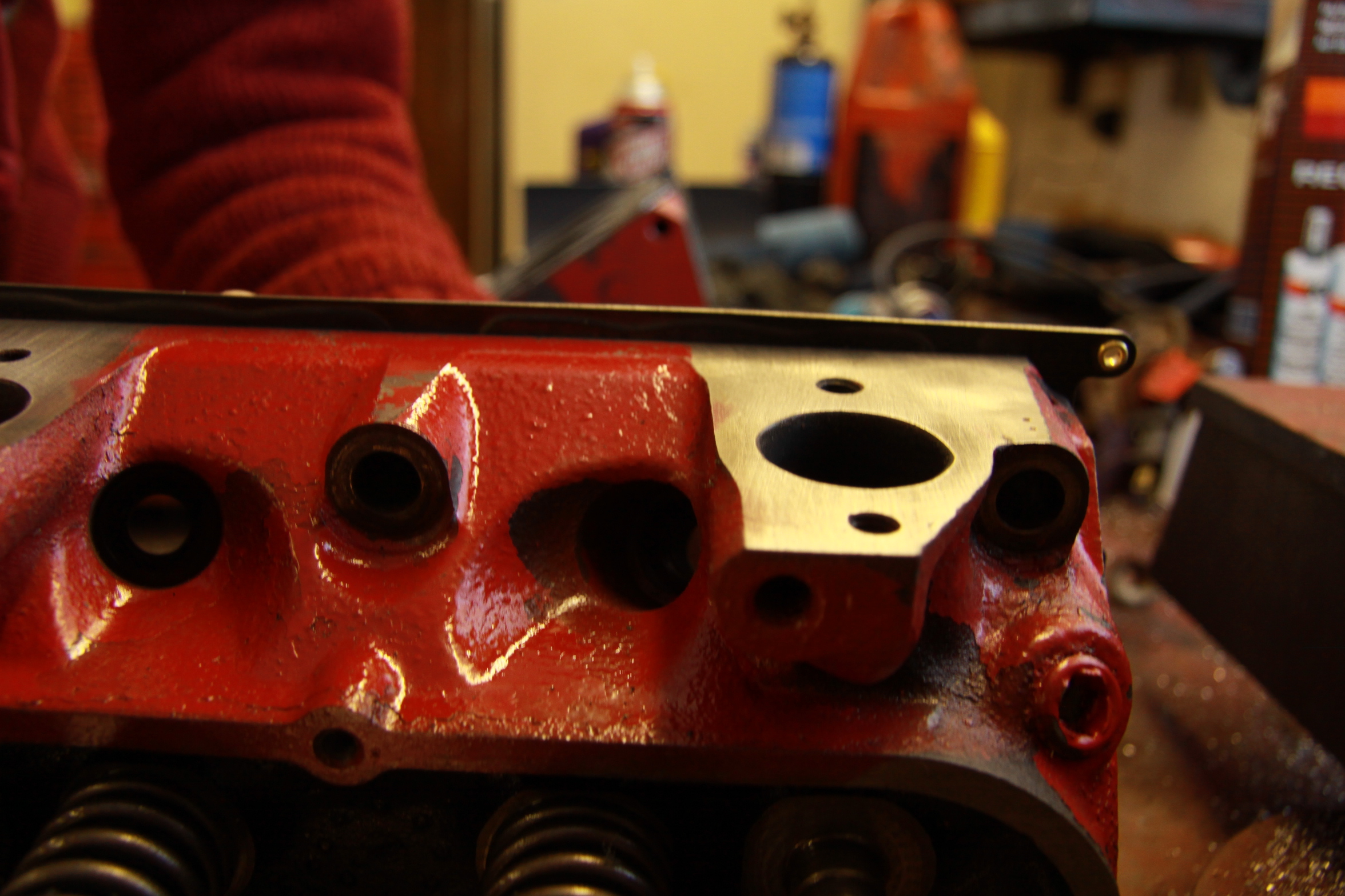

                            Wrong gaskets?
                            I got the 3400 comtic mls gaskets for my 3.4 iron head as directed in this thread. I went to install them but the don't line up with the bores and the embosed parts hangs out over the side of the block. The sticker on the package says they are for LX9, lZE, LZ4 92.5mm 0.030"
                            I did some reading on the LX9 and found out the bores are offset 1.5mm from the original 60V6.
                            Was I sent the wrong head gaskets?
                              • 13520
                              #44
                              Can you take a picture? They all have that printed on the sticker, which is misleading and irrelevent unfortunately. Cometic did not understand the LZ motors had the offset bores originally. The LX9 is not offset however.
                              • ssdurango
                                • Dec 2004
                                • 170
                                #45
                                Here they are.
