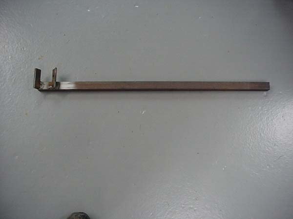

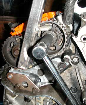

                  Here's a couple of pics that are/were posted somewhere....... I'm going to make something similar soon..... Need to do a timing belt.... The motor I just put in has 59,000 miles on it.... Who knows if the guy did it before the car got totaled..... Besides,, I got one of the adjustable timing tools and I'm going to do the 6 and 6 timing....
                  DON'T try to loosen/tighten the bolts using the cam flat hold down tool!!! I've heard of more than one person stripping out the bolt holes.... They are NOT supposed to be used for that.... They are only for getting the flats lined up....
                  Good luck,,,
                  Hope this helps.....
