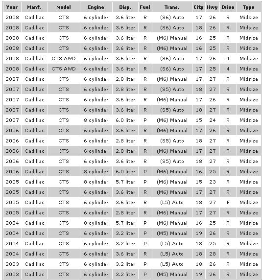

                  I have seen those. It appears that there is no efficiency advantage for the 2.8, just less power. Any idea if it weighs less or is dimentionally smaller?

                    Is it VVT? Certain things may prove difficult possibly. I didn't find the specs on it yet so I don't know. Is it a pushrod or OHC? A LX9 3500 is 200hp and would be nice for that car. Or a 3900 even (has variable intake and cam though). Even with a bigger motor with a lot of power, if the car is light weight, and you keep the RPMs down your MPG will be good still. That's how the LS1/LS6 camaro/firebird/corvette got 30mpg on the highway with the 6spd.
                    Any reason to go with a 3500 or 3900 vs. the 3.6 other than price?
