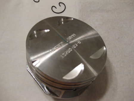

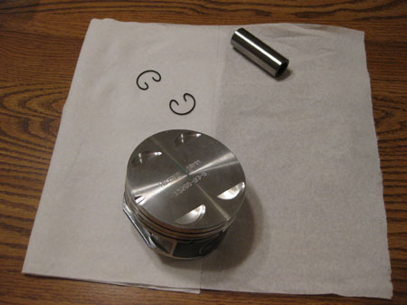

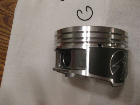

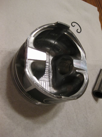

                  Well, I had a few minutes so I snapped some photos of my NorthStar pistons. I checked the compression height and confirmed that the posted spec is correct at 1.250". I also weighed one of the pistons and found it to be 514.5g with the wrist pin and a couple of locks. The rods I plan to use have an advertised weight of 592g +/-. 'Anybody have approximate weight specs for the LQ1 rods and pistons?
                    I know Ben has some pistons/rods at his house. If he needs it, I have a hydraulic press to remove the pistons from the rods to get a weight on them individually. Then again, you probably have one as well, as does the machine shop he uses... Aren't new pistons a thing of beauty?
