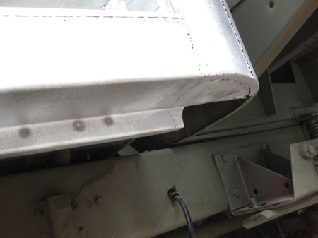

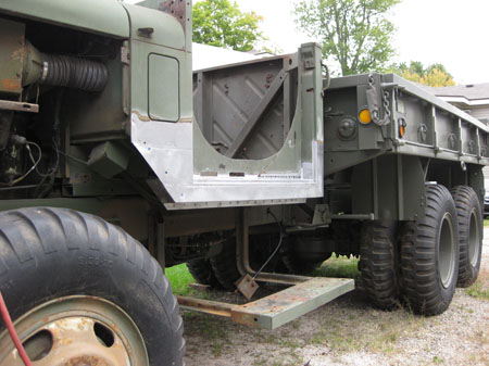

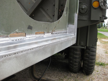

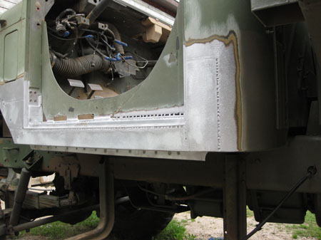

                  It's been a few days since I've made a post. I haven't made any project-related purchases since receiving the transaxle I mentioned in my last post. It's frustrating to have something so cool to work on and not be able to. Priorities suck! I have a (14k pound) monkey to get off my back before I can start the build. - This is a little off topic but since it's keeping me from working on my LQ build, it's related indirectly........Well, not really. Since I'm thinking about my LQ build while working on it, I thought I might post some pics. (Does that make it officially off topic?) It's an M35A2C that I am prepping for sale. - It's one of those projects where one thing leads to another and, before you know it, you're a__ deep in alligators. After replacing inner and outer rockers on both sides, I am starting to see the light of day.

                    That thing is a beast! You could use that for one heck of a car hauler to the track
