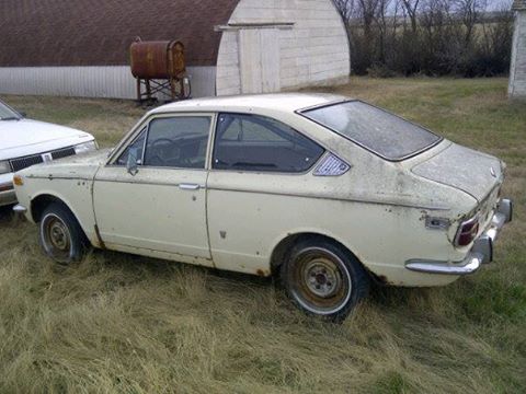

    1970 2.8 Toyota Corolla from Saskatchewan Canada
    New to the 60DegreeV6 thing. I have a 1970 KE17 Toyota Corolla I bought over a decade ago and I finally picked it up last year....engine is toasted.....was talking to a buddy and I bought a 91 2.8 with a 5 spd with a new clutch from a S10 for $225. I am planning on shoehorning it into the Corolla. I also have an Eaton M90 that needs a new home too, planning on switching the 2.8 to a carb too.
    I have a few questions,
    I neglected to measure the physical length of the 2.8 from fan to back of the head and won't be picking it up for a couple o weeks, what is the length?
    I also have a 95 3.1, was contemplating on putting the aluminum heads on the 2.8 but upon my lackluster research I found my static compression would be too high for a blower......what are your opinions?
    Is there currently an easily sourced cam for a supercharged application or am I going to have to get a custom grind done?
    Thanks in advance!

          Yes with a 2.8 and a T5 it will weigh around 1725lbs and I plan on major weight reduction. I think if I get the 2.8 in the car and running this summer I will be happy, will start with a nasty cam swap, plain the heads to bump compression to 9.5:1 and make a tunnel ram intake....ANYONE sell intake flanges?
