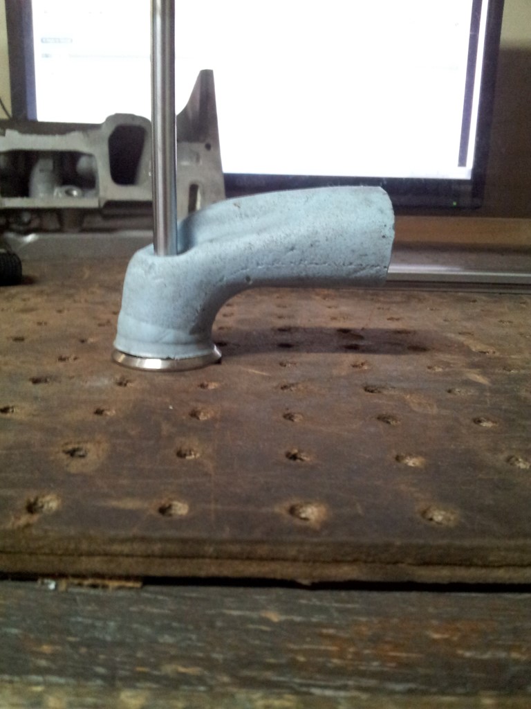

        3500 looks like it approaches it at an upward angle.
          • 13467
          It doesnt.
            You aren't going to gain anything by angling the port shape in the direction of flow for a manifold. Just clean it up and polish the crap out of it.
            Headers man... manifolds suck.

                    • 13467
Name:	20140625_122654 (Medium).jpg
                    WOT-Tech port mold of the 3500 exhaust.

                      Untouched port correct?
                        • 13467
                        Correct.
