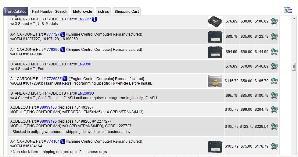

                              went to rockauto, now i'm confused....
                              take a look at all the different PCM/ECMs were used for a 93 3.1 lumina...
                              i see the 1227727(used in a lot of stuff), 16149396(the 91-93 DF PCM), 16172693(the flash PCM) and 16184164(which apparently was a 93 3.1 only PCM). the rest were just rehashes of the same PCM i think, with different part numbers.

                                #75
                                I'm reading 777727 on your attachment, not the 1227727.
                                You say the 16184164 has a PROM? Are the harness connectors the same?
