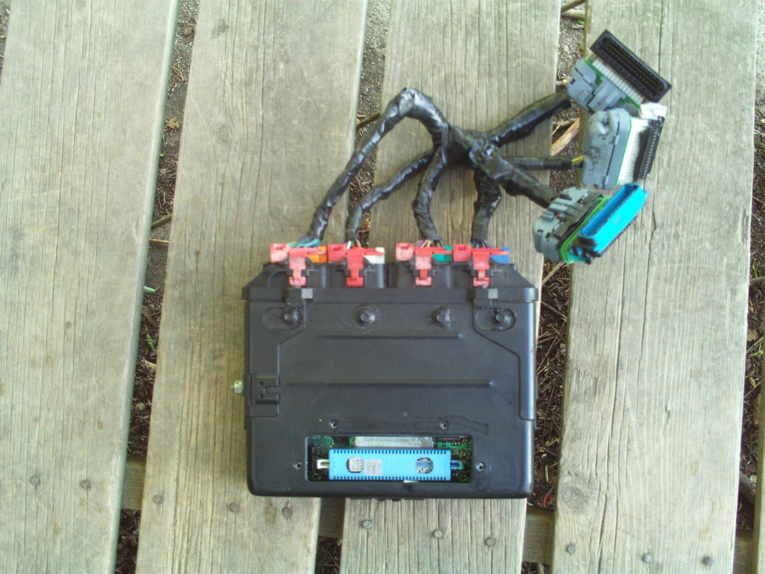

                        and this is why you're supposed to measure twice and cut once...
                        but it works, so i don't care
                        so long as nobody asks me why i ripped a leg off of a giant tarantula and have it connected to my PCM, i don't care that it looks funny.
                        i also need to see if i can get the "new" pcm to lock into the retainer for the "old" one, or else i'm going to have to fab a bracket or go to the yard to try and get one...

                              Yeah I was going to ask if the new PCM is bigger/smaller than the OBD1.5 one?
                              What wire did you have to mess with for the 5v reference for MAP/TPS? I take it if we use your guide we will be fine.
                              EDIT: Maybe you could do a core for the 1.5 ECMs? That would work if when the user got the adapter that a preloaded tune was on there that would run their car OK if it was their DD. I wonder how the trans shifting tables will work with your trans, as it might cause issues if it does go by MPH with the different FDR of the 3100 4t60-E's compared to LQ1's. Mine is 2.94 and the LQ1 is way higher ratio than that.
                                #60
                                the 1.5 is about 1/2 inch wider, 3/4 inch taller, and maybe 3/8 inch longer(looking from the top with the plugs facing towards you)
                                and i really don't remember what i did, but its in the guide...
