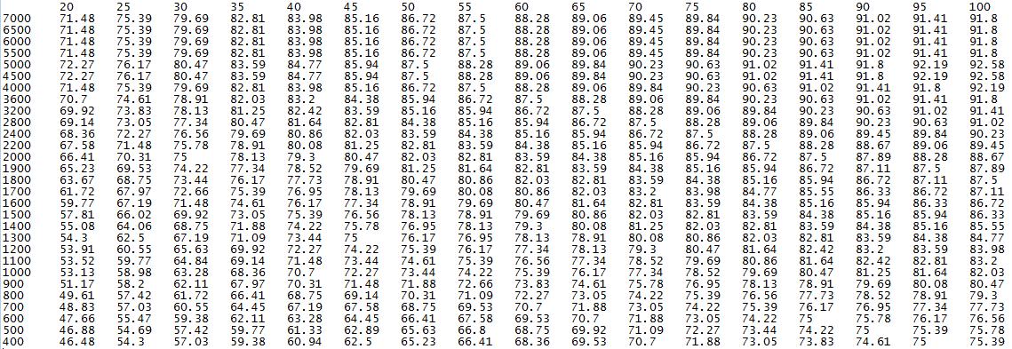

                            i don't know what codemask the 95 is, but DA2/DA3 whichever it is for the earlier LT1s...... the fuel table is ridiculous, can't remember spark at the moment.
                            i'm not sure of the exact application, but here's one.
                            i would have to say its probably the most detailed OBD1 PCM ever. code59 might be close though.
