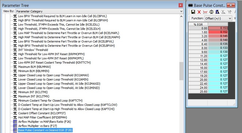

              ah you mean the table Base Pulse Constant vs Desired EGR (F28 ) ?

                Why EGR? EGR sounds in this combination very confusing. Does it play a role if I already deleted the EGR?
                ...cruising around...
                92 Chevrolet Beretta GT V6 3.1 MFPI auto 30K white
                  • 13531
                  its a base pulse constant vs EGR%. If you delete the EGR, then use the 0% (top) number only. Im not sure what the table label is.

                      I've found it! See picture below.
                      Sappy, you've said that BPC vs EGR is the MAIN one for fuel constant. Does this imply other secondary parameters I need to change?

                        • 13531
                        SImply put, thats it. If you want to tweak something else, offset vs battery voltage would be the next one that comes to mind.
