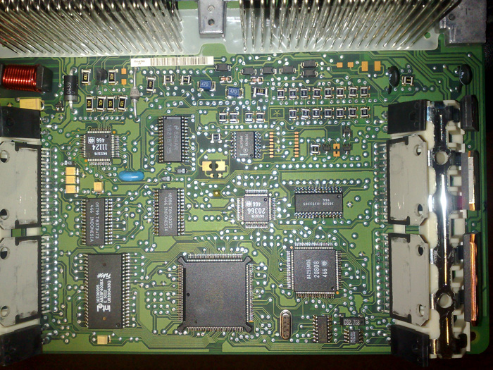

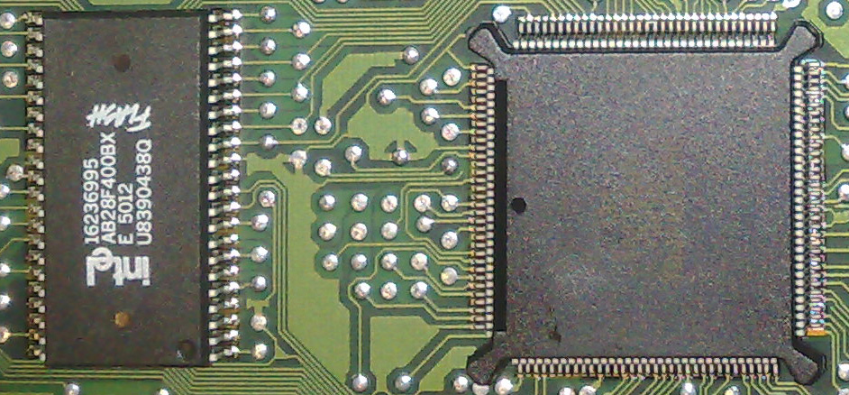

                        Well I opened up 2 Pcms last night
                        This is what I found
                        Flash Chips
                        2001 Impala 3400
                        Code:
                        Intel
                        16236995
                        AB28F400BX
                        E5012
                        U8390438Q
                        1999 Chev Venture 3400
                        Code:
                        Intel
                        16236995
                        AB28F400BX
                        H3311
                        U0490294Y
                        Not sure of the differences between the Two besides last to lines, but def same family (maybe build code dates etc?)
                        It seems MANY MANY GM Pcms use this chip (even back to 96 4.3l in trucks I have seen)
                        Searching for Data on this chip, I come up to referrences to
                        AB28F400BX with a T90 or B90 at the end? not sure what that would be?
                        Also have found
                        http://pdf1.alldatasheet.com/datashe...400BX-B90.html
                        which seems to reference both B and T
                        Here is the image of the 99 Venture

                          planethax: i'm not surprised that GM uses the same FLASH chips over and over, since it costs money to re-engineer for different chips. the CPU is likely identical as well.
