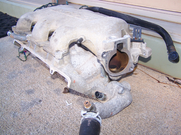

    i have: 1995 olds ciera with 3100.
    swapping in 01 3100 UIM & LIM

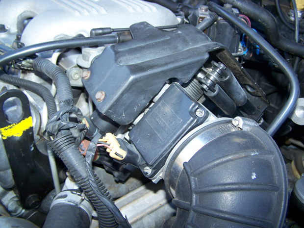

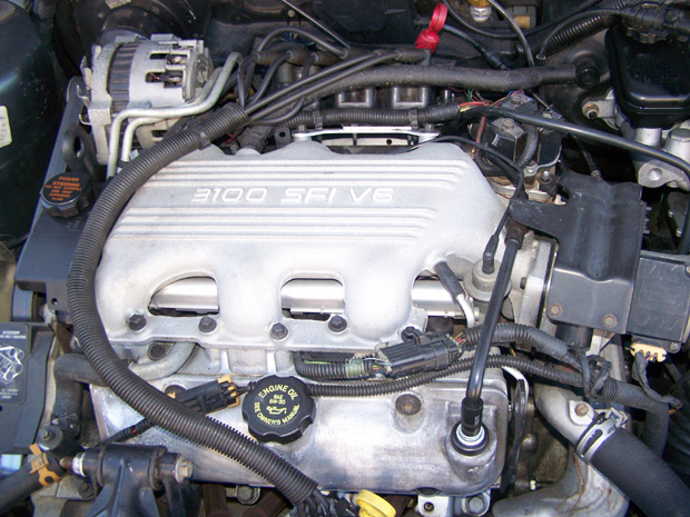

                        the new and the old
                        i thought 96+ had the separate MAF & TB?

                          Yes. All 3100/3400 but the A bodies (yours) had seperate TB and MAFs. And they didn't use a MAF until 96. But still used the same TB.
                          Looks like you might have to possibly splice on a pigtail for the 96 MAF if the connector is different. You will need the normal 3x00 TB, and also the TB linkage bracket. And it looks like your TB linkage comes from the side ?? Can't see clearly there. So possibly you may even need to get some throttle cables from a 94-98 N body, or 94-96 L body /etc whatever is closest to the size of your car.... I think those are pretty close??? That is if your throttle cables are not long enough which I think will be the case with the normal 3x00 style linkage bracket.

                            my linkage does come from the side...
                            is there not an adapter for this type of tb & linkage to the large port manifolds?

                              You have that weird setup I was thinking about. Although it is a little restrictive (it has a built in MAF), it WILL bolt up to your new intake manifold, so you can use it until we can figure out something better to use. We will need to figure out which car has the proper cables, and stuff, but until then you can use yours.
                              This is the EGR adapter you will need if you keep your stock PCM:
                              http://60degreev6.com/store/index.ph...d&productId=75
                              You have a throttle body setup that was similar to the buick engines (3300 and 3800), so not only will you need new throttle cables, you will also need the cruise control cable as well.
