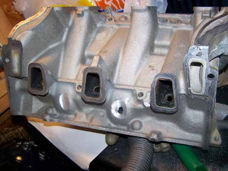

                    aight yall i did exactly what iwas warned to be careful of... I ground a hole in one of the runners on the LIM. Now how do i fix it????

                      #40
                      Replace it.

                        #41
                        I was just gonna reply in this thread last night and see if you were making progress.
                        Ouch that sucks. Do you know anyone that can weld aluminum? LOL
                        I don't know if this would work or hold up, but might be worth looking into.
                        Not sure if that would work on cast aluminum or not..
                        • 3100 MPFI
                          • 1522
                          #42
                          can you get a pic of the hole?
                          Taylor
                          1998 Lincoln Mark VIII
                            • 13531
                            #43
                            durafix is a bitch with a manifold. You have to heat it up a lot and its not easy. I bought the stuff and its never been used properly

                                #45
                                well, here it is . I got a cousin who builds racing engine who told me to use aluma weld with a blowtorch to mend it. i bought some engine block putty from the parts store...
