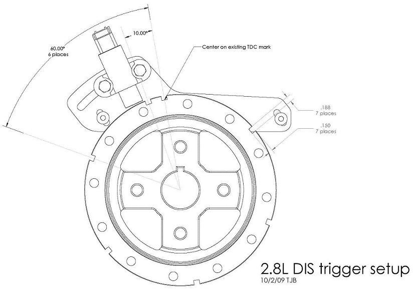

      I am having second thoughts about using the Fiero dampener and timing cover. The original reason for using these was to be able to reuse the alternator, belt system, and possibly the compressor. By notching the dampener I could eliminate the need for using the WOT-Tech external crank trigger. The problem is I'm having a difficult time figuring out where TDC#1 is on the Fiero dampener. There is a thread on Pennocks Forum that discusses modification of the dampener, but the picture shows TDC#1 aligned with the keyway( see attached pic ). My dampener does not show this alignment. I haven't removed the dampener from the the 3500, so I don't know what the relationship to the blue dot on the face of the dampener is to the keyway. I have searched the web trying to find information related to the marks on the Fiero dampener. There are 3 marks spaced 120 degrees apart from each other. One of them has to be related to TDC#1. From the attached picture, I would have to assume the dampener I have is not a Fiero dampener as the closes mark to the keyway is located around 335 degrees.

        I could have shown I located the marked in relation to the keyway when I did it, but I guess not. That drawing is slightly different than mine as well...

          Brad,
          One of the marks on my dampener aligns with your drawing: 1 and 4 TDC with the keyway being ~45 degrees. Was this setup used on a 3100 or 3400?
          Michael
            • 9186
            #35
            I did it off of a 3100, but all cranks with an internal reluctor should be the same.

              It would seem to me that using your diagram to modify my Fiero dampener would get me where I need to be on my build. Do you have any thoughts on this? I'm pretty sure the Fiero 2.8 did not have a reluctor wheel.
                • 9186
                #37
                I don't see why not, although I'm not sure I like the idea of notching a dampener...

                                #45
