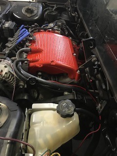

                              Well, I'm back, sorta. I was locked out of my account because my original email account was lost. Reregistered as flimbob56. My swap has transformed from LX9/4T60 into LX9/GETRAG. Computer/tune is now from a 98 venture(OBD2). Currently in the tuning stage now and still working the bugs out.....

                                I can change your OG account password and email for you (i think). 98 venture is an interesting starting point for sure. Id have used an 01 or so grand am if I had to use OBD2. One of those years of N body has the most variables available to tune. Anyway, you can tune that but being a manual, you might need a DHP type tuner to edit anything that might help for the IAC follower. Hopefully not.
