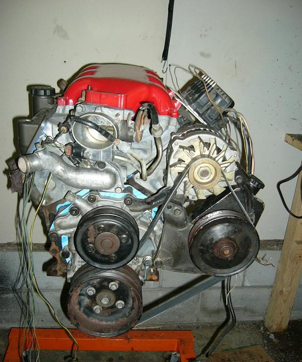

    Yeah Dave has the right idea there... Click image for larger version

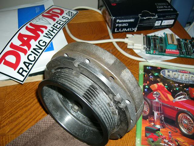

    I also welded the WOT trigger wheel to the back of a ASP underdrive pulley to fire the ign. coils... no accesory spacing required...Click image for larger version
      Evolving a little.. just need to order up the parts to make a good turnbuckle and find a belt that will fit. I added in an idler on the other side to help make better water pump contact.
      Once it's all finalized i'll cut out some flat plate and make the PS pump bracket solid, right now it's kind of nice to be able to move things around.
