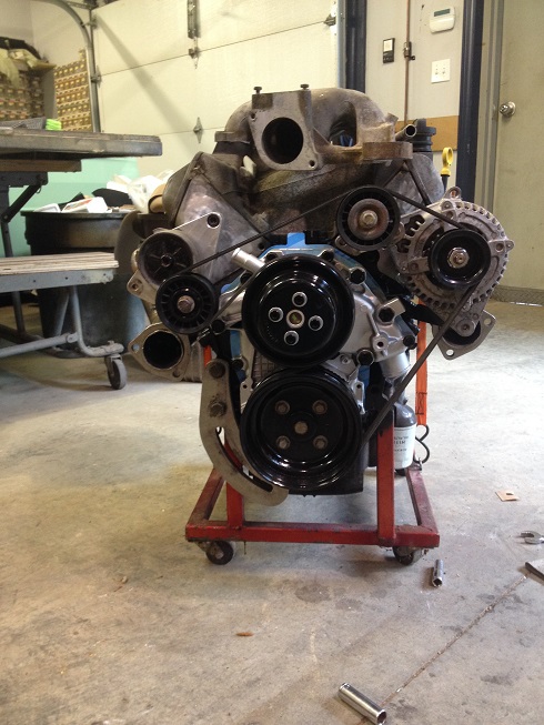

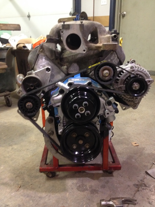

              What did you do for belt routing on this project you mentioned? I have an LX9 that I want to put in an Opel which also has manual steering, so the only accessory would be the alternator.
              I haven't got to that project yet, but it's getting closer to the top of the list.
              Well, I'm getting to that project.
              I have two different belt routing arrangements, depending on where I place the dowel for the tensioner (modified to be removable).
              This is how I believe I'm going to route the belt:
              This is the alternate:
              I had to use an idler, but could have either used a (much) larger pulley on the tensioner (or alternator) or moved the alternator up, or some combination of both. I already had the alternator mount welded up solid by then, so I chose to go with the idler pulley.

                I'd opt for the alternate. If you put the belt on the underside of the idler that is next to the alternator, does it clear the w-pump? If it doesn't, a smaller dia idler pulley is available that can create clearance.

                    There's no reason that the alternator has to go there, no, it just fit there very well, and keeps the entire package tight. The driver side head being the one that is father back allows the alternator to sit in that open space.
                    The idler is there to have the belt clear the water pump. If the belt cleared it without, there would be no idler. There's no belt clearance issues with how the belt is routed now, hence why it's routed the way it is. I've fabricated every mount so parts are placed where I want them to be.
                    I was only showing what I came up with since I was asked long ago how I did it, or would end up doing it previously in this thread.

                        It's simple, but lacks the spring loaded tensioner, which is a self imposed requirement.
                          I honestly just brain farted over the positioning of the left side pulley system lol.
                          Too bad the tensioner couldnt be rotated counterclockwise about 2.75" to make the idler history on the alternate design.
                          • Guest
                            #73
                            I know. There is no tension on the belt if I did that.
                            Raising the tensioner creates clearance issues with the heater hose. So these are the best two layouts possible, without re-working everything.
