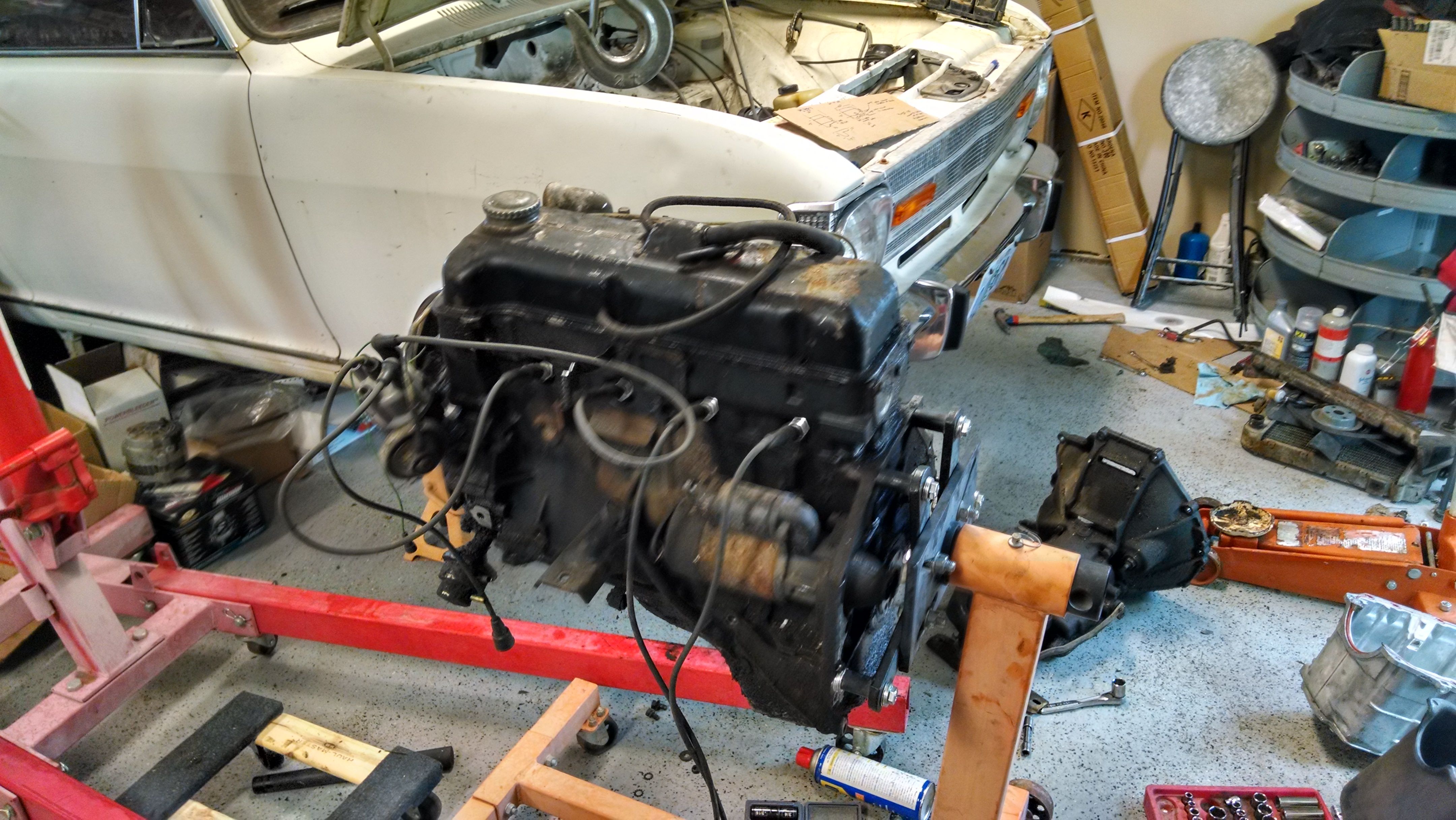

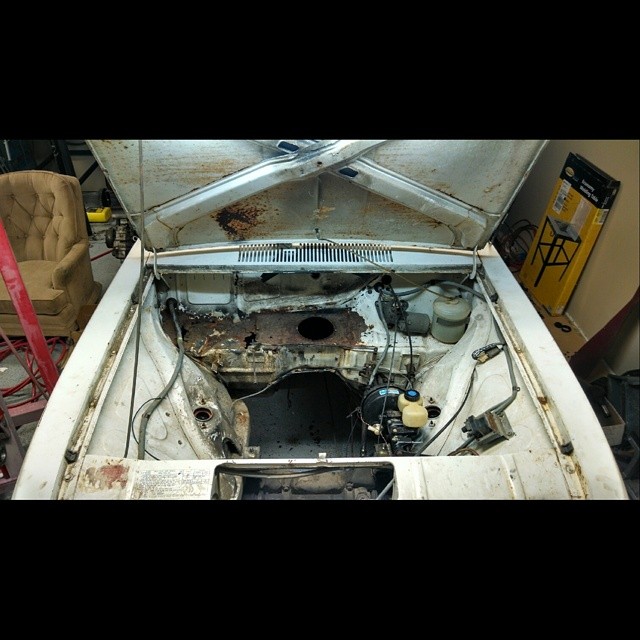

                                #60
                                Just got the 4-cyl and 4-speed out of my Opel. I was intending to replace the clutch, reseal the engine, and convert to EFI - but now I'm exploring the possibility of stuffing my LX9 and T5 in there instead. This wagon weighs 1900lbs.
