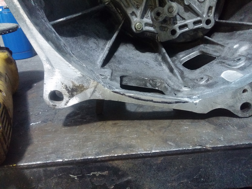

    The RWD 60 degree V6 starter pocket and the truck FS5R30A starter pockets almost exactly line up. However I am using the FWD 60 degree V6 starter location, which is on the other side of the engine.
    Sure go for it. I prefer the FS5R30A over the T5 any day, actually I prefer the 71B over the T5 as well, and had originally wanted to use that trans since it was already in my car, but the flywheel I needed for depth reasons ended up not fitting inside the 71B's bellhousing, so I had to move up my plans for the 5R30A install, at the time.
    You can get away with the use of an adpter plate, that's how my engine and trans are currently mated, but I would spend more time getting it right than I did, and add some dowel pins to the adapter plate. I'm just using the bolts to locate the trans. I was never entirely happy with how the adpater plate I made turned out and had wanted to build a new bellhousing from the start, but I just couldn't figure out a nice way to get everything mated and lined up. My original idea is very different from what I'm doing here and will re-visit that idea after I'm done this one and get it in the car.

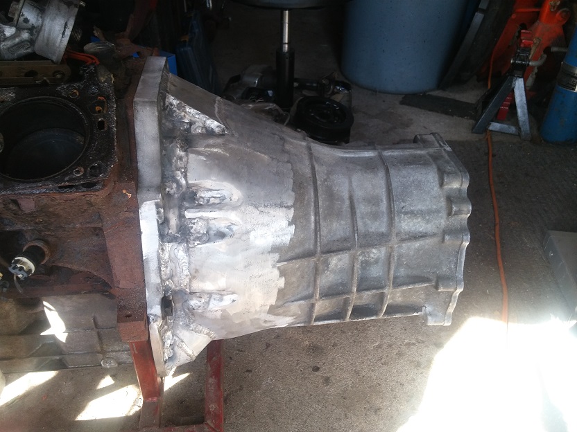

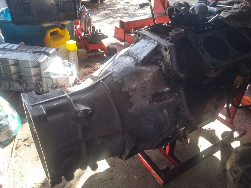

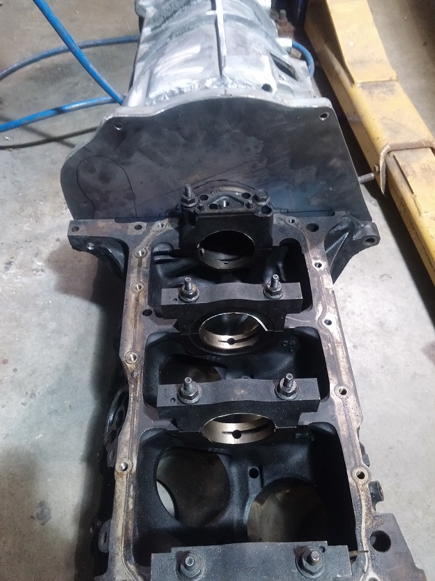

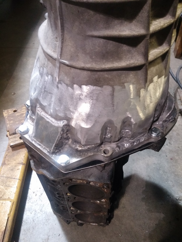

        Time for an update.
        I have finished modifying the bellhousing.
        I found when I went to test fit on a spare block that still had a crank installed and could attach a flywheel to that I needed to clearance the bellhousing opening a bit. I was hoping I could get away without doing so.
        A bit of grinding and it's all good.
        test fitting on a spare block:
        More test fitting:

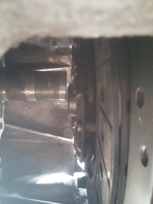

        Uh oh... That's a bit close between the clutch disc spline and the Throwout bearing support, which I was thinking might be an issue due to measuring after the welding was finished showed that I was about 2mm shorter than I would have liked.
        So to build a spacer... which is also the dust cover, in a very similar fashion to what Nissan did originally.

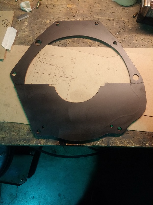

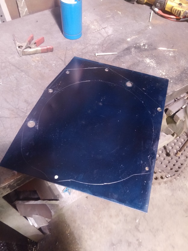

          Spacer.. the final frontier... or how I moved the world
          I had originally wanted to use 14 gauge, since this was JUST under 2mm thick. All I could find locally without waiting for it was 12 gauge, so I went with the 12, a little more space won't hurt anything here.
          Pattern laid out:

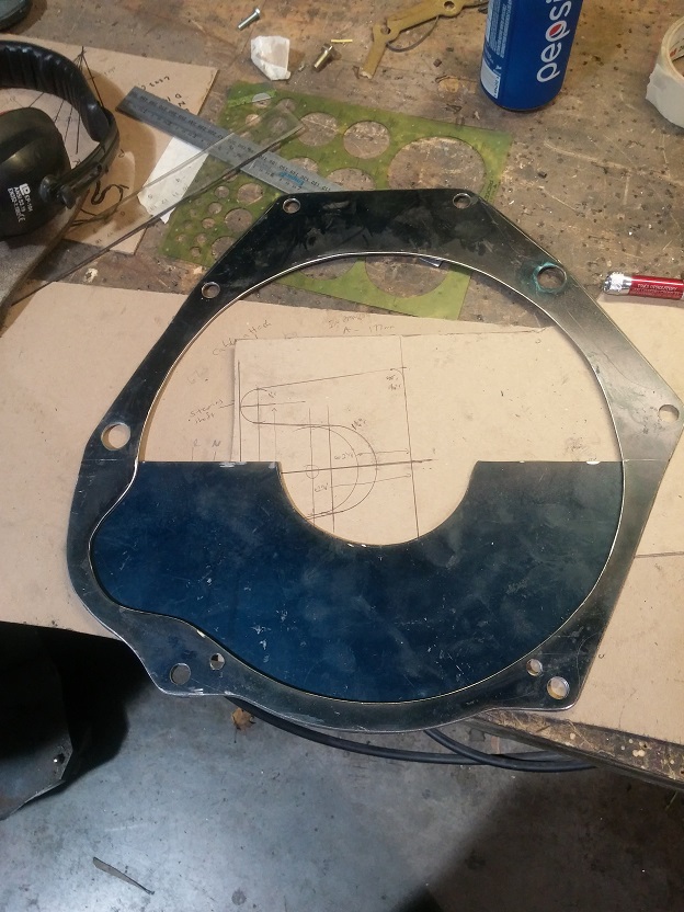

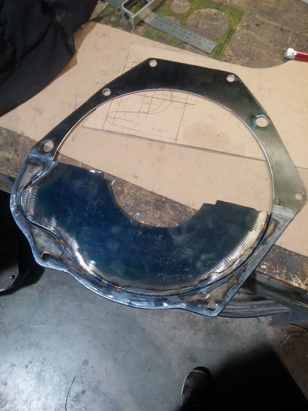

          Hmm, only 2mm between the flywheel and the spacer plate, looks like I need to open it up some.
          I cut out the entire diameter of the flywheel, actually a little larger, and then made a lower filler plate to act as a dust shield.

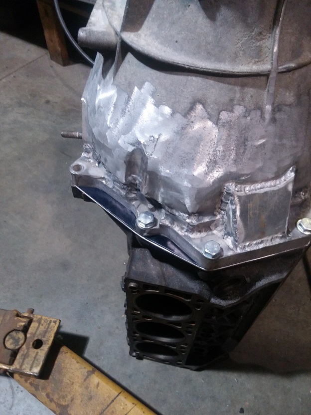

          All welded up, I welded the entire seams to hopefully keep any dirt and moisture out from between the plates.

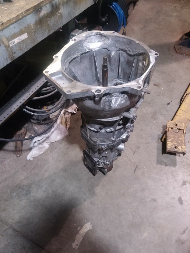

            More trans work.
            I have painted the spacer shim. The observant of you will have already noticed that there is no starter hole. I will add this when I actually swap the clutch in, so that I can get it pretty exact. I don't have a spare starter kicking around to use on a spare block for this right now.
            I then put the trans back together tonight... FINALLY. I've been wanting to get to this for over a week now, but with school and exams I just couldn't find the time. It's finally ready to install.
            On the bench still separated...
            Sliding the bellhousing onto the trans:
            Reconnected... still needed to add the front cover in this picture and a couple small parts to the exterior, but otherwise complete.
            Now just to find the time to actually get it into the car...
