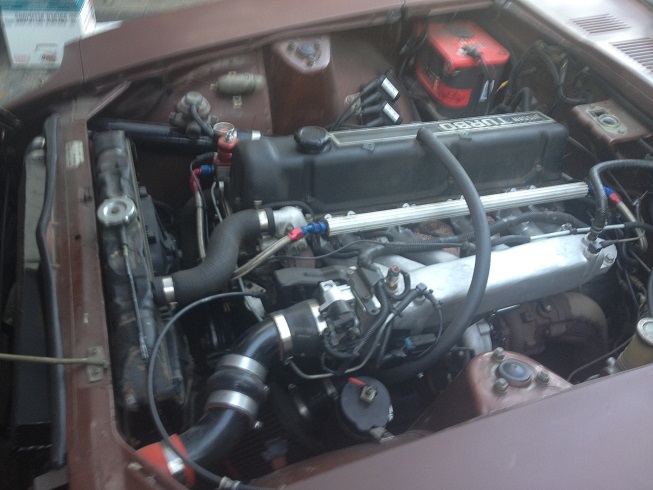

    I originally bought this car to swap an LX9 into, since I had the engine already. Instead I turbocharged the L28 that was in it when I got it. This was not the original engine to the car, but original type and fitment, kinda like going from a gen2 2.8 to a gen 2 3.1 in a Cavalier, or the 3.4 swap that is popular in the S-10 crowd. Same engine design, just larger displacement, though there were many head and block differences between the L24 and the L28, but that's not important to the story.
    So I BEAT the hell out of this L28, 17 to 20 PSIG daily. Yes, this car is basically my daily driver in the spring, summer and fall. I only planned to keep the turbo L28 in the car for a year or two, but that was like 6 years ago.
    This is the turbo L28, that served me well, and pushed the car to a 13.0 ET and many, many miles of smiles:

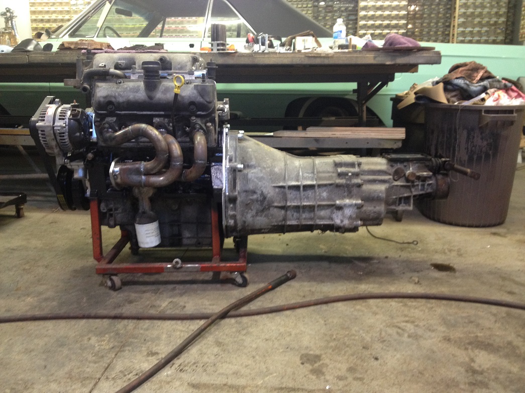

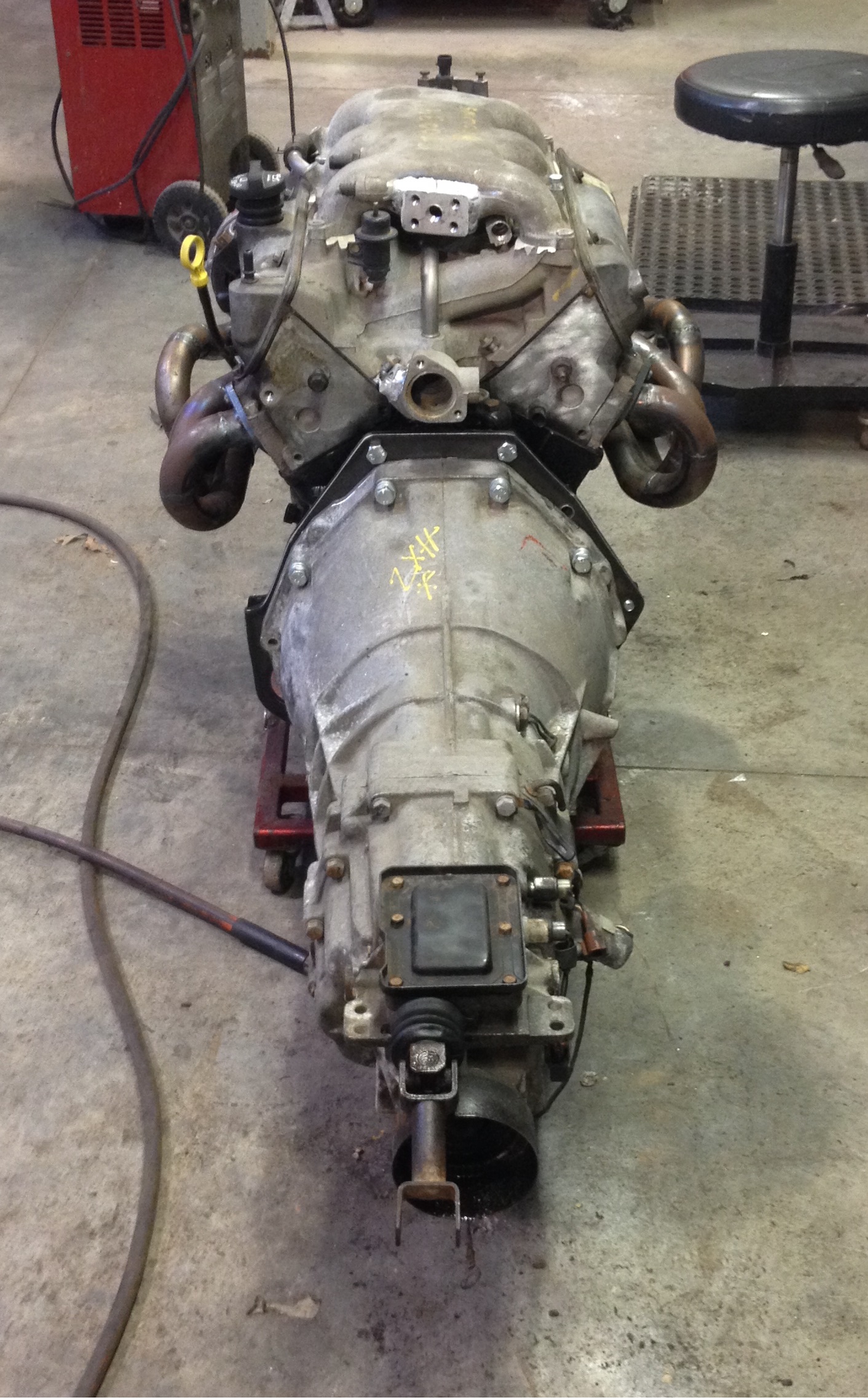

    Plan C, maybe D by now. I had waiting in the wings another trans that I had planned to swap in at a later date. I decided to explore the option to put it in now, even though I didn't have a clutch, shifter or driveshaft for it. Turned out that the bellhousing was large enough for the flywheel, the input shaft is IDENTICAL to the old transmission (Thank you Nissan for keeping some things the same!). Make a new adapter plate, for this different trans. It was Friday of the holidays before I got the engine and trans mated, so I decided it was too late to take the car apart.
    Engine and trans mated for the first time:

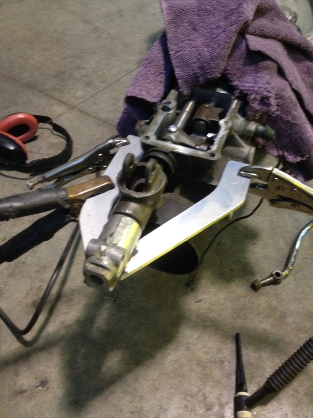

    Not complete, since it seems I don't have any pictures of it done, but you get the idea:

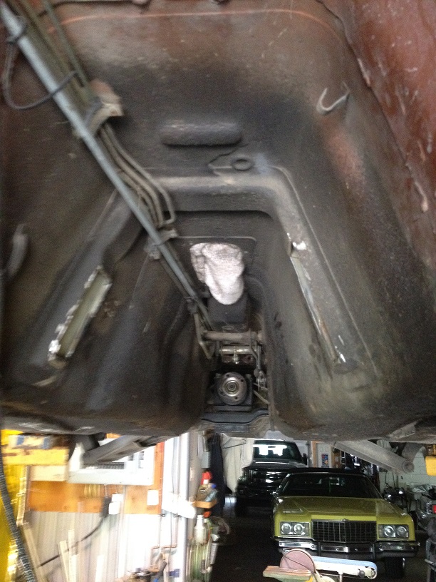

    So there is a civic holiday here in Canada, on the first weekend in August. It's not a mandatory holiday, so some places stay open, other places do not, luckily, we do not. So I decide that as of Friday of that weekend it would be go time for the swap. That's this past Friday, for those keeping track.
    The car comes apart pretty typically. I was trying to drop the entire driveline out the bottom of the car, but due to the engine sitting at quite an angle, this proved to be more difficult than it was worth, so out the engine crane comes and the engine and trans are removed through the top. I then remove the front crossmember, so that I could lower the car over the new engine and trans.
    I HAVE to see the new drivetrain sitting between the frame rails before I go home. Keep in mind I've already mocked up the LX9 in teh car a few years previously, when I pulled the L28 for some maintenance, so I know basically what it's going to look like, but I need to see the headers, and the belt system in there, I just have to.
    Oh yeah, I like it
    It looks great in there, and it looks like I will be able to push it back as far as I would like.

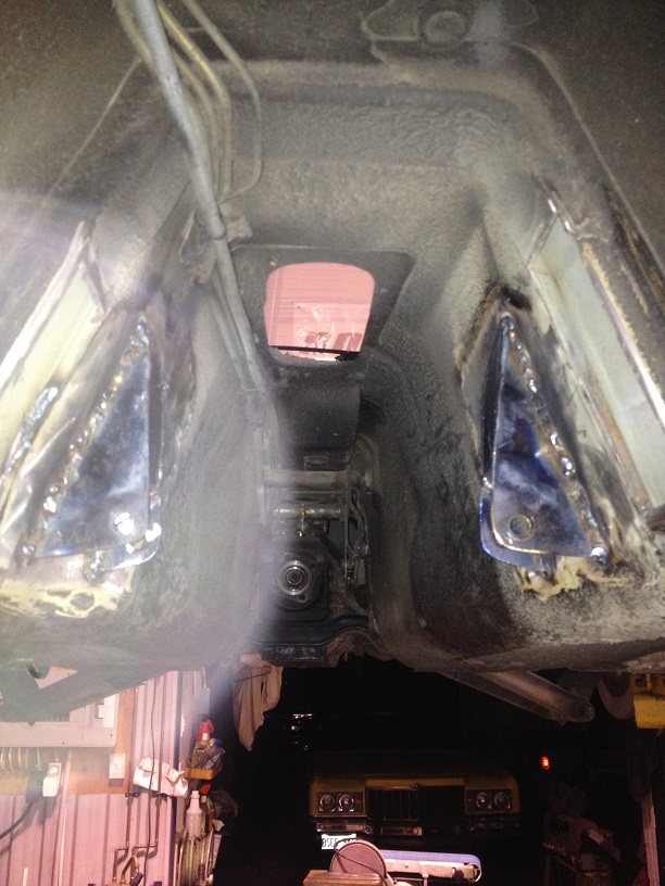

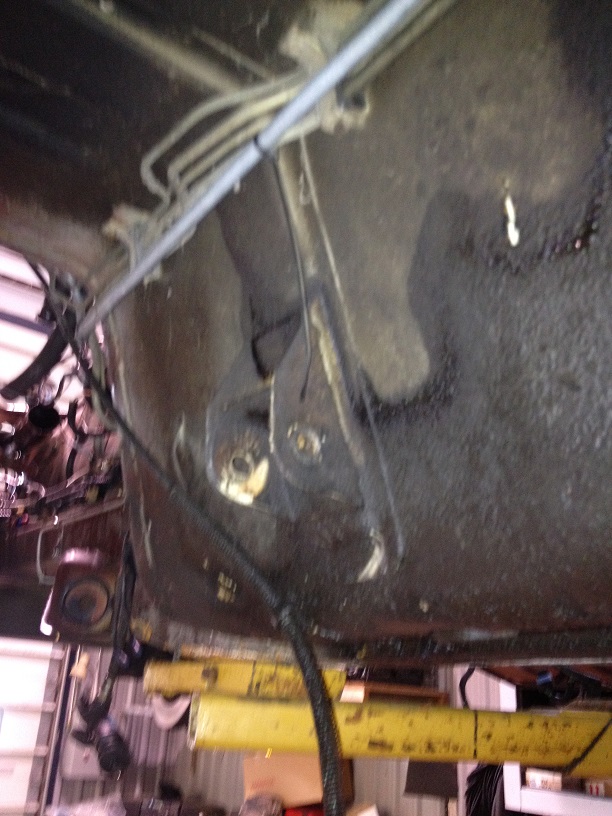

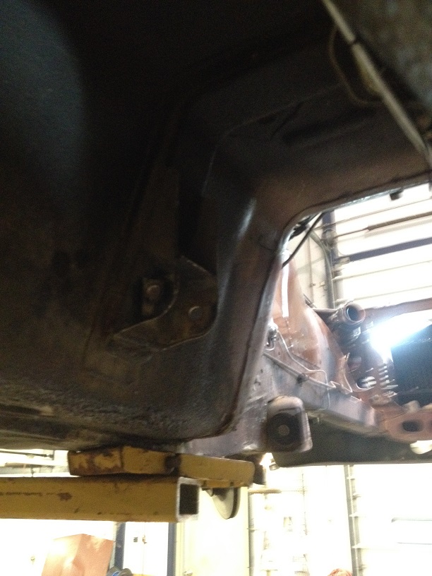

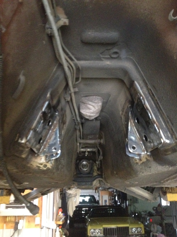

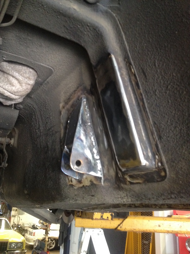

    After contemplating what I was going to do about the trans mounts over night, since I discovered that there is a physics issue with the transmission and the car itself, only one object can occupy the same space at a time. The trans is just freaking HUGE, compared to the old trans. I decided the night before to cut out the old mounts and make new, since I didn't really have a choice, and even trimming the old ones wouldn't have been enough. If I wanted to leave the engine and trans more forward I could have made it work, but that just wasn't an option to me.
    I get the grinder with a cutting disc out and start cutting away the driver side mount.
    Point of no return:

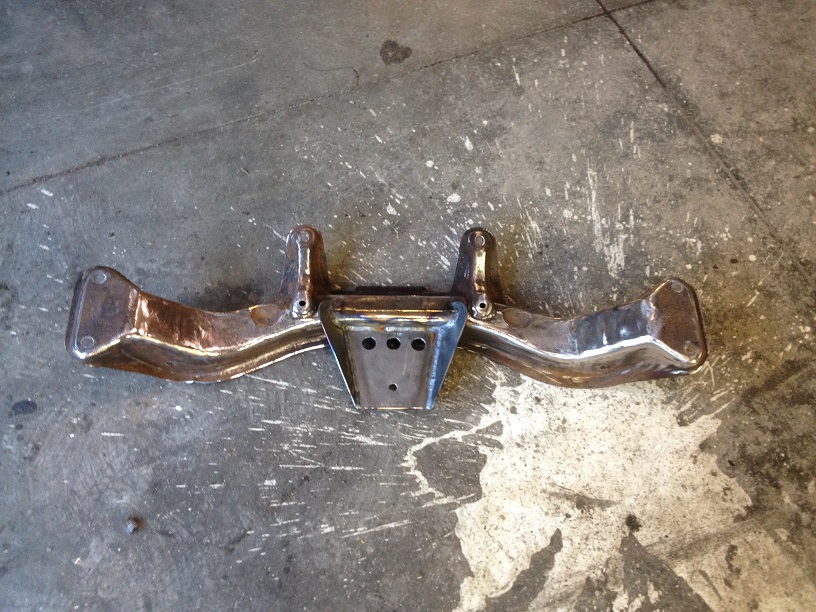

    I spent most of the day designing and fabricating the new mounts.
    Sunday, Bloody Sunday

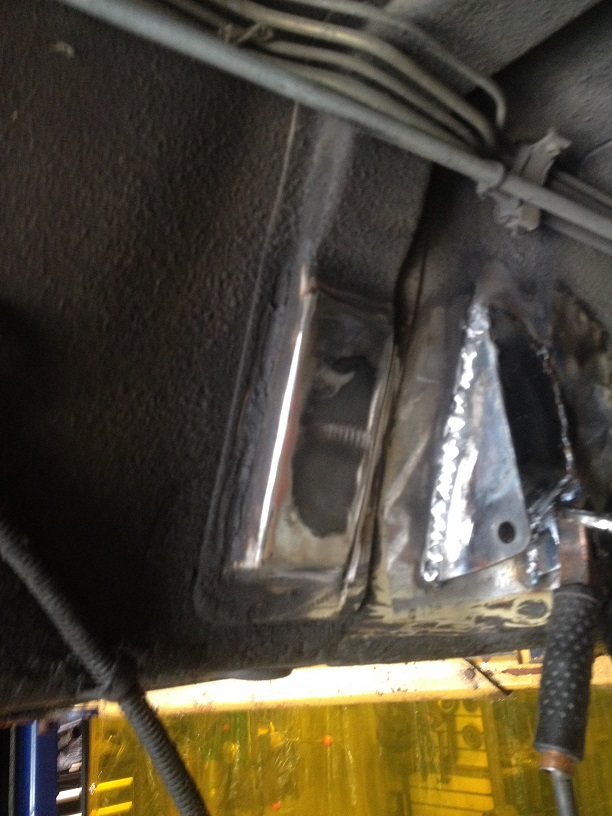

    I then moved onto boxing the old mount brace and then tying the new mounts to the old mount brace.

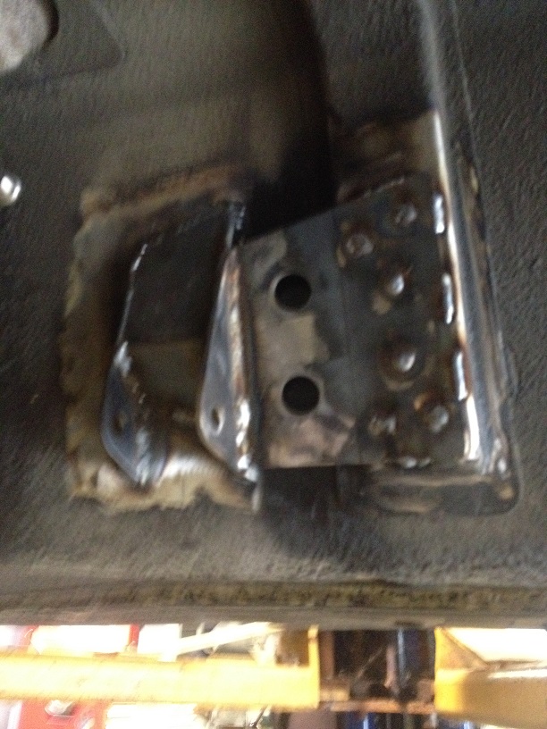

    New mounts tied to old mount brace:
    Notice that the right side tie in plate has a notch, yeah, that's to clear the VSS, and if I hadn't put that notch there, the trans would not have fit. It's THAT close to the brace. I'm contemplating notching that brace a little more to give a little more clearance, just for peace of mind.

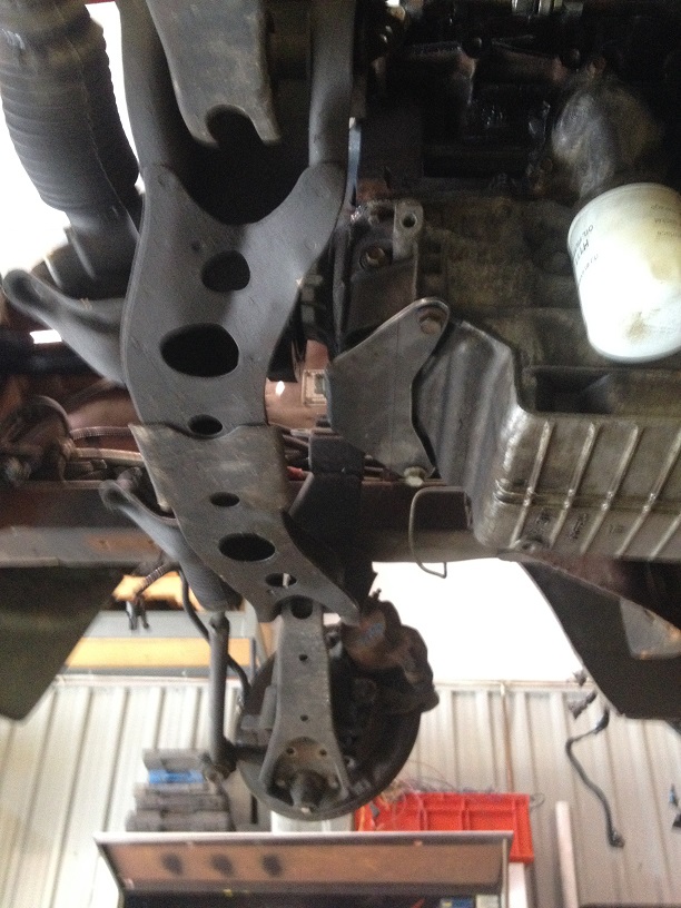

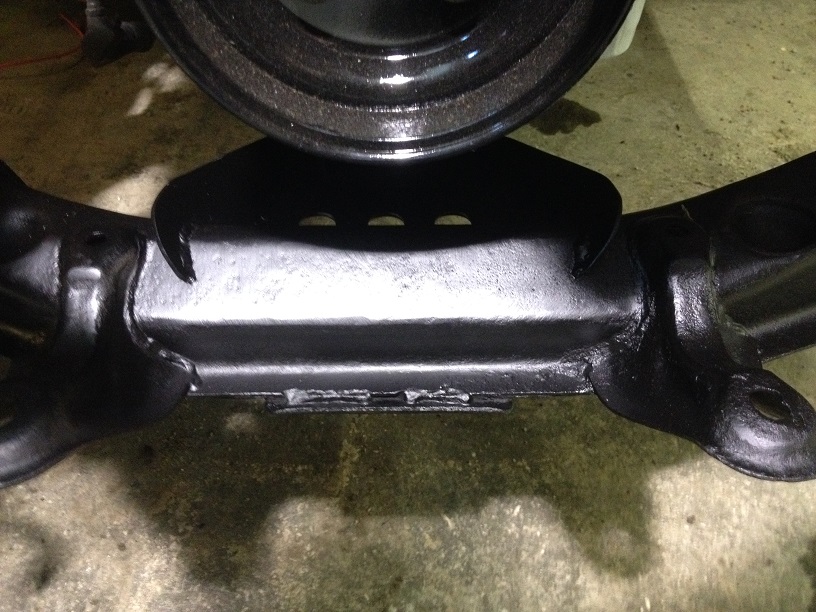

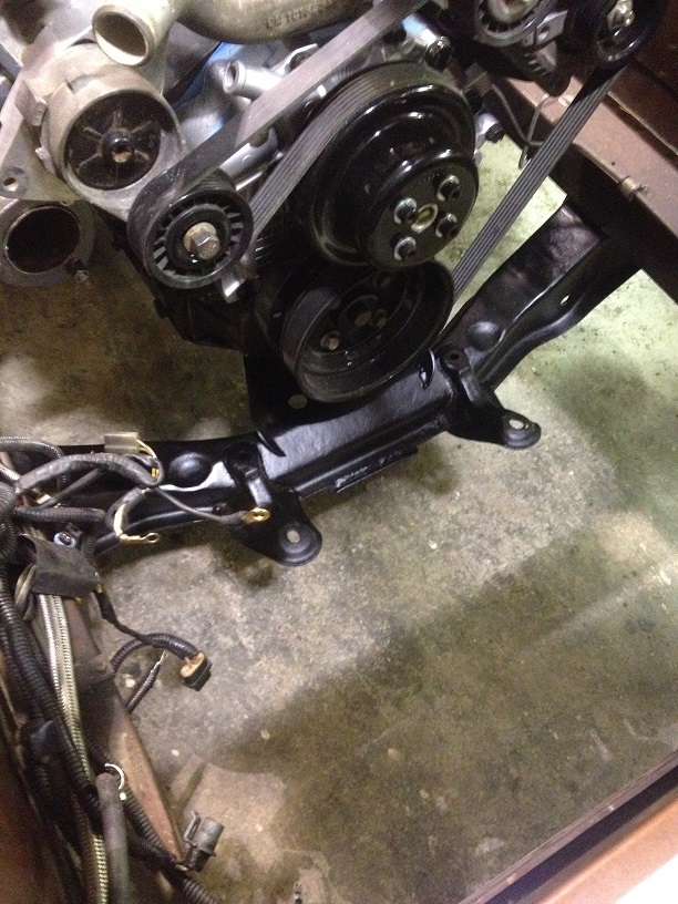

    Happy with how the trans mount has turned out, I move onto the front mount. Now here is where I break from conventional wisdom in a typical longitudinal layout. Most people would make some plates that attach to the side of the engine block and then tie them into the existing mount pads, or a new crossmember. Not me, nope, I'm going a different route.
    Go back to how the LX9 is mounted in a transverse application. There is a mount attached to the oil pan, just below the crank pulley. I like this idea because I can remove the mount pedestals from the crossmember and open that area up for other things.
    I had planned for this weeks ago and bought a universal Energy Suspension mount that looked like it should work. I had fabricated the plate that attaches to the oil pan a few weeks ago, in preparation. Now to finish it off and make something to attach it to the car...
    Some time later:

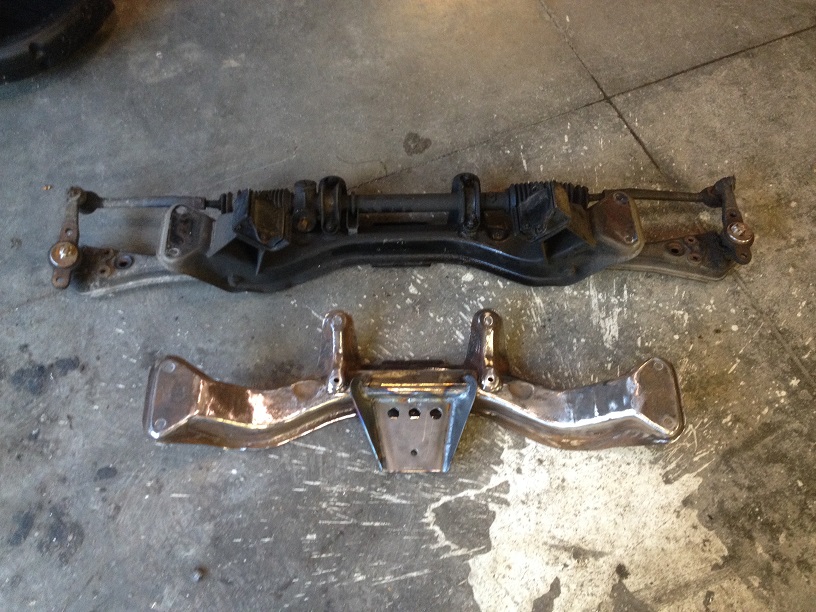

    Comparison of modified crossmember to original crossmember (With steering and lower A-arms still attached):
    And the engine supported by the car.

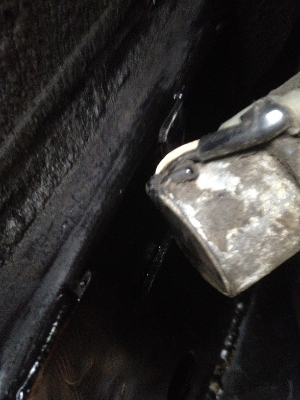

      Here's that Tight VSS clearance.

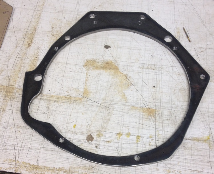

      Here is a picture of the engine to trans adapter I made, remember this is the second one, the first one will become wall art, to remind me to make proper measurements and calculations. lol

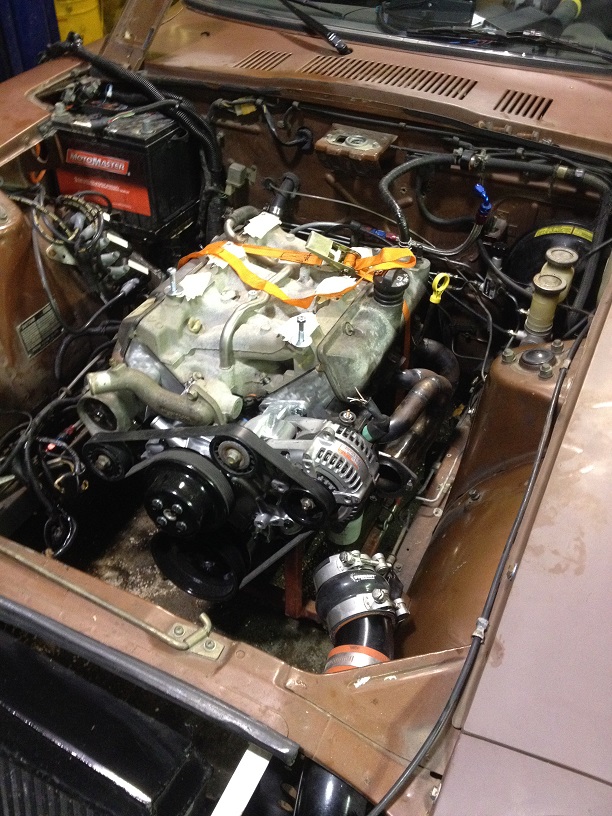

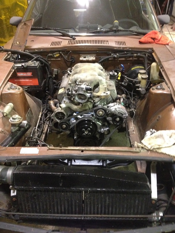

            I just realized there isn't a good picture of how it sits right now.
            I'm thrilled with how it fits so far.
            I'm using the LA1 upper intake because it's easier to get everything to work, than it would be with the LX9 upper intake. I also prefer the LA1 upper for looks. I don't think I'll really be taking that much of a hit in performance either. If I do, it wouldn't take long to swap the LX9 upper onto the engine, once I made a few modifications.

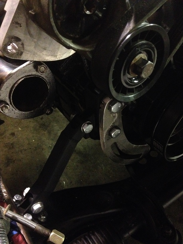

                        Are you going to add a torque strut to the top of the engine?
                        I made the torque strut today, actually I made two of them. I didn't like the first one, or more accurately the anchor point wasn't as strong as it initially seemed. :/ So I used part of what I already made and moved it lower. The strut I have now is actually pretty low on the engine. It works, but I'll likely do something different, I'm not totally happy with it. I'll post some pictures tomorrow (later today) of the struts, when I have a bit more time to do so.

                            • Guest
                              Some updates and detail stuff.

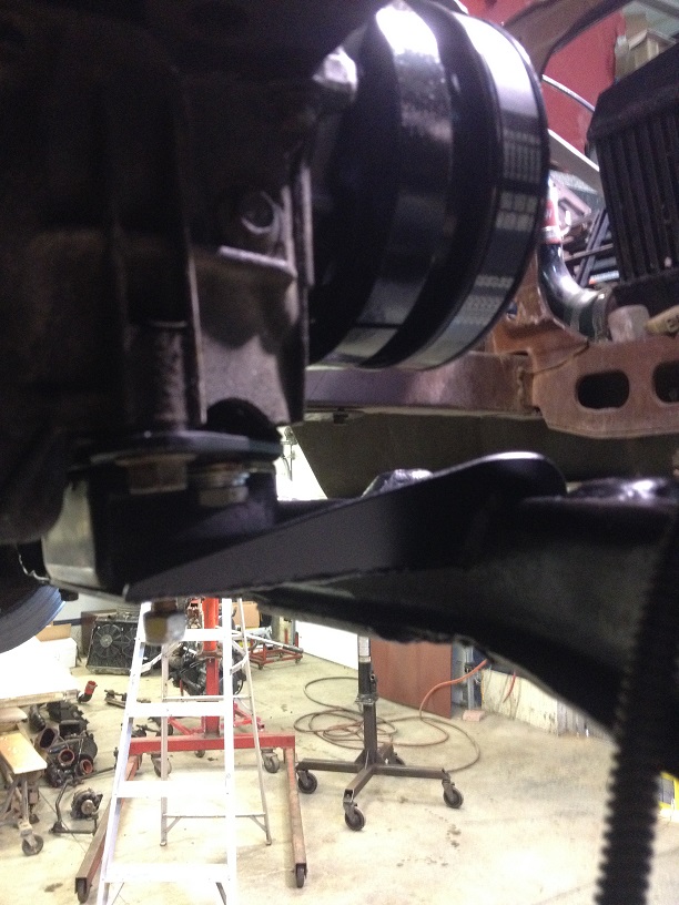

                              Front mount:
                              First attempt at a stabilizing strut, it didn't work out as well as I would have liked, the strut tower flexed FAR too much, so I had to change it.

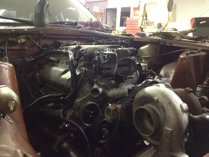

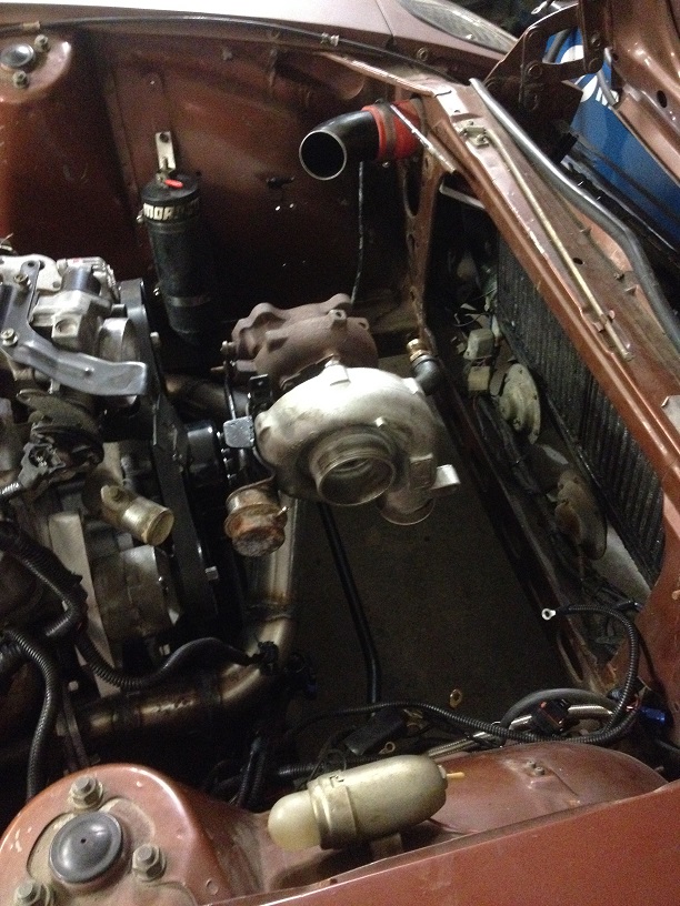

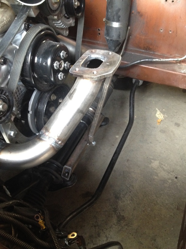

                              Y-pipe constructed, and turbo located:

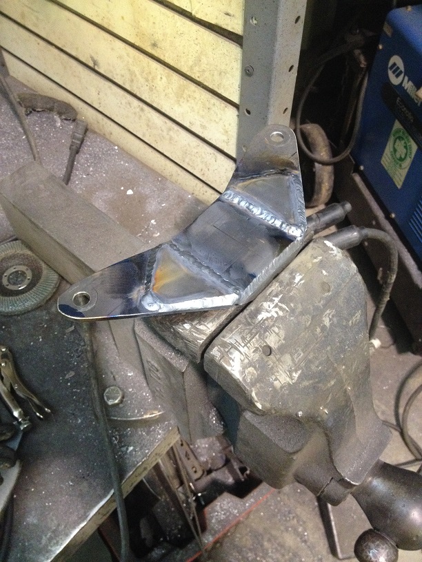

                              Support bracket for the turbo:

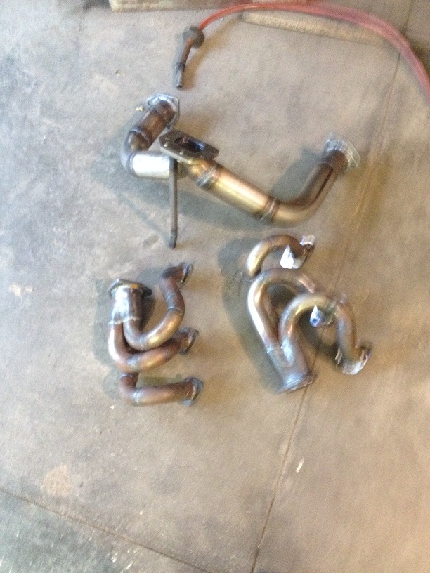

                              Headers and Y-pipe done (almost, another detail to add to the Y-pipe, before it's completed).
