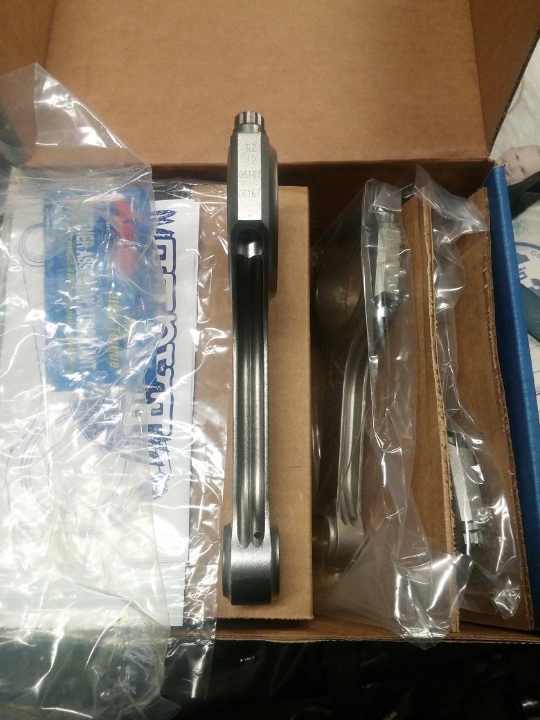

    Well, I got 6 new parts for my build tonight.
    Eagle H-beam, rated to handle up to 1500 HP, I don't think I'll be testing that limit. LOL
    These and a set from one other manufacturer were about the only off the shelf rods that are VERY close to being a direct replacement for stock rods. These are slightly longer. I'll have to look up the difference again. The wrist pin is also .005" smaller than the stock LX9 wrist pin, but since I'm getting custom pistons anyway, not a big deal, the pistons will just be ordered for the correct pin size.

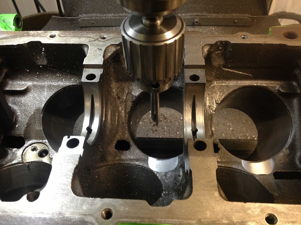

            Anyway, I have some pictures of something I've wanted to do back when I had 3400s to play with. That thing is oil squirters on all 6 pistons in 660s that didn't have them. well since I have that junk LX9 block, I dropped it off to a machine shop friend to see just how feasible it is to add more oil squirters to the LX9, and would imagine the LA1 block to very similar, if not the same in this regard.
            Initial flattening of the areas to be machined for the additional squirters:

            The center position looks good.

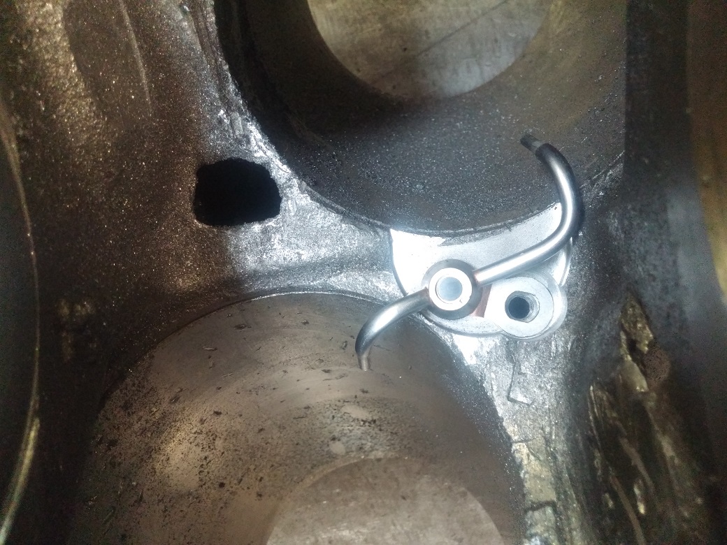

            Squirter fitted:

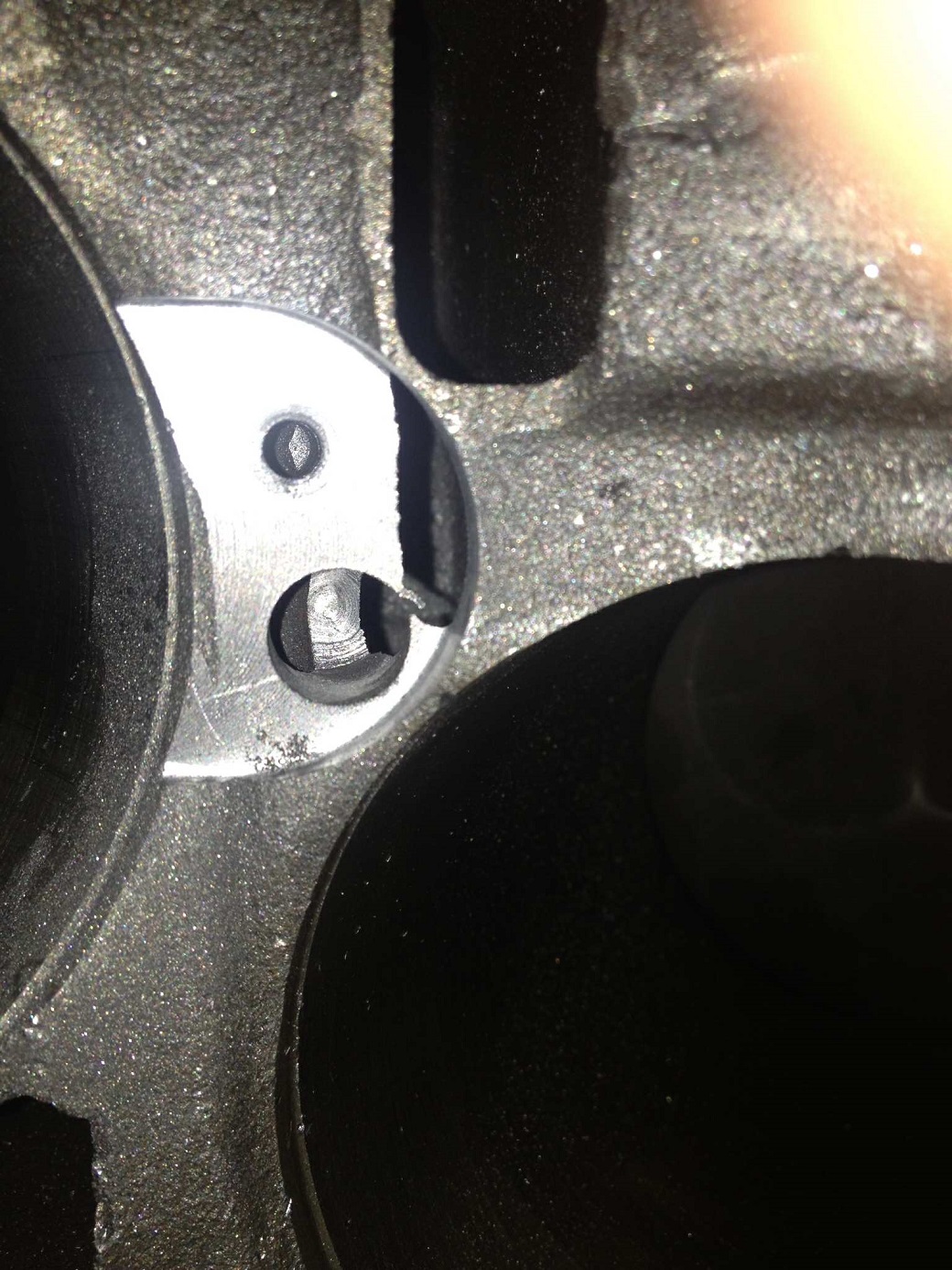

            But lets look a little closer at that front one:
            Damn, the position broke through the side of the oil galley, so mimicking the stock layout (which is also very similar to the LZ9 position) isn't going to work. The LZ9 looks to have more material in this location to avoid this happening. The squiters are offset from the centerline of the oil galley about .300"
            The machinist will do a couple more drill tests with a couple other positions that we discussed to see what will be best and clear the crank throws, etc. Any of the positions that would be used for the front oil squirter will need the tubes tweaked to get them pointed at the pistons.

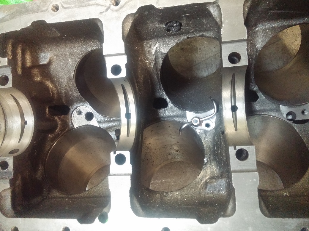

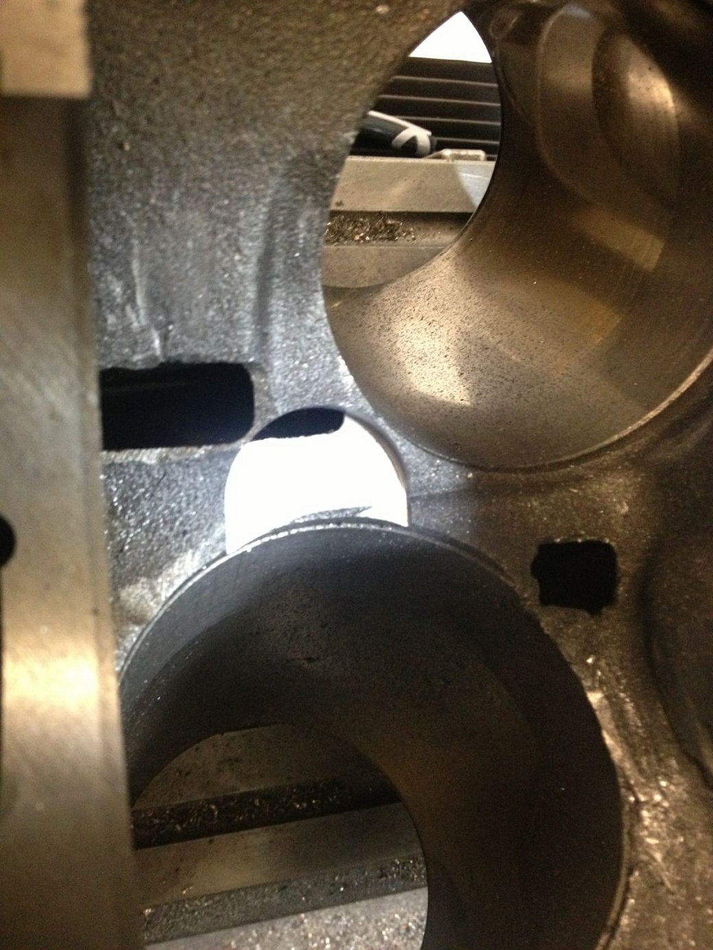

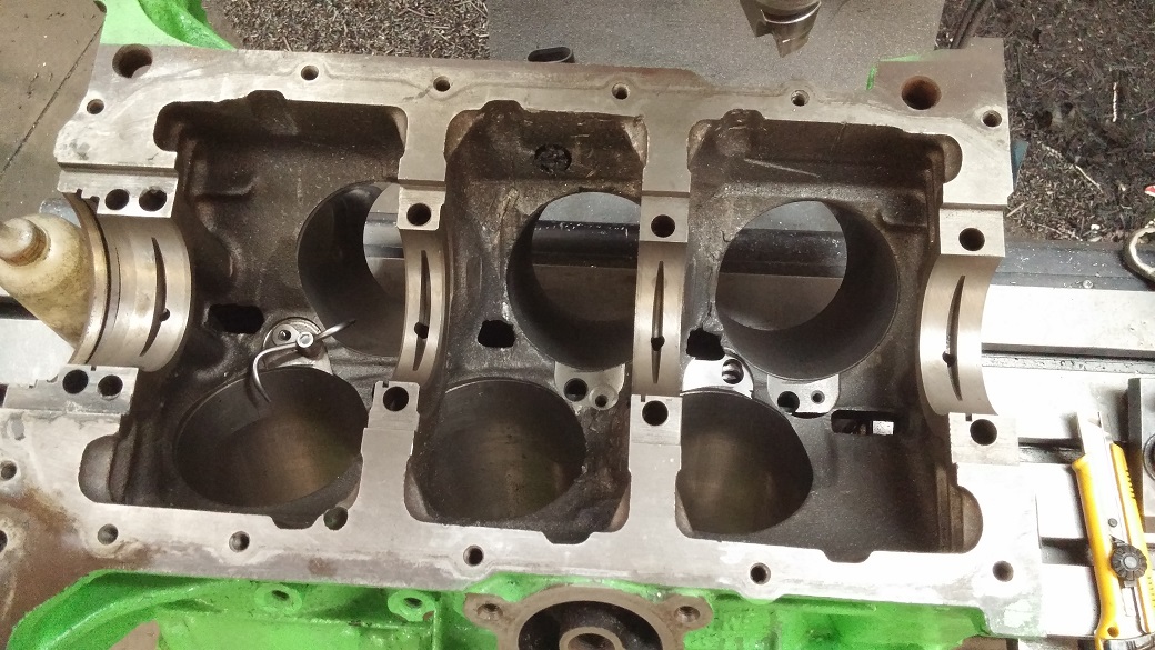

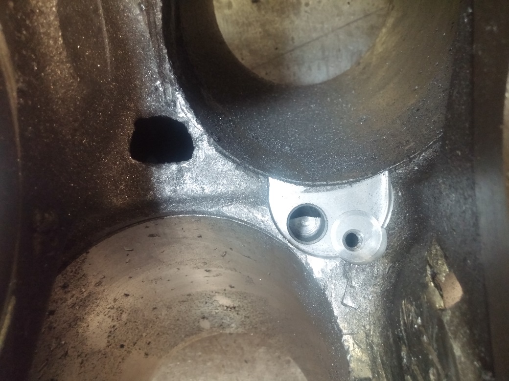

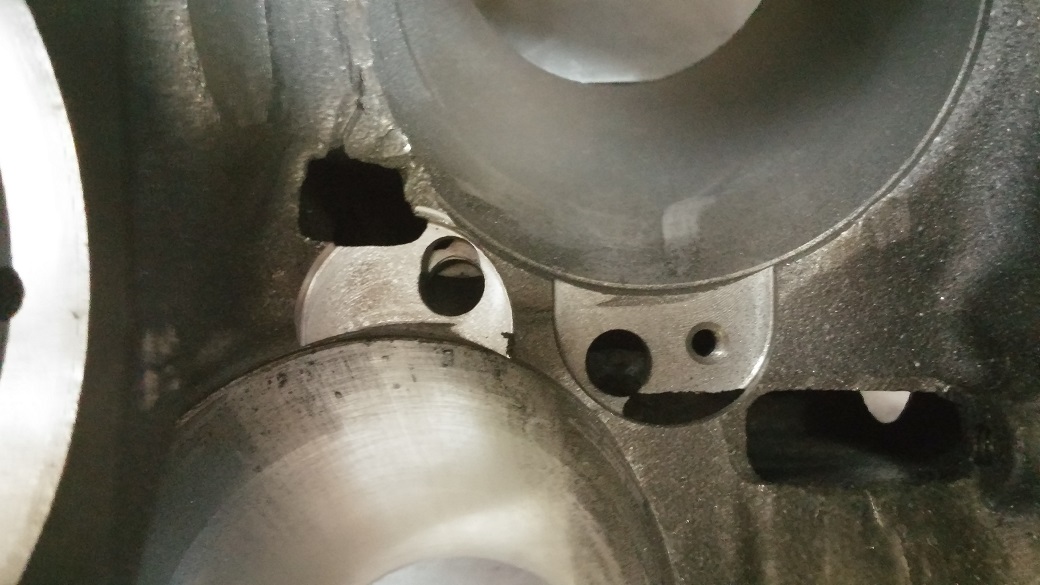

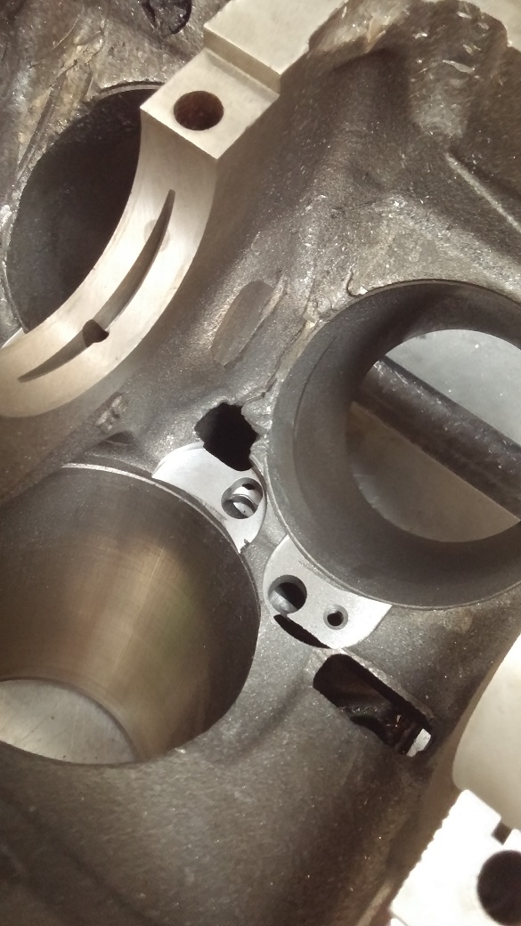

                One thing that I wanted to do with the LX9, which really started years ago when I wanted to do this with an LA1 was to add oil squirters to all of the cylinders. The LX9 has them on cylinders #5 and #6, but not the rest. So I contacted my machine shop guy, the same one who made the trans alignment pin for me, as shown earlier in this thread about doing this. With the blown up LX9 from December, I dropped that block off for some exploratory surgery. We started with the same locations as would be seen in an LZx engine, which worked perfect for the #3 and #4 cylinders, but not so well for #1 and #2. The blocks are quite different in this area between the LX9 and LZx engine for that front oil squirter. We came up with an alternate location and it looks like it's going to work, so I will be dropping a good block off to him next week.
                You can see the middle oil squirter location, along with the front locations in this picture.
                As you can see some exploratory machining was done. What would be the stock LZx location breaks through the side of the oil galley so it's a no go.
                A better shot directly above the area. You can see how my machinist tried to use the same offset that GM did from the center line, but had to move it over a little so that the oil galley stayed intact. This location will require some reshaping of the oil squirter tubes, but that's a minor detail here.
                I did drop a crank and piston/rod combo in last night and it looks to have the same clearance as the stock location from the rod and crank. I forgot to get pictures of this step.
