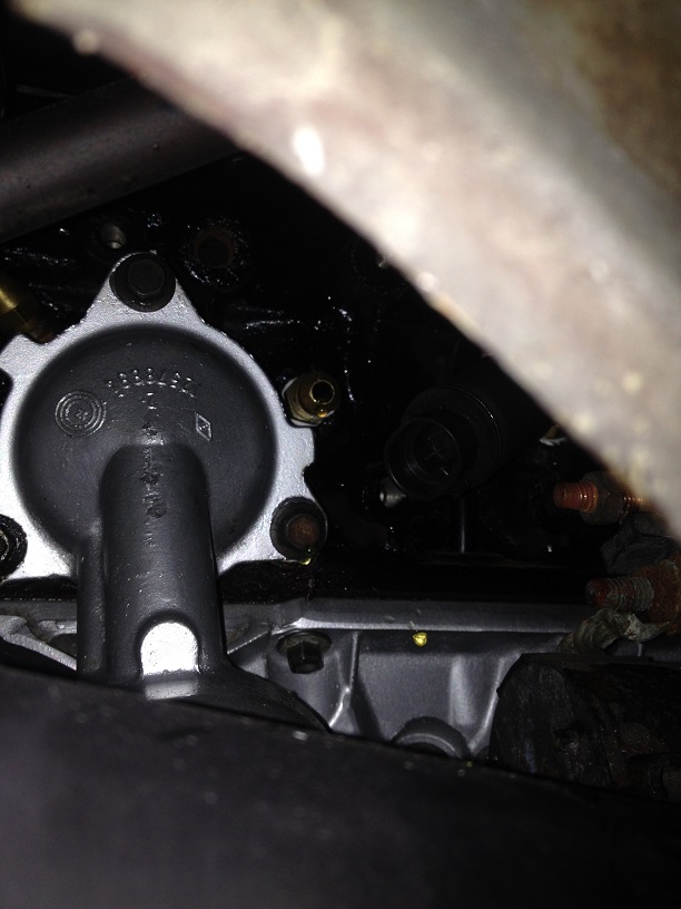

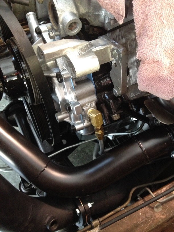

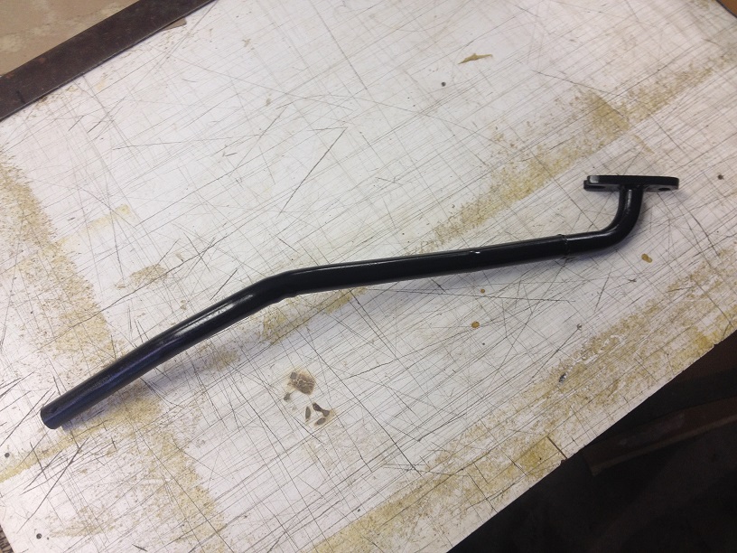

    Well, The oil drain back from the turbo took a bit to decide on just exactly how I wanted to do it. I've ran -10 braided hose on my last couple of turbo installs and while it worked it can get expensive and the piece I was using was getting old starting to seep a bit of oil. I hate leaks, and so I eventually decided on a solid tube to a rubber hose coupler at the oil pan. But then I had to decide just what route I was going to take, after some trial fitting, I came up with this:

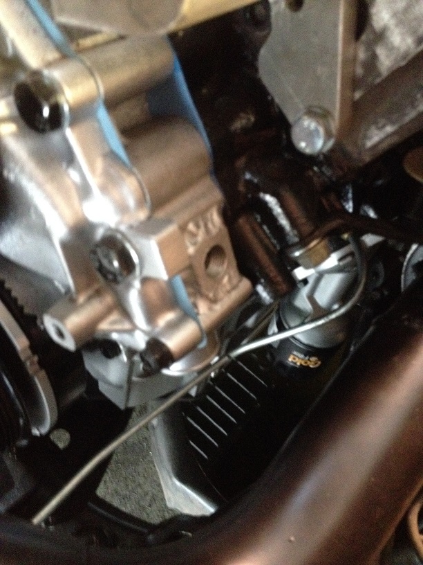

    It snakes in past the Y-pipe and then on a downward slope to the fitting I have at the oil pan.

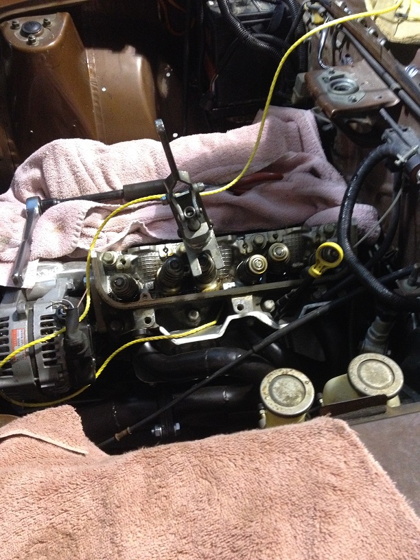

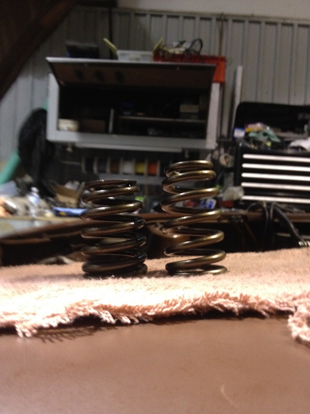

      I knew the weak point on the LX9 valve train was the stock springs, and truth be known, I believe it's been this way for a long time. I used stock valve springs on my Franken60 that used small port 3100 heads, and believe they were a major part of the limiting top end on that engine. I didn't want to take any chances this time and want to rev it to about 6500 RPM or so. I installed a set of Crane Cams valve springs.
      Comparison shot:
      I used a handy tool that an engine builder friend of mine had (I also bought the springs from him). I was able to remove the stock springs without adding an extension handle, not so with the new aftermarket springs.

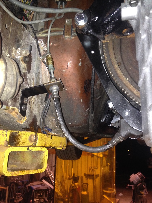

      Clutching At A Solution
      So with the new trans there were some clutch things to sort out, one being that while the original clutch slave could be used, it has to move to a new position relative to the car. It's mounted lower on the bellhousing requiring a different flex line or some other solution. I came up with my own solution:
      I decided to make a short extension piece, and a new bracket to anchor the flex line:
      I don't like how low the flex line hangs, so I might try using a different hose and a banjo fitting to move the hose up higher.

          Yes, I've already verified that it is indeed 10mmx1.0 thread, using a banjo bolt from a brake caliper I have, which is where I kinda got the idea.
          My only concern is whether the flow of fluid would be dampered and would slow down the clutch action.

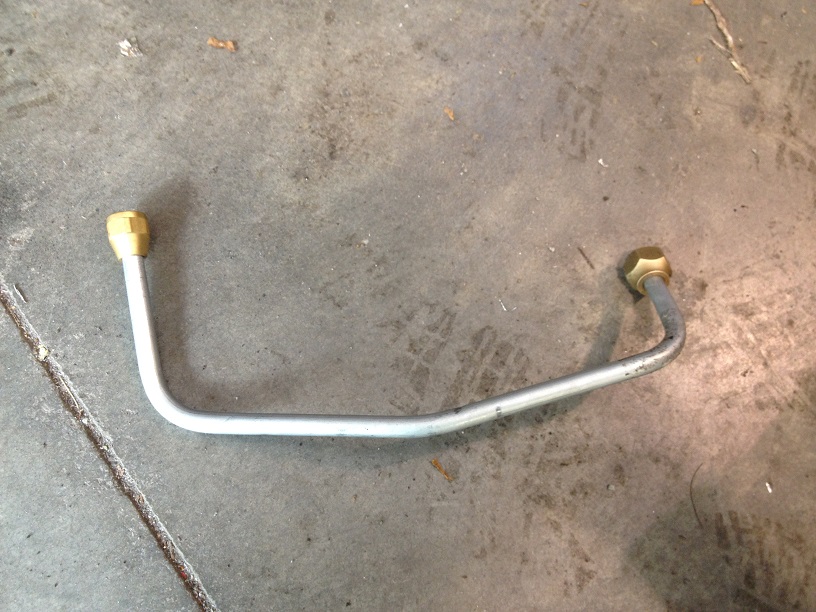

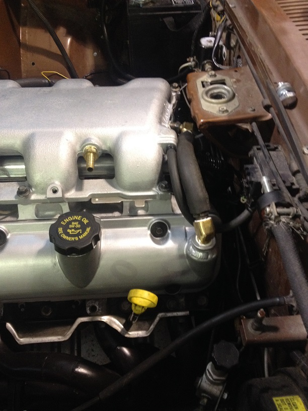

            Well, in looking at the cooling system and specifically the bypass that the gen1 used and the gen3 used and how very different they are, I started to formulate a plan to get something better then relying on the heater core as the bypass.
            I had to go with my alternate routing because I couldn't find a fitting that I liked to do it my preferred method.
            I started by welding up the hole in the back of the front cover that is present on the gen1 front covers. I then added a plate that I drilled and tapped for 3/8" NPT to the top side, where it will be accessible when the front cover is installed.
            I followed the idea of the gen1 path for the coolant bypass.
            90* fitting with a 3/8" NPT to 3/8" tube adapter.
            I then pulled a plug in the block and put a 1/4" to 3/8" tube adapter in that hole.
            I then formed a tube with proper tube nuts to connect the two.
            Bypass installed
            In the intake, where I really would have preferred to run the bypass to, I simply threaded the hole where the tube was for 3/8" NPT and plugged it.

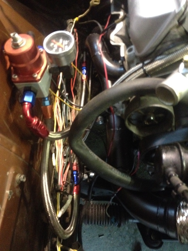

                Gimme Fuel, Gimme... Well... fuel...

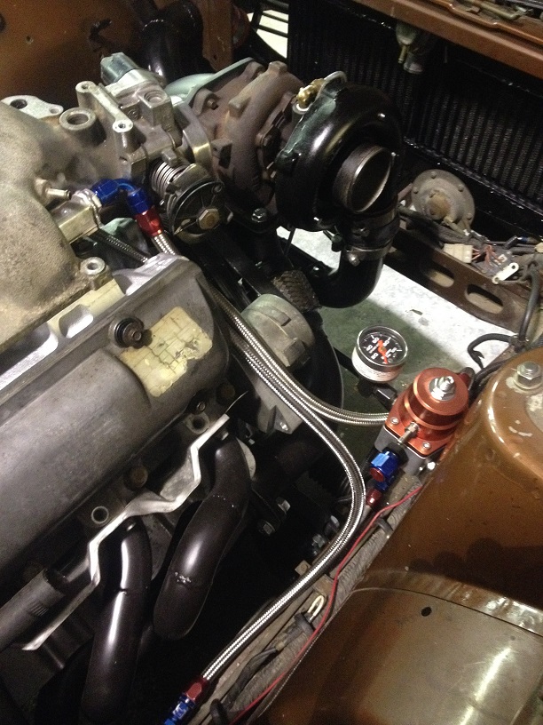

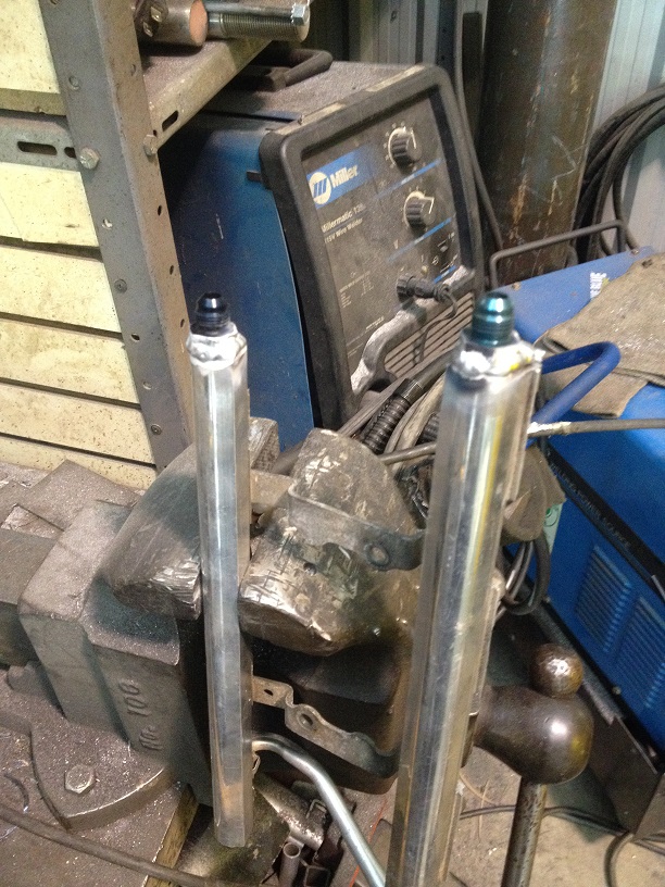

                Engines require three things, fuel air and spark, here, I get fuel to the engine.
                In the past on my 660s I've used a stock fuel rail and regulator, well, I had tried an MSD regulator that I was not impressed with and replaced pretty quickly with a stock regulator that I modified to be adjustable. This time I have plans of really increasing available flow through the fuel system, so this is what I shall call "the get it running set-up".
                On the previous engine I had a custom fuel rail made, since the stock fuel rail was fugly and wouldn't flow as well as I needed it to, and also limited me to barb style injectors. In that system I had an Aeromotove FPR, that worked well, so I wanted to retain that with the 660. To do this easily required some -6 AN fittings at the fuel rail. Now I know there are expensive adapters available to do this, but I am cheap, and I plan to modify the fuel rails even more in the future, so it made the most sense to weld on some AN fittings to the stock rail. I used a couple 3/8" NPT to -6 AN fittings, instead of the "weld on" type since these were cheaper, if I had to buy them, but I also had a pair of these already, so it made it easy, and cheaper for me.
                Installed in the car. I attached the FPR to the strut tower, because I wasn't happy with anything I came up with for mounting it on the engine itself.

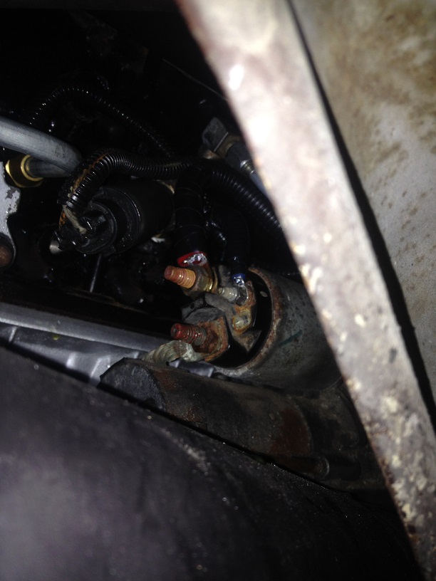

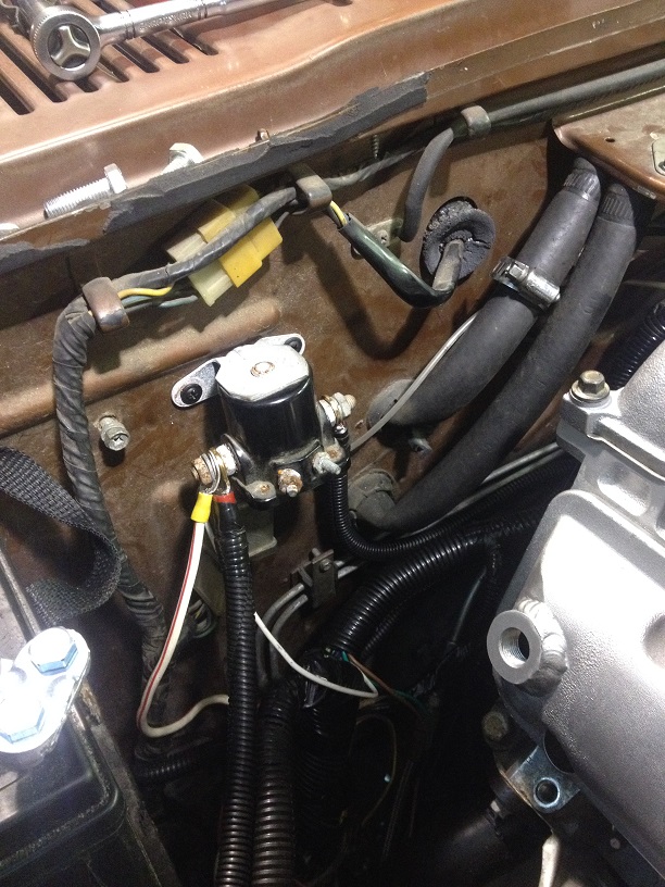

                I had intended on using an old hot rodder trick for the starter, where a Ford starter solenoid is used to give power to the starter, on both the heavy feed and the small signal wire. I have done this in the past without issue, but this time it held the starter on for a couple extra seconds, so I ended up changing to using the Ford starter solenoid as only feeding the higher current supply and triggering the starter more conventionally otherwise.
                Here I have the loop that is now removed:
                Ford starter solenoid, I may remove this and wire it a little differently now, because of how I actually have this connected, but it's working well as it is.

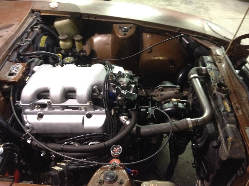

                    So at this point I haven't found a rad that I like, that has the inlets and outlets on the correct sides for the LX9, and has the right fit. So I use the old rad, and make some embarrassing rad hoses, just to get the car going. I will find or make a rad that is the way I want. I will likely need to make a rad. :/

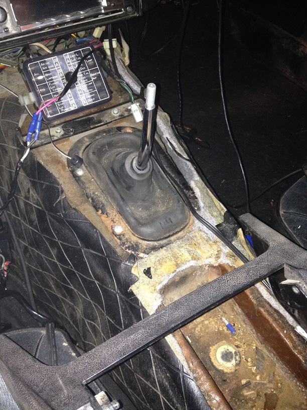

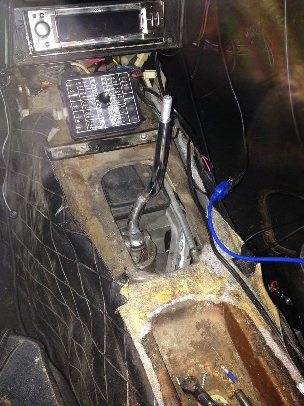

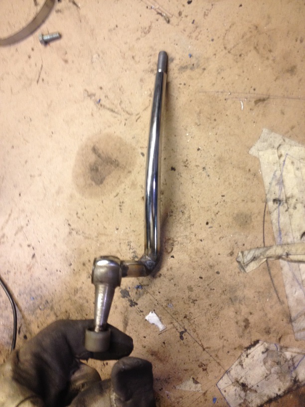

                    I also needed to finish off the shifter. I had built the base mechanism a long time ago, but not the actual shifter handle itself, since I wasn't sure exactly where the shifter mechanism would sit in the shifter opening. Now that it was the last detail it was time to get something that I can at least use for now.
                    I started with a stock 5-speed shifter which has a unique shape, this shape worked for me, when it came to cutting it apart and making a handle that would place the shifter where it needs to be. It worked out that the shifter came up through the stock trans tunnel, shifter boot, which was a bonus.
                    It actually works better than expected. I am still going to look into a different shifter, at this point I am going to look at finding a 2WD Pathfinder, or late '80's 300ZX that supposedly used the same trans, but had the shifter in a different location, which might work better in the end.
