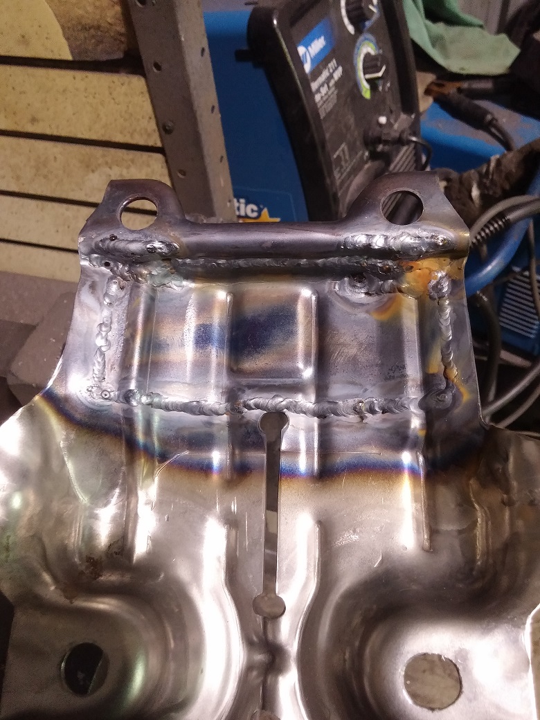

                          With the addition of the main studs I needed to modify the windage tray. I decided to just raise the area that interfered with the oil pan, as opposed to modifying all of the mounting points, which I did consider, but this was easier and I don't think it will have any appreciable drawbacks over other ways.

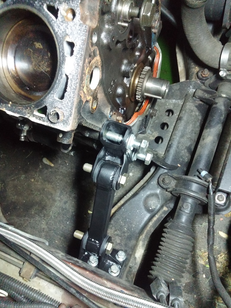

                          I made a new engine strut since my last one broke away at one of the anchor points. I had always planned to go to a urethane mounted strut, just wasn't planning on doing it now, but no time like when the engine is coming out anyway.

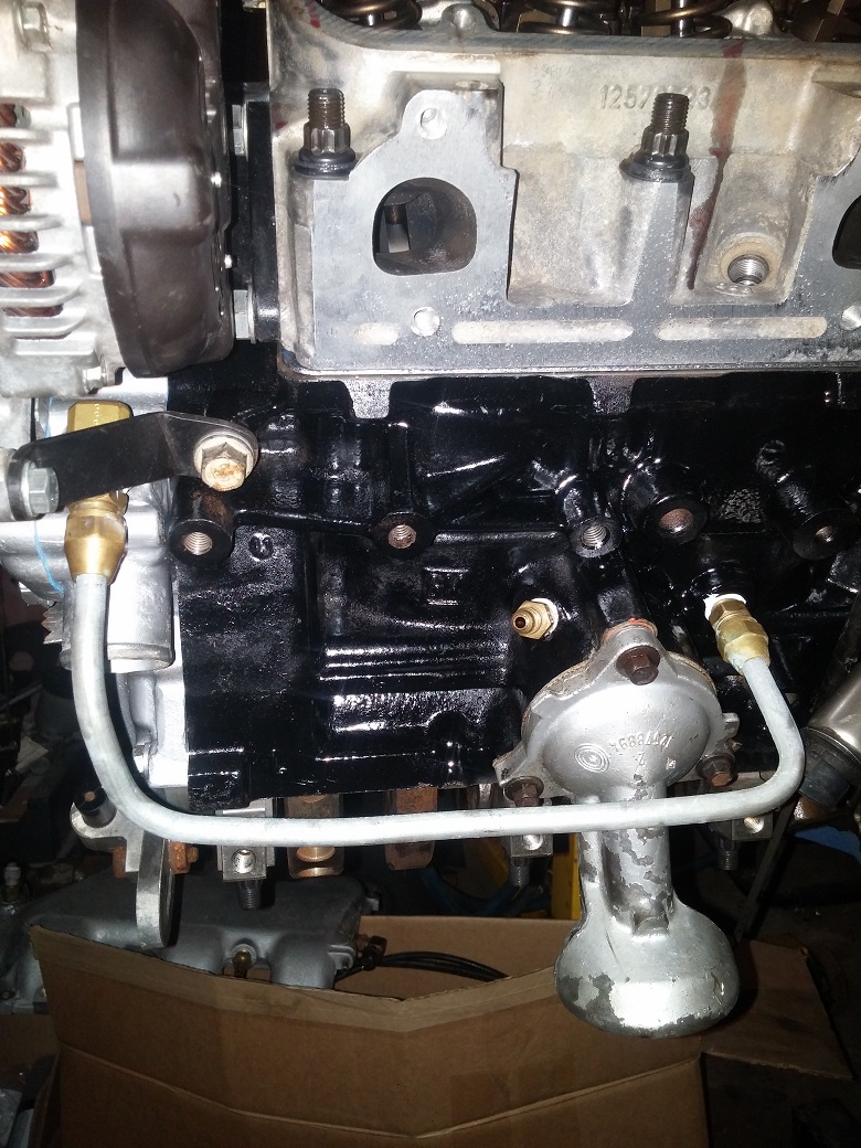

                          Just a shot of the coolant bypass that I installed, this is a better picture than I had previous.
