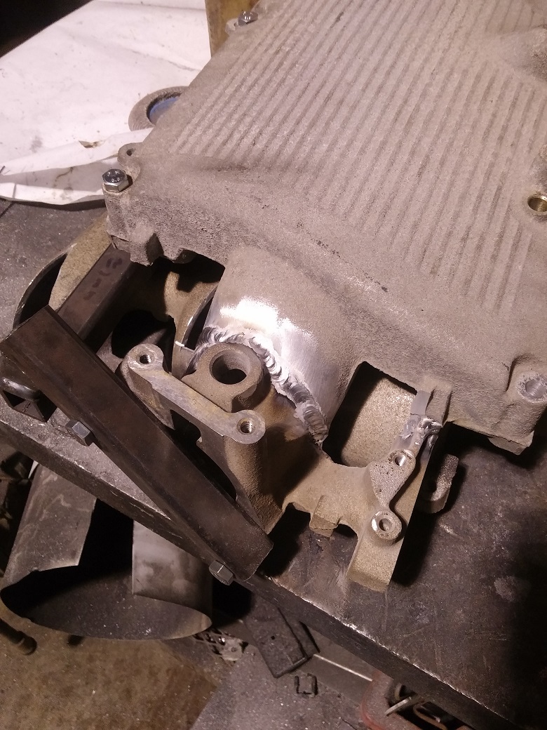

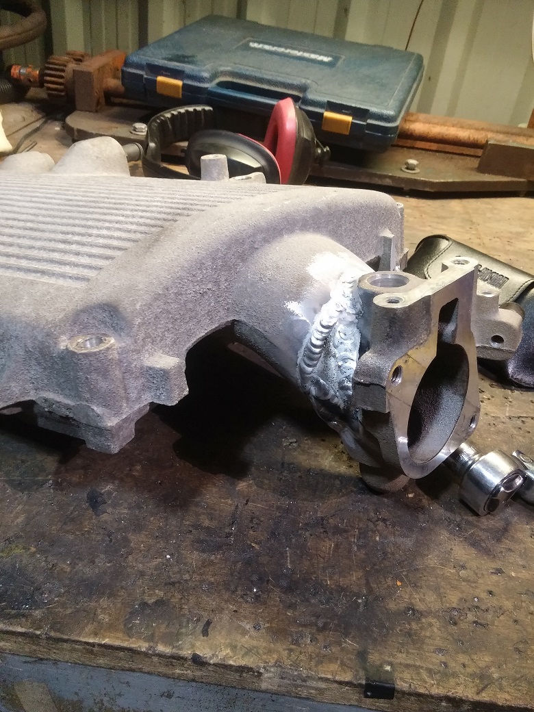

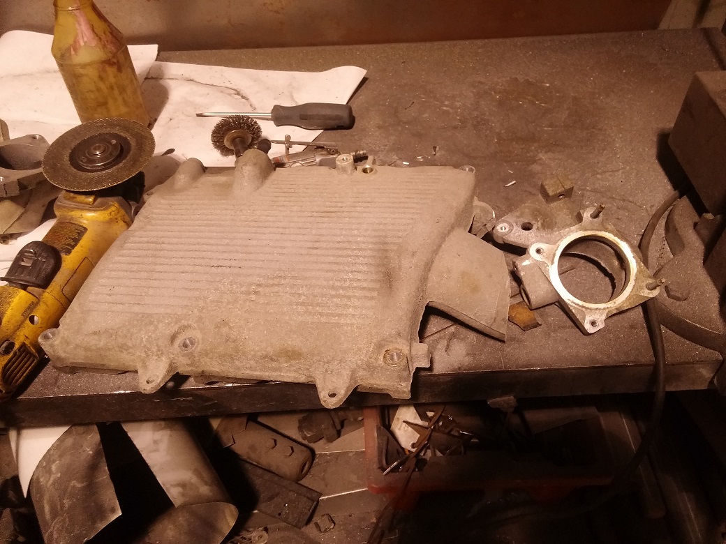

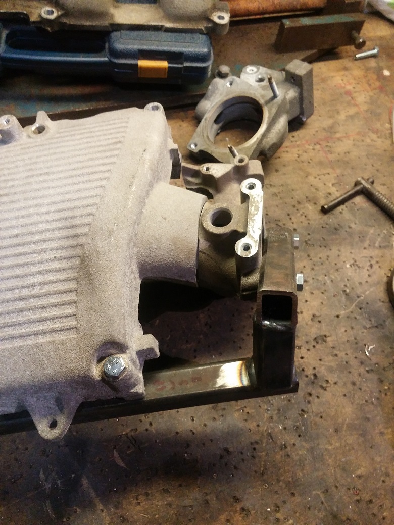

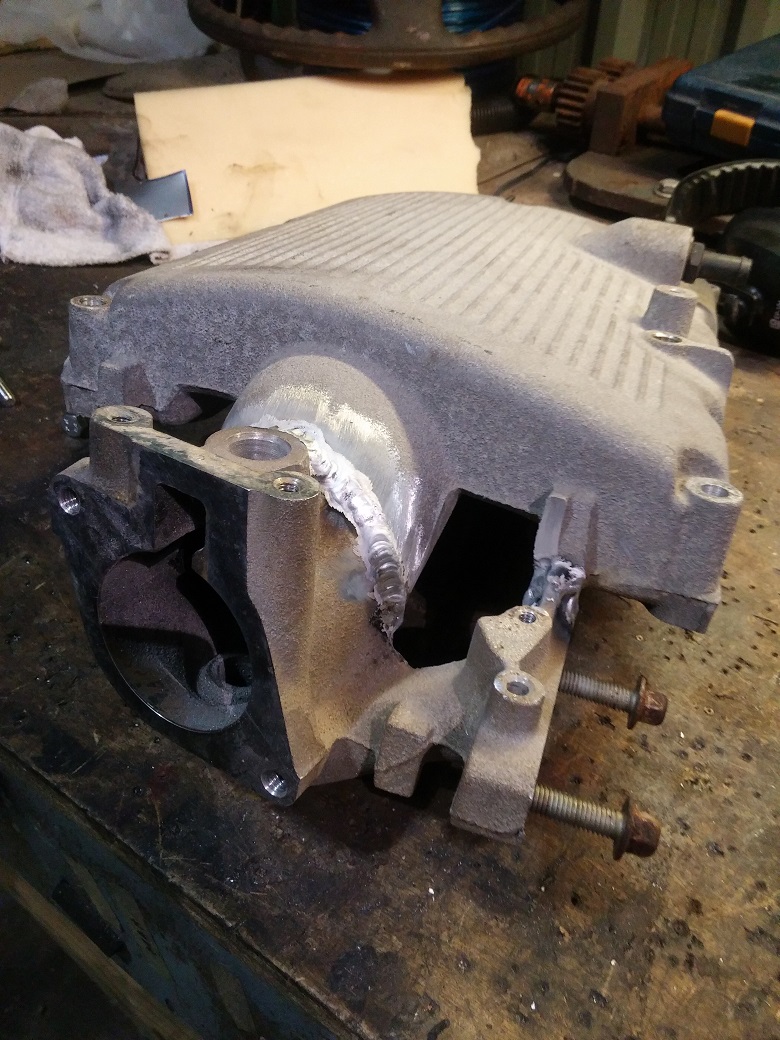

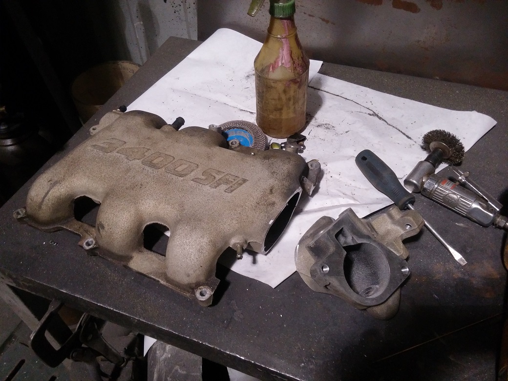

          Also, what the heck is going on here?
          Wait, wut?
          Yep, that's what is happening...
          I still need to blend the inside, and add a few fittings to the intake, but this way I'll be able to literally slip it in place of the LA1 upper without modifying anything else. I could also do a an A-B comparison (dyno/track) very easily this way, looking at just the effects of the change in runner length and plenum volume, taking the throttle body out of the equation.

            Good idea about welding the neck on for comparisons, but wouldn't an adapter plate function just as well?
            • Guest
              #96
              No, the flange of the 3500 intake is already about 5 to 7 mm forward in comparison, and then adding an adapter plate would be another 8 mm minimum more forward (and move it more to the side, due to the angle). With the intake tubing I have, this would not fit well, if at all. This would also create a lot of turbulence at the transition from the adapter plate to inlet neck, that would require some creative additions to the adapter plate to reduce them. While the transition won't be ideal here, it will be much better than a simple adapter plate.
