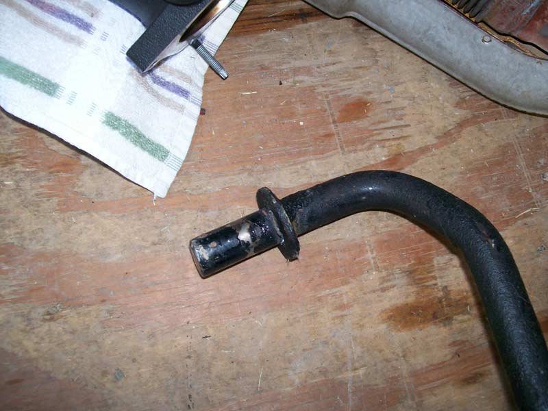

                            My bar still slid around with Energy Suspension bushings. Here is my solution to that... the stock bar has them, I don't know why the addco bar doesn't.
