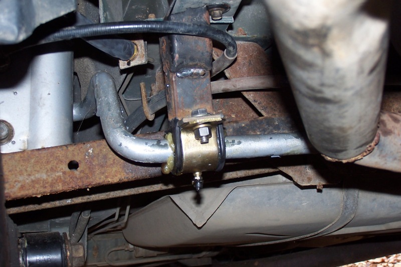

                        I got the revised bar too....want pics of install....here ya go
                        old bar....w/ stops i made

                          #42
                          alrighty, here it is.
                          what i done was fairly simple. i took the stock metal mount to a machine shop, they welded a piece of sqaure steel to it and then welded flat steel plate with 2 holes in it to the square steel.
                          i ended up using the flat plates provided with the sway bar. looks like the hardware was good for something.
                          not the prettiest granted but solid i assure you.
