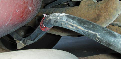

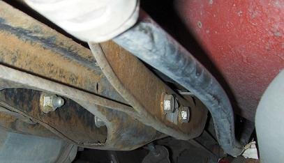

                    Yeah, but the factory 7/8" sway bar is stupid. The driver side goes up at an angle and it doesn't give much support for the driver side rear. The passenger side looks similar to the addco bar and gives firm support.
                    I'm REALLY thinking about ordering the rear sway bar for the Gen 1s. Anything has to work better than the stock bar.
                    Notice my attached pix. The Driver side is almost flat coming up to the braket, while the passenger side has a nice "hump" that gives firm support.
                    It would be my hope that Gen 1 Addco bar would work significantly better. Thoughts anyone?
