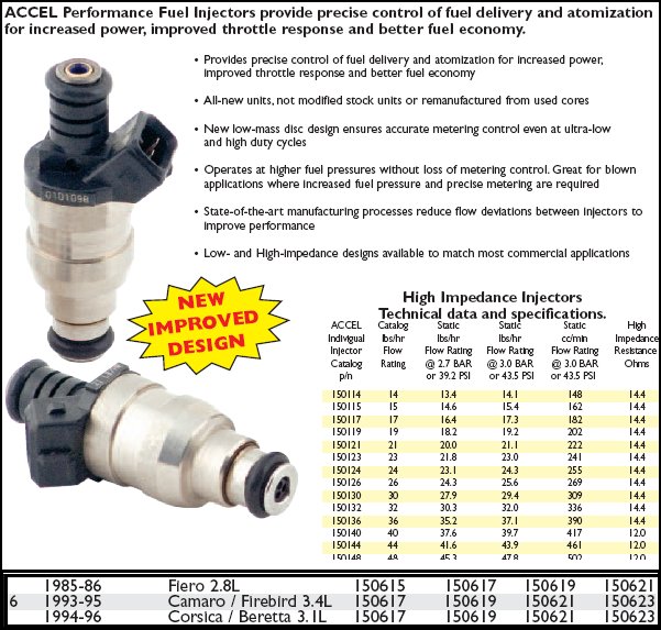

Injector flow rates - lets put something together
So no one else can tune cause you don't know the actual injector rating? ROFL!Ben
they are 22.5 @ 55 PSI.Originally posted by barrok69 View PostI'm using 23# in my calculations, my car runs fine. The ECM will take care of any small discrepancies. I don't know what to believe anymore so i just took what Delphi posted up. So much misinformation floating around these days.
You don't need that information to tune the car, but that's a whole other thread.
94-96 3100 injectors were not 19... they were 16.7 or 17... Black ring vs the red ring on the Multec 1's
The 3.4 DOHC changed ring colors but that didn't mean the ratings changed. Id like to start seeing injector flow sheets with all these numbers. I have an excel sheet from someone, which is what I used for the wiki update.Ben
I got that info from the 3400 swap guide...
I'll try to get some part numbers so you can cross reference the info with delphi... As far as flow sheets, the only set I will ever have is for my 04 Trailblazer injectors, since it cost money to bench injectors...94 - 95 3100’s: 17#. Pre-00 3400’s: 19#. 00+ 3400’s: 22.5#
I didn't say that. I said I don't believe there are alot of accurate tunes out there simply because there is no where to get this accurate information from. I would say that the injector constant is the main basis for every fuel calculation that is going on in a given .bin file. If that number is not correct, you have to spend alot of time correcting other things. If you are starting from scratch, or have a wide band o2 that is not a big deal. Not everyone is in that situation though.Originally posted by SappySE107 View PostSo no one else can tune cause you don't know the actual injector rating? ROFL!
my injector constant is still set to 16.71lb/hr and i'm running 32lb/hrOriginally posted by 3400beretta View PostI didn't say that. I said I don't believe there are alot of accurate tunes out there simply because there is no where to get this accurate information from. I would say that the injector constant is the main basis for every fuel calculation that is going on in a given .bin file. If that number is not correct, you have to spend alot of time correcting other things. If you are starting from scratch, or have a wide band o2 that is not a big deal. Not everyone is in that situation though.

Does anyone have a part number for these injectors? I could look them up easier with that information.Ben
Hey now..Originally posted by Magis View PostSays the person who's getting 7mpgs in the city.
my BLM's were in the 90's then.. they're up into 110-115 range now, If i could ever finish the body work i'd have the VE tables backed off enough to get decent mileage.
I am working on making a list of injectors... here is what I have to far... my concern is for the injectors used in W-body cars.

I notice that the injectors in the aluminum headed 2.8mpfi and 3.1mpfi are the same injectors, and thus should have the same flow rate... but what is that rate really? and more injectors will be added to this list soon.
This is still wrong.Originally posted by Crazy K View PostVIN M - 1993-1998 3100 SFI V6 - 189cid
#17113572 {ACDELCO Part # 2171388}
Max Flow: 19lbs
Supply Pressure: 43.5PSI
Multec 1
94-99 is 17lb/hr for vin M 3.1
