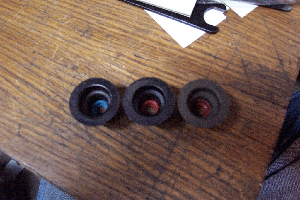

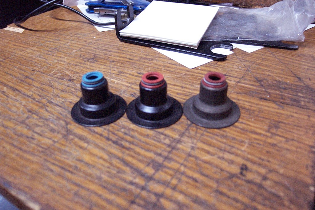

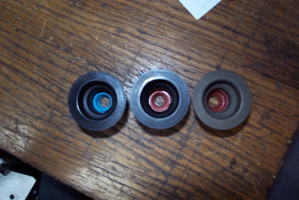

            First pic is of the 3 versions. Left is 00+ (.553 OD guide), 94-99 .520? OD guide. 3rd is um...wrong. It fits the .553 guide no problem but if you look at the other pics, you can hopefully see what the seal itself looks like on the inside. Oh, and you can't make out the crimps in these pics
            The metal part is a dull etched looking black vs the nice gloss black of the seals that have always worked well.
