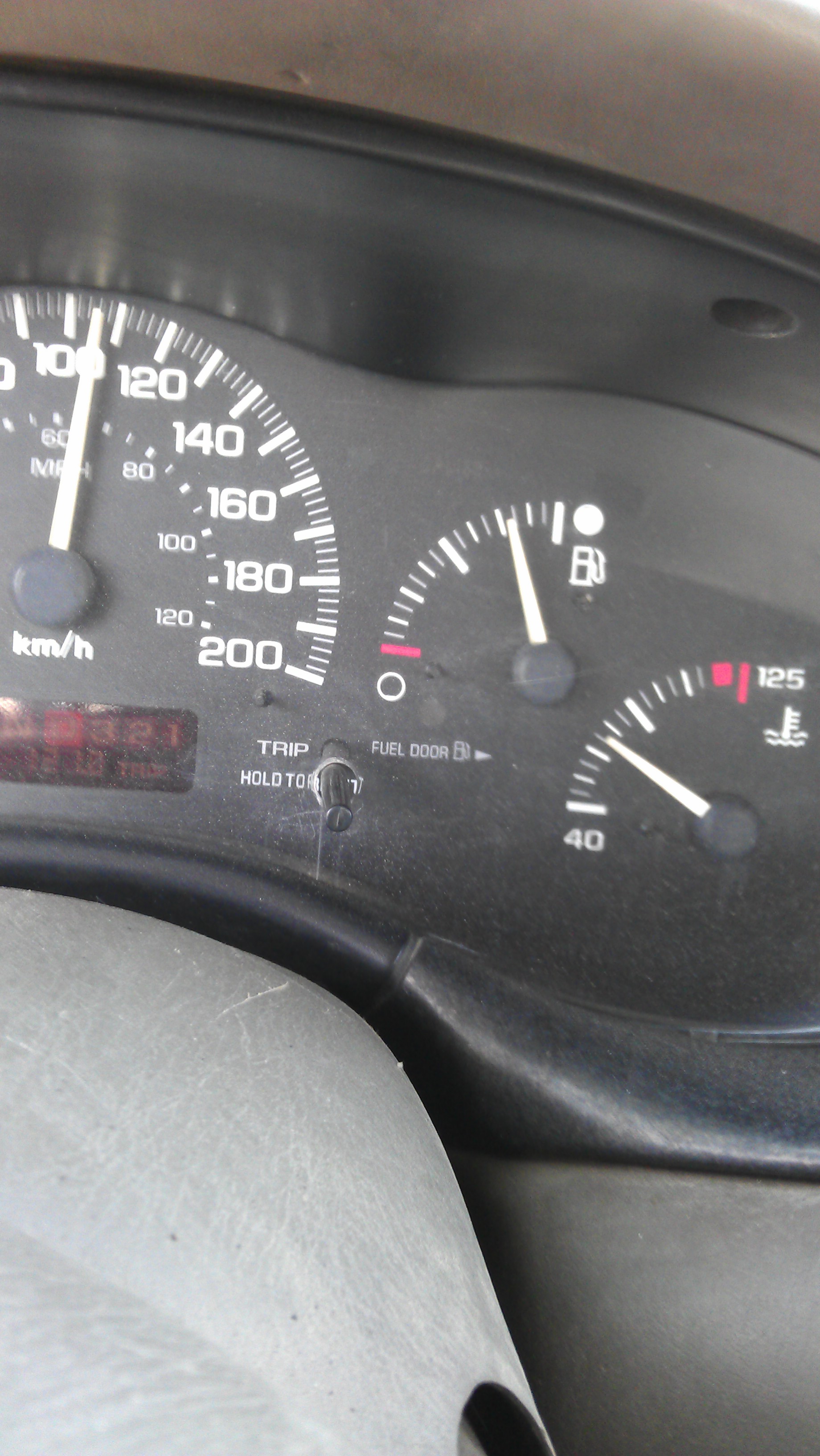

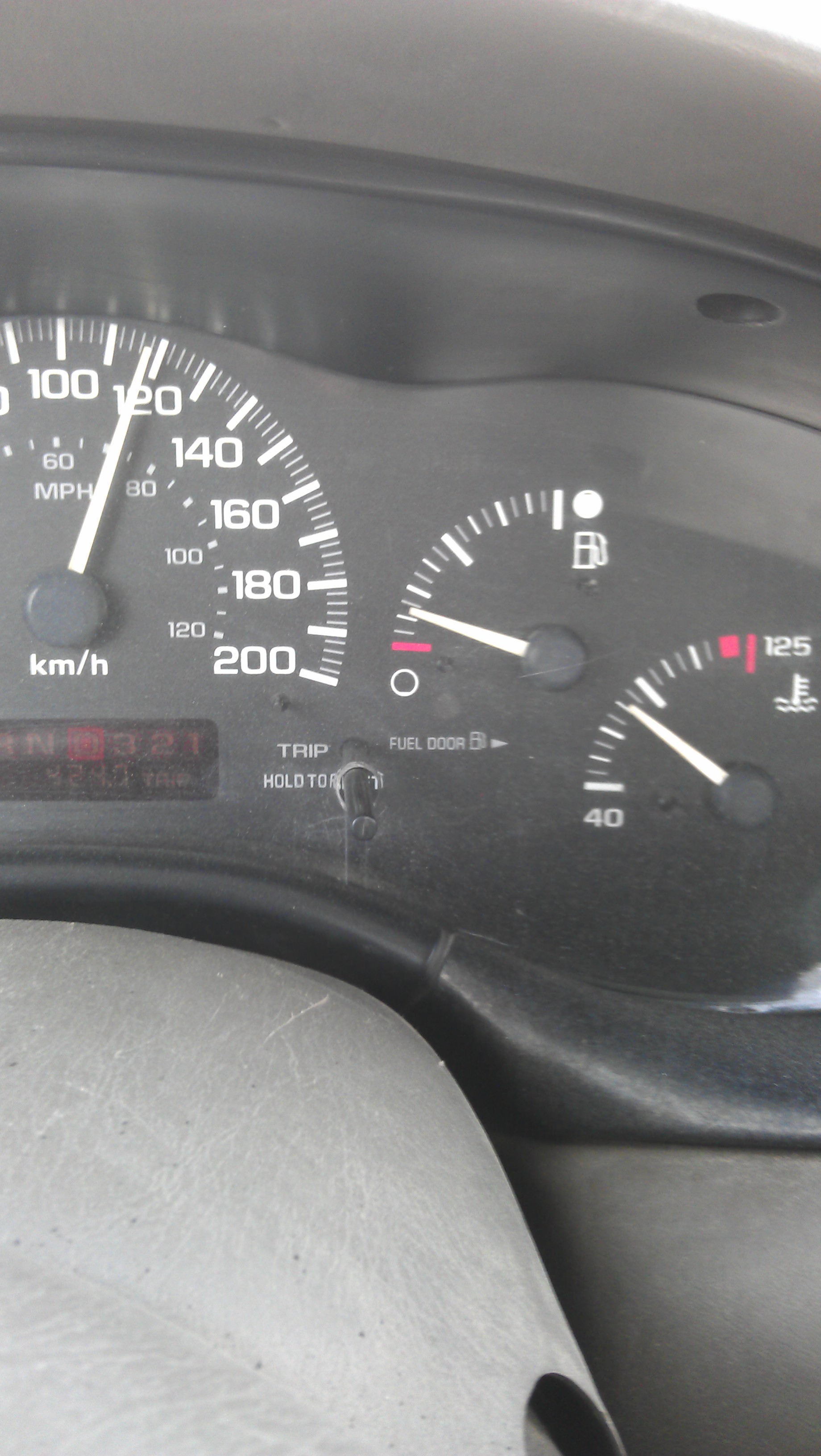

          thanks everybody for appreciated response i attached this photo to show the temp gauge reading while i am driving at 120 km/h and ac on the temperature regulate just two slashes to the normal operating temp the issue which i think it shall not affect the engine health like when we run the car at cold start it takes long time to reach to middle of range and if we go through highway driving it also show the less than operating temp. the different between the two photos only the outside temp. 1 st photo ambient temp was 19 c at early morning the 2 nd was 34 c at middle of today.
          later in june to sep it well stay at 45 c so i will never run colder than this measures which i think the engine can afford or feel happy with running colder.
