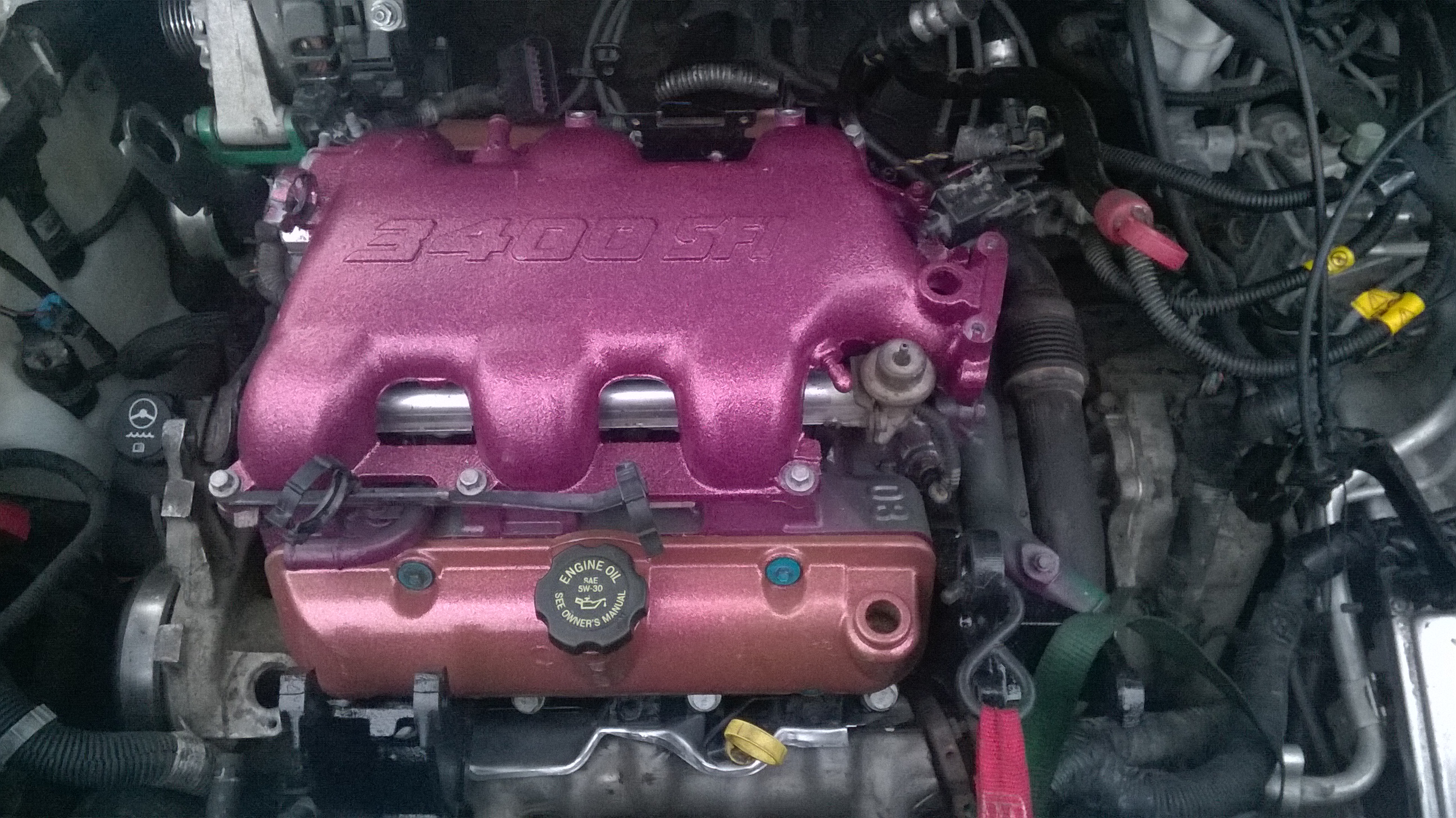

    Just did a top end rebuild. Before the rebuild it was running on 5 cylinders. #1 had a stuck intake valve. Got everything back together had spark but would just backfire, pulled all wires and rechecked firing order. Tried again and now nothing, no spark, plugs are dry so I dont think it's getting gas either. Fuel pump primes and has pressure. Any ideas. How does the Ing module ground it's self
