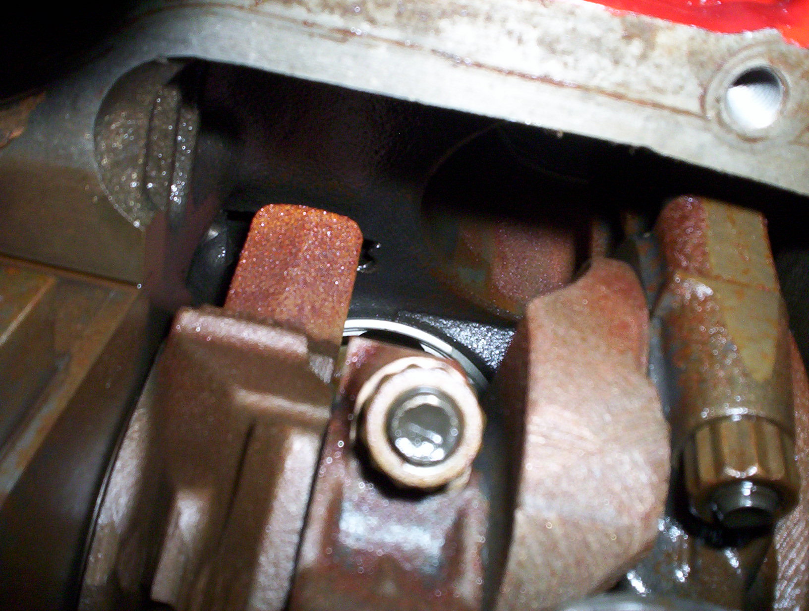

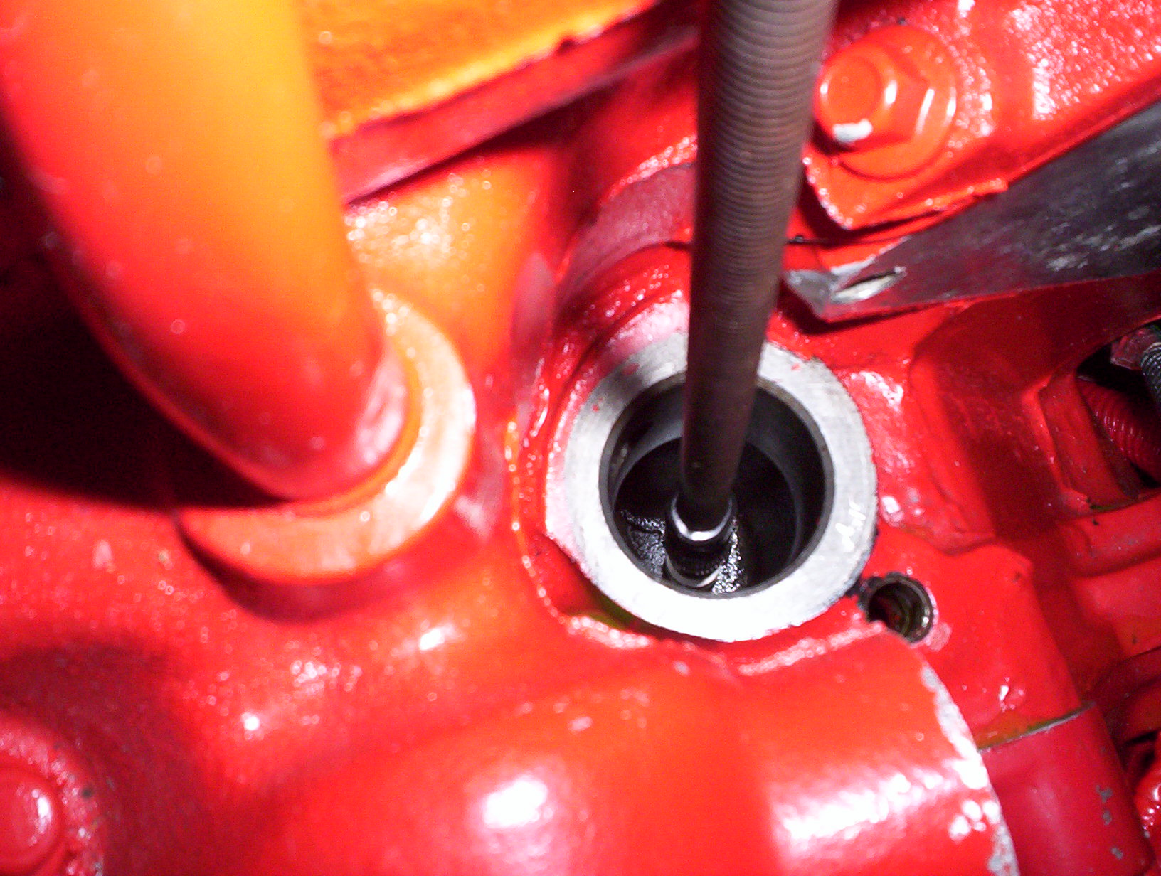

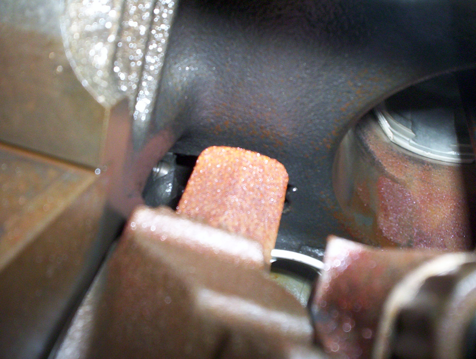

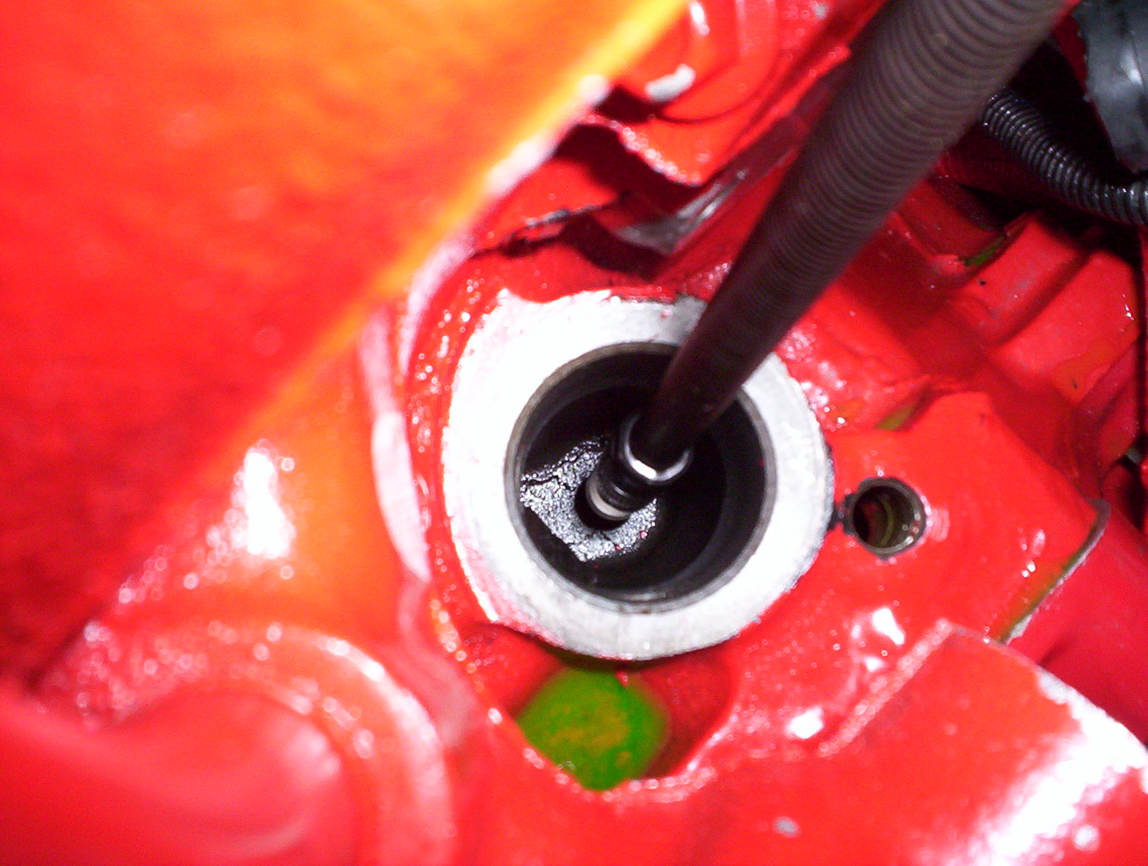

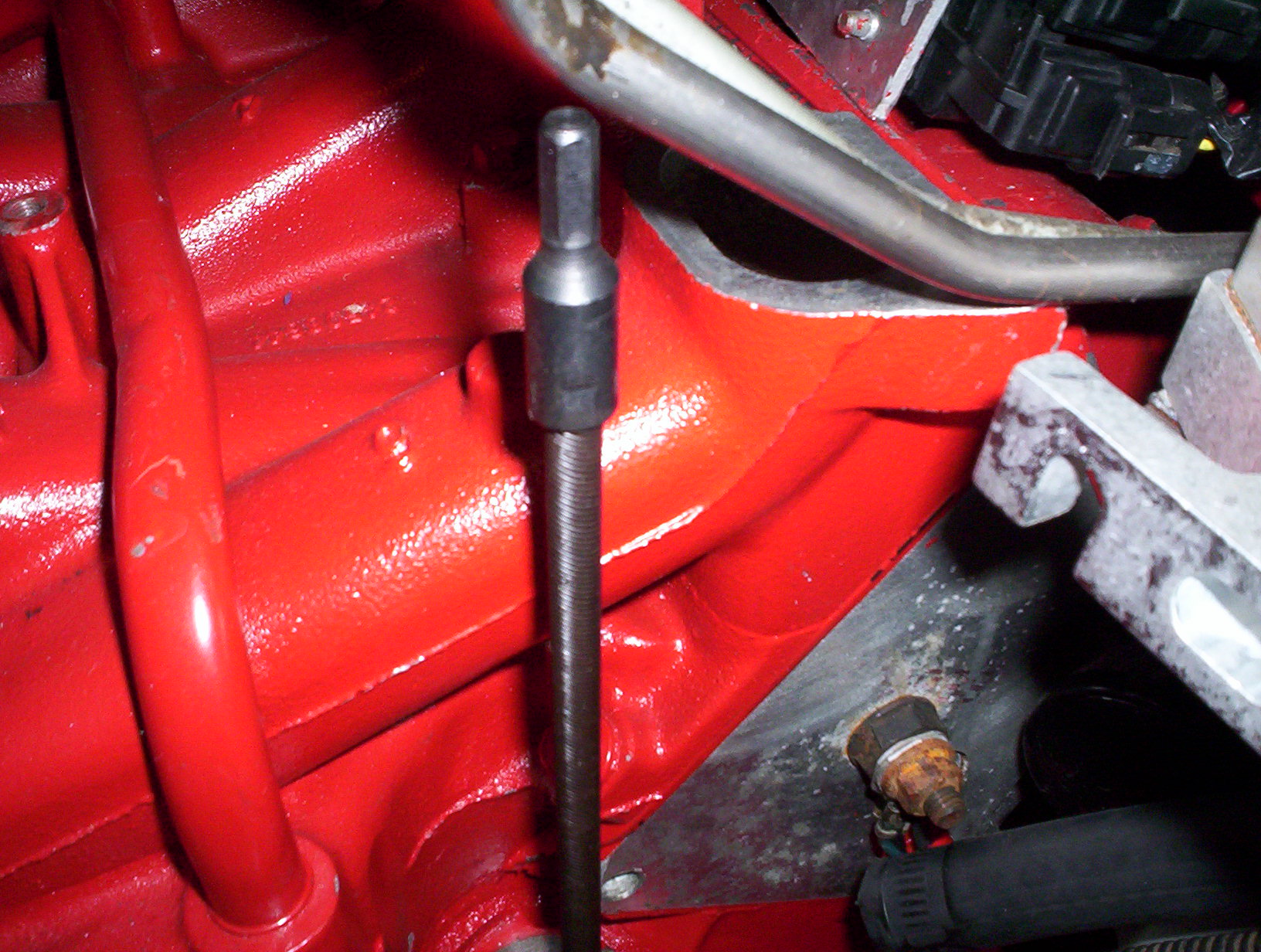

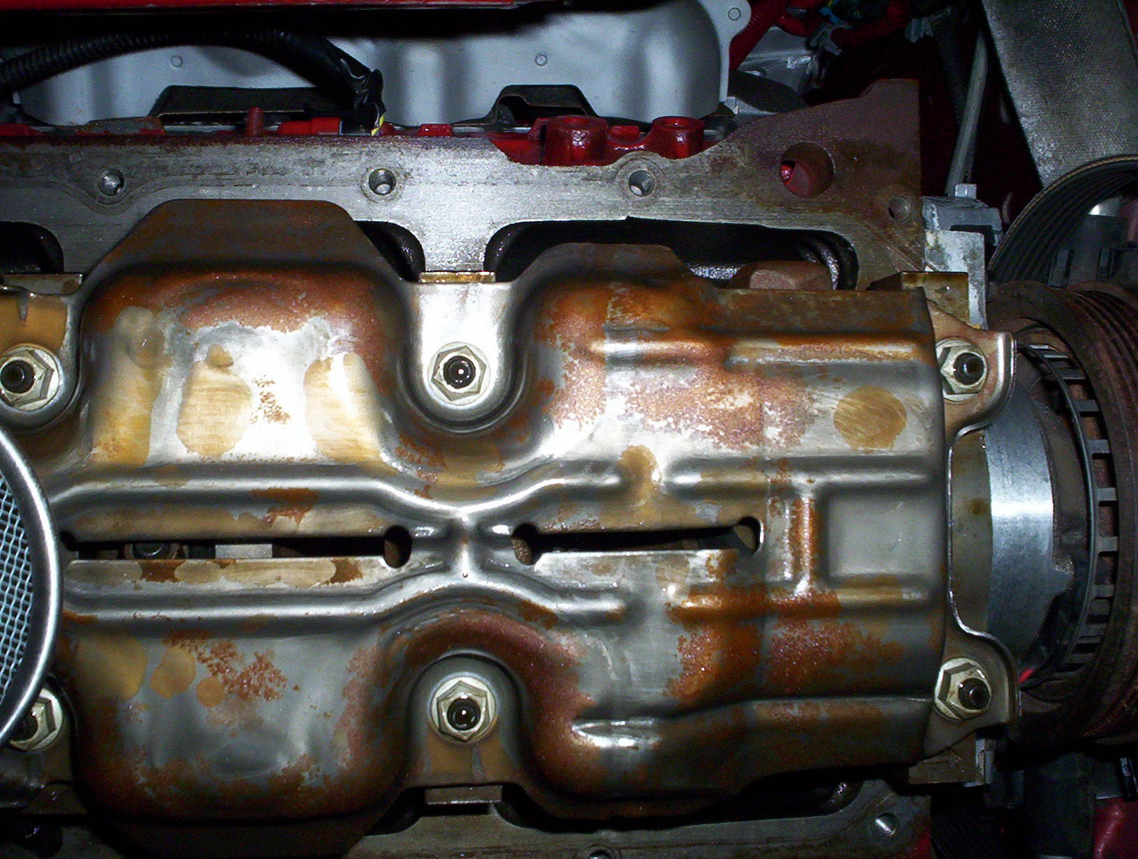

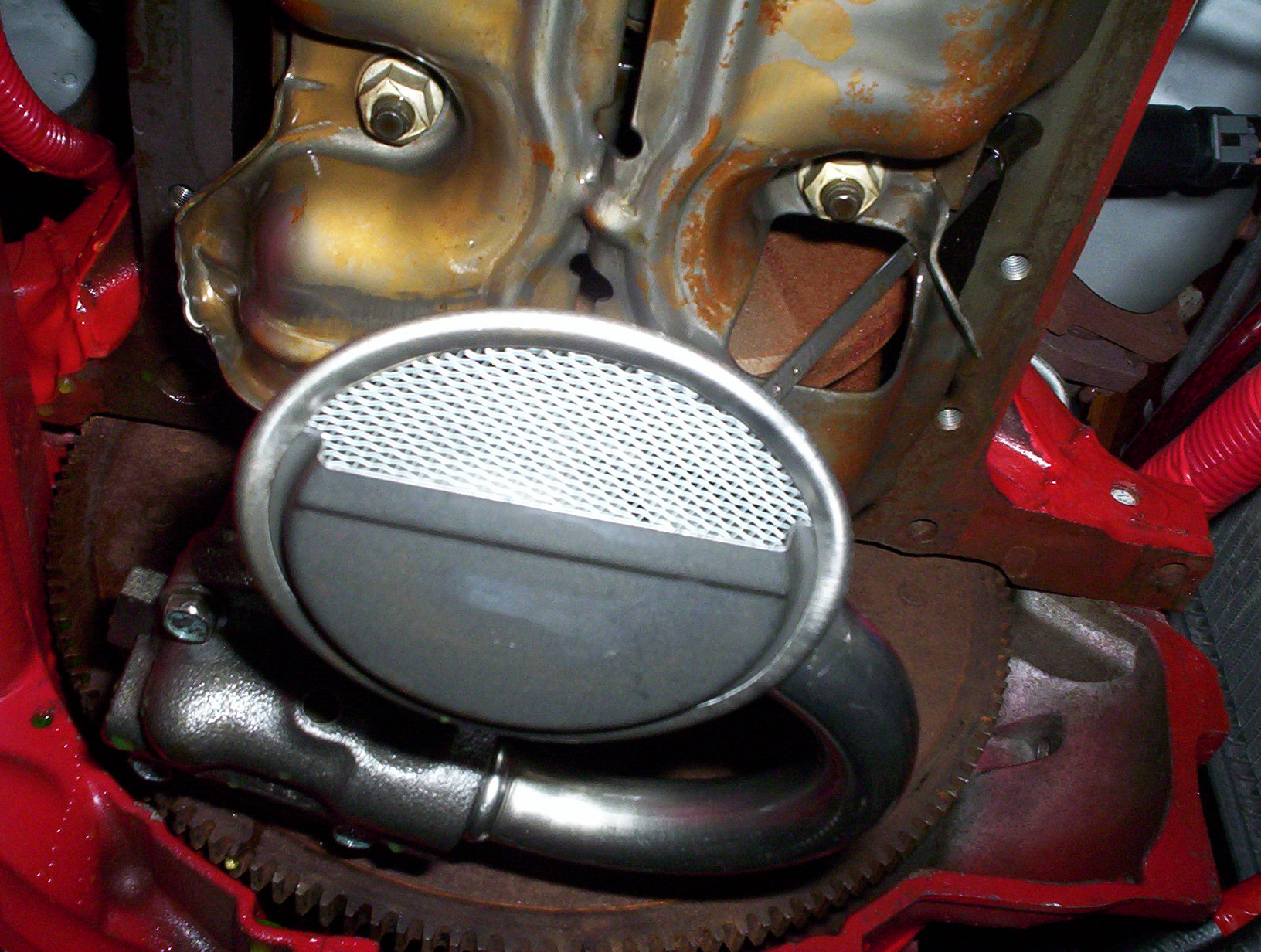

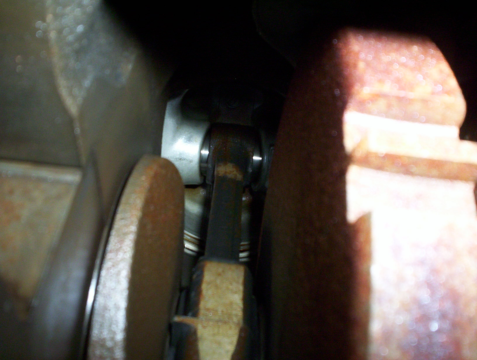

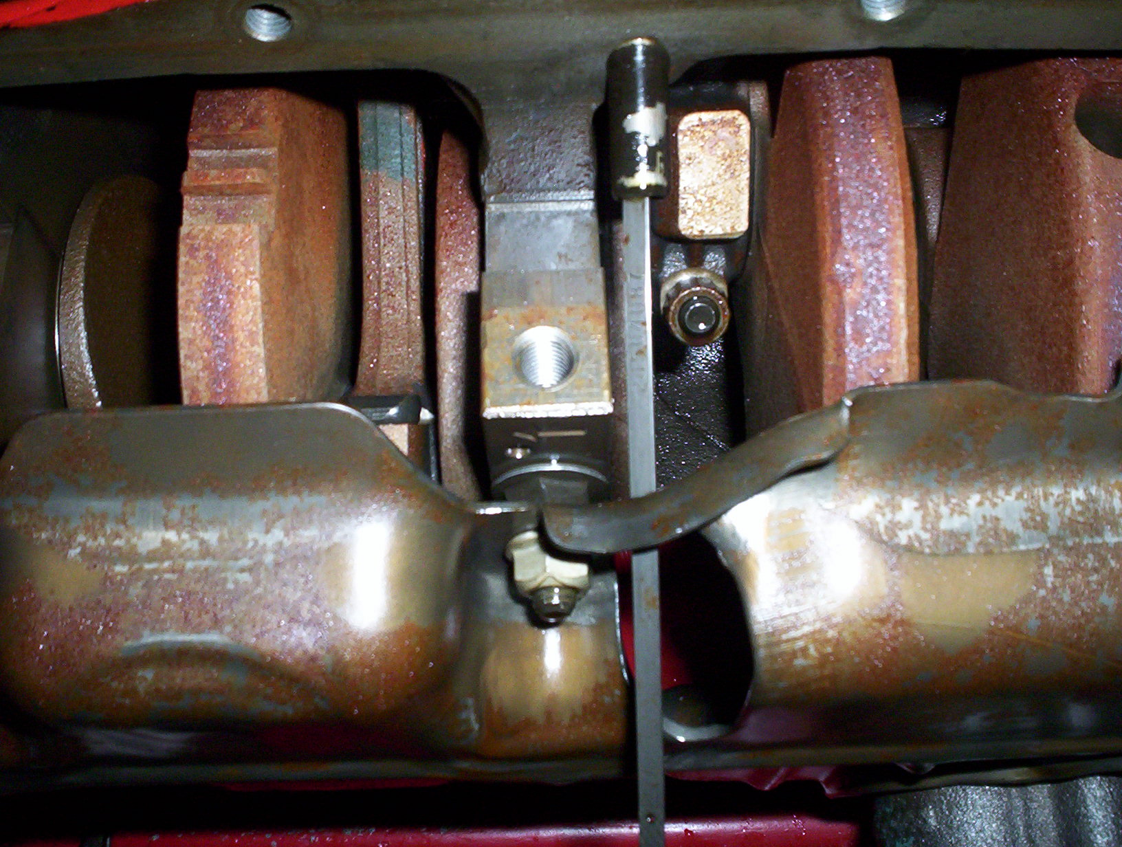

          i tried looking it up but couldnt find it so i took some pics to show you guys what im dealing with. i left my oil pan off all winter like a dumbass and now the entire bottom end is rusted out which makes it even worse since its ran with no oil pressure for about 10 minutes idling but the rods never knocked just the top end ticked. so should i overfill the motor with oil and let it sit for a while?
          i also have this extension that came with a drill bit set that fits but doesnt seal the entire opening like the pump gear drive does think it'll work to prime the engine? and which direction should i spin the drill?
            shove a rag around the bit and it should be ok.. i forget what direction to go but you'll know when it's pumping.. lol

              Your going to destroy a set of piston rings when that engine starts again. The cylinder walls are dry and have to much rust on them.
