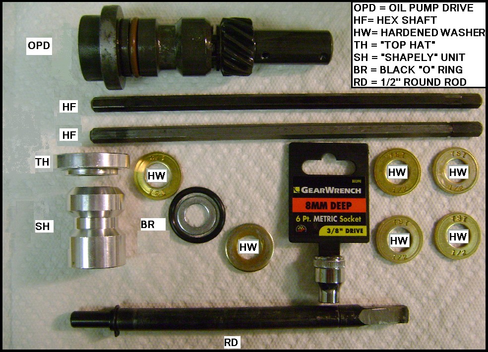

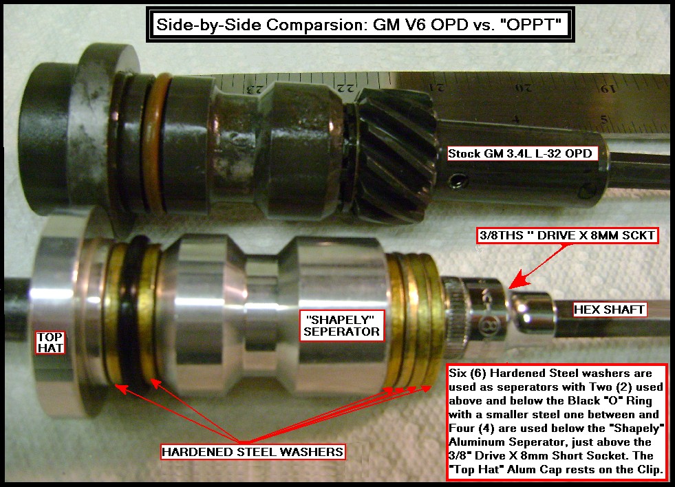

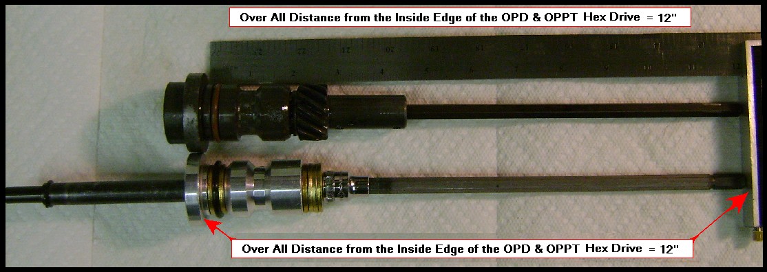

        Building an Oil Pump Priming Tool for 60* Motors
        Originally posted by Firehawk94 View Post
        Hopefully he'll drain the 19 quarts of oil before he starts turning the engine over I like the priming tool that you made....any chance of you mass producing these things and selling them? You may be able to make a bit of profit if the price on the parts isn't too high to make it. In other words, I would be interested in one.
        Thanks for the inquiry but, not being a machinist or having access to 2.5" aluminum round stock, the hardened 8mm Hex Rod Stock and the metal lathes needed to shape it, it would be a daunting process to make them the way I had to do the first prototype "one off". But "patent infringement" risks aside, having done all the research on the parts and pieces while mixing and matching and grinding to get this one to work, I will be happy to soon share those dimensions and provide a "parts and pieces list". In advance of getting all these measurements, here is a baseline of the raw materials and procedures needed to make what the Auto Parts companies should have been making and selling years ago on our behalf: (OPPT = Oil Pressure Priming Tool)
        If you want the visual "CLIFF NOTES" to this Step-By-Step Instructional... Visist my Photo Bucket site HERE:
        (1) You will need to buy some type of standard, available Oil Priming Tool made for the SBC/90* Engines, just to get at it for some of its components. The one you choose MUST be of the style that has that odd shaped aluminum barrel at the top that closely matches the design of the upper portion of stock GM V6 Oil Pump Drive for the 2.8L. 3.1L and 3.4L engines. It also must have a metal center rod that is at least 3/8" in dimensions to allow for the extra material to be ground down for a close fit into the squared off fitting on the end of the shaft. These SBC Pre-Oilers can run anywhere from $30-$45 from RockAuto, Northern Auto Parts or Summit online parts catalogs.
        (2) You will need an assortment of Hardened Steel Washers to use as segment separators and serve as thrust bearing surfaces along the length of the stock 3/8" steel shaft to align the parts in such a way that the PTFE or Black "O" Ring needed to seal the upper rear engine block from leaking can be aligned perfectly in the upper groove of the engine block, while the drill is working away on the 3/8" steel shaft in the center to build up oil pressure. Adding and subtracting washers helped find the right spot for the "O" Ring. These shafts come with various grooves machined in along the length of them with locking, high carbon spring steel rings that will all have to first be removed before installing the washers as space and distance adjusters.
        (3) A decent bench grinder, along with a spray can of WD-40 to oil quench the 3/8" steel shaft every so often when it gets too hot from all that grinding needed to take the round 3/8" steel shaft down to the snug size of 3/8" SQUARE MALE END needed to plug the now shortened AND SQUARED OFF 3/8" Round Shaft into the base of an 8mm Socket. The 8mm Oil Pump Hex Rod then fits inside this socket when the Oil Pump Priming Tool is guided into the engine block Oil Pump Drive opening. This is where all of the real labor comes in by trial and error to get the length of the round 3/8" rod ground down and squared off...just right.
        (4) Having an extra, stock GM 8mm Hex Shaft would help by allowing the builder to compare the new tool's over all length and the position of the machined aluminum barrel at the top for "O" ring alignment purposes when shown alongside the stock GM Oil Pump Drive with the 8mm Hex Shaft inserted all the way into the unit. When the intermediate parts of this thing are assembled, the 8mm Hex Shaft has to be a perfect match in length when pushed inside of the tool socket in order for it not to be too long or too short and risk having it coming out of the top of the oil pump female Hex receptacle and then dropping down inside the engine during the hectic oil pump priming process. all the "In Between" parts of this tool must not come loose and fall inside the motor. I was tempted to glomm some JB_Weld all over the tool around the shaft/socket interface, but in the end, I think TIG welding the 8mm Socket to the shaft will provide more security and stop the socket from popping off after having the 8mm Hex Rod rattling it from the inside. Having this arrangement allows for the Nylon Locking clip to be installed over the female Hex End in the Oil Pump along with a new, stock 8mm Hex Shaft when the pump is finally installed, bolted down and torqued to spec. One last consideration is making certain that the socket being chosen is NOT larger in diameter than the Hypoid gear on the stock Oil Pump Drive! (We don't want to damage the matching gears on the in-dwelling camshaft...)
        The only thing the user of this new OPPT has to do is afterward, make certain that the Hex Shaft poking upwards from inside the engine block makes its way up inside the OPPT before full insertion and bolt down with the Oil Pump Drive Clamp at the very back of the engine.
        (5) Don't rely on your "Spotter" to sit in the car and try to read the Oil Pressure from the dashboard Oil Pressure Gauge as fed by the PCM. You could attach an outside oil line through one of the engine oil gallery plugs, but it might be better to just take a little time to tap a small, threaded hole into the Aluminum Oil Filter Adapter and then attach an oil line tube with an Analog Oil Pressure Gauge. Autozone and other similar stores sell these components and the job is a fairly simply one to do. The plastic oil pressure line should be long enough to reach from the bottom of the engine block near the Oil Filter all the way out to the area of the fender where you can comfortably watch the gauge while priming the engine. You will want to see the new oil traveling up the slender oil tube and finally registering satisfaction in your smile as you feel the drill begin to labor while you watch and hope for a decent rise in oil pressure above 50 PSI. When you remove the oil line, use a good thread sealer (NOT Thread Locker) on the matching threaded plug that should replace it in the the newly threaded hole in the aluminum Oil Filter Manifold. Don't allow the sealer to get inside the Oil Filter Manifold as some of it could ooze into the oil line flow and wreak havoc with a blockage.
        (6) You MUST use a sturdy enough drill to make this work! The 1/2" Drill is preferred, so avoid using a standard 1/4" or 3/8" drive, as this work requires a drill with Balls as Big as Church Bells! Initially, the drill will not feel much resistance as the air in the oil galleries and spaces between the bearing surfaces is compressed and finally displaced by new engine oil (hopefully mixed with some type of Engine Oil Supplement). But soon enough, the 1/2" Drill will begin to labor as the Oil Pump draws more and more new motor oil from the pan and encounters more and more resistance to the oil flowing through the system and wetting down all the things needing protection from metal to metal contact. Running the drill in 30-45 second intervals will allow you to watch the oil pressure rise and fall... and give the drill a chance to cool down in between. For new engine builds, with the valve covers off... you can see the oil that has flowed through the system coming out of the push rods and cascading over the valve train as an assurance of good flow service to the top end of the engine, too. (It's a Beautiful Thing...But BEFORE you start...make one last check on the oil level...and make certain that you pre-fill the best oil filter you can afford to the brim with fresh, high quality motor oil and let the filter paper inside soak up as much as possible before you screw the filter canister in into the adapter manifold.) Failing to be this fastidious can make the difference between having an engine that runs "Just Okay..." and suffers 10,000 miles of wear during the first few minutes of life while the motor was starved for lubrication... and an engine that will churn and burn with real power for 250,000 miles!
        Well...sorry for the long-winded explanation... I promise to get all the measurements posted soon and the final write-up on this cool tool emailed to Brad (BSZOPI) ASAP!

            New and final design for the oil pump priming tool
            All New and Updated Photos/Parts images can be found here:
            Okay... After re-configuring and simplifying the design and building the best model of the Oil Pump Priming Tool that I can create, I have completed the writing of a "HowTo" article on this matter and created a Photo-Display that shows the new potential builders of this "OPPT" as I have taken to calling it how it can be done and submitted everything to Brad bszopi, along with all the necessary, precise steps and materials required for the making of it ...and what it should look like when completed, for his editorial approval and posting on the main page. All measurements and product sub-parts and procedures are covered as completely as I thought possible. Please disregard any of my prior posts, instructions or images, as the newly designed one looks and functions quite differently from the prior design I offered. I am including three (3) of the four (4) images I sent along to Brad as an attachment to this post so that any other images already offered by me can be deleted in exchange for these. I hope the design for this device proves useful to all concerned.
