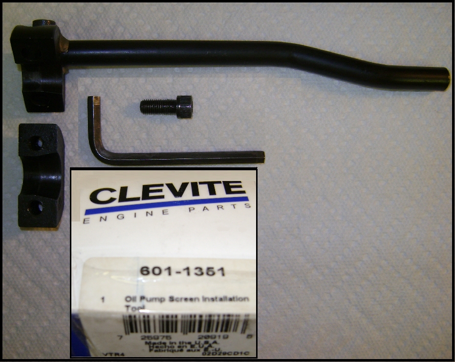

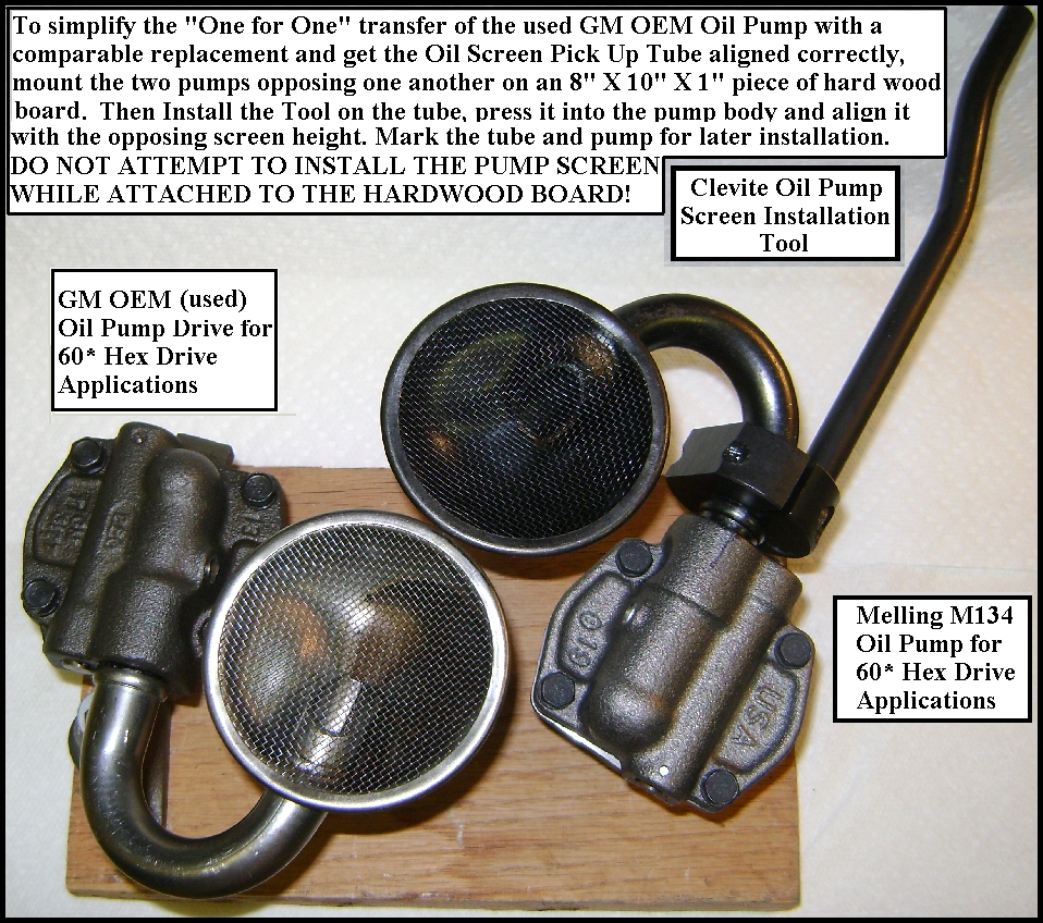

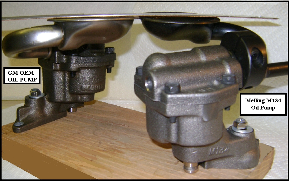

        Uh oh... ... I just remembered something.The Heavy Rust inside your crankcase...I started wondering whether you might also consider replacing the oil pump down there before you commit to a full-bore engine start. The replacement of the OEM GM oil pump and screen are not too much more money to pay for this added peace of mind. And since you don't know how much of that Thick Rust that was down there in direct contact with the weather... you can't really know if any of that rusty crap migrated up inside the pickup tube and on into the pump gears before you re-kindled your project to revive the motor. I mean...the central theme that started this thread was "...I can't get proper oil pressure..." So...What do you think of this idea?
        Just a suggestion, but... have a look at the attached images on a method I came up with that will speed up and simplify how to align and install a new pump screen, without the hassle involved with having to crawl back under the car and take pan depth measurements to guarantee the proper pump screen depth. This instructional video by George Richmond (The Melling Company) gives more information on the proper way it should be done:
