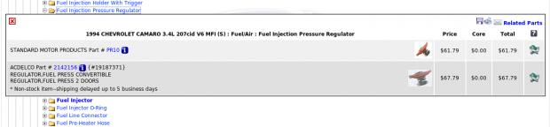

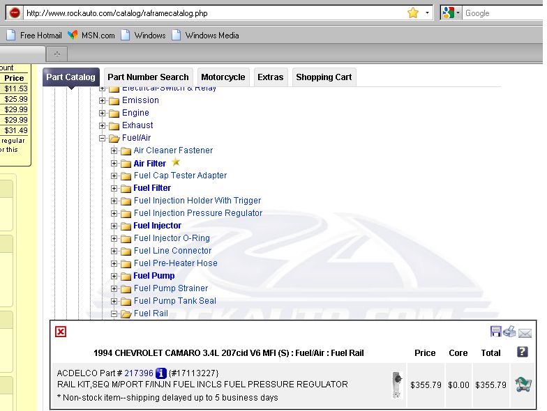

                    No need to be hyperbolic.... Why would I lie about a thing like that? See for yourself... (See Attached Image...)

                        Bob, that is for the entire fuel rail and regulator, not just the regulator. See attached of the exact same listing, only a little higher on the list...

                            That one (listed for the 3.4 Camaro - not sure why the pic is so small) is only $67 from Rock Auto.
